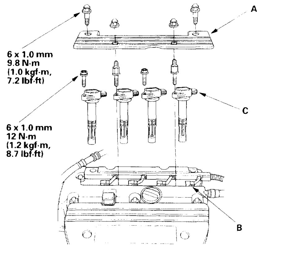

When I accelerate and it's on the 3rd gear precisely 60km, the engine shakes. I have replaced the spark plugs and the nozzles.

It is common for the ignition coils to go out, but I need to ask if you have run the codes to see if any are stored?
This guide can help:
Here is how to change the ignition coils out correctly. Check out the images (below). Please let us know what happens.
