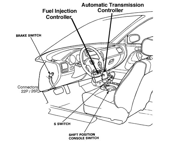

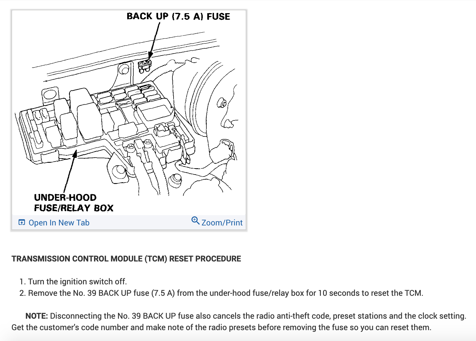

I got the car about a year ago and my D4 light as always stayed on but it was shifting gears before. I seen my TCU had a blown capacitor so I replaced it and my main relay but my transmission won't get out of second or third gear. Any tips to look would be fantastic! Also, there is a relay under my dash that keeps going off like a taser. I can't reach it to tell you what relay it is, but it isn't my main relay. It only happens when I start the car. Sometimes it will stop and others it will only happen in park.

Thank you Joe. Yes, all lights come on but D4 won't turn off no matter what gear I have selected. Nothing major changed when I replaced the TCU. It tried to shift once then never did anything since and I replaced it do to one of the capacitors taking out a few components out on the board and destroying traces. There is a hard to reach relay next to my vent close to my door that I would have to take my dash off to replace but it's really the only change. It sounds like a taser sometimes like if one of it's solder joints are bad on that relay. Most of the time it won't even do anything. It's very close to my main relay but it's label is facing the wrong way to see what it is. I just know it's that relay do to feeling it when it was acting like a taser.

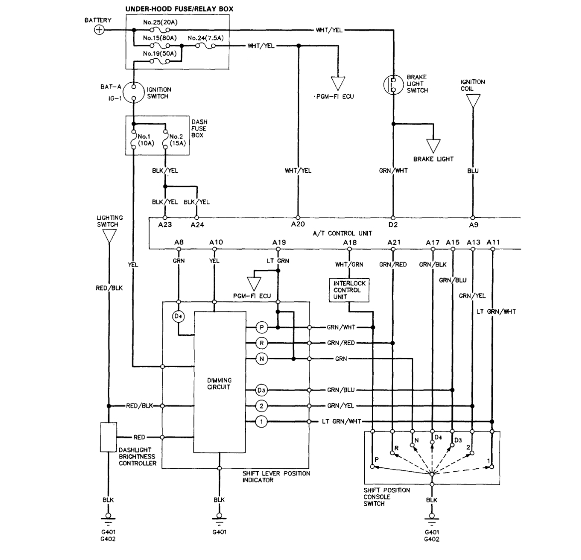

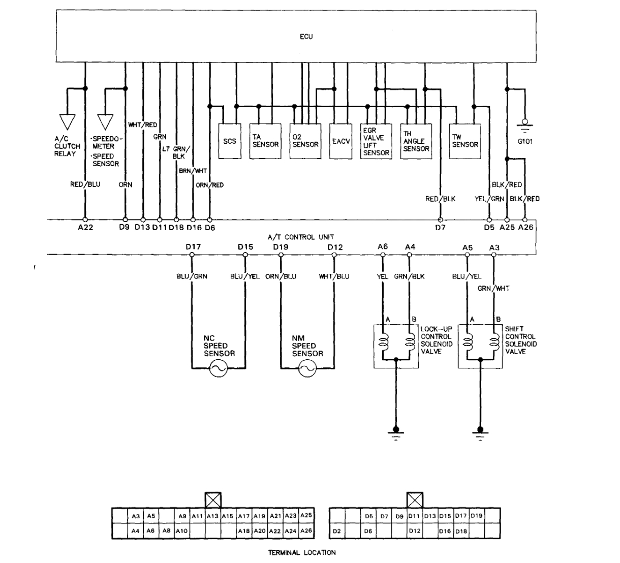

I will add the wiring diagrams and as much information as i can.
Regards, Joe

I will attach wiring diagrams for the transmission control below.
From what i can see the main relay is for the fuel injection control unit (PGM-FI) and not the A/T control unit.
If you have already replaced the TCU or are happy it is now good i would suspect a wiring issue or possibly a PCM related issue.
Regards, Joe

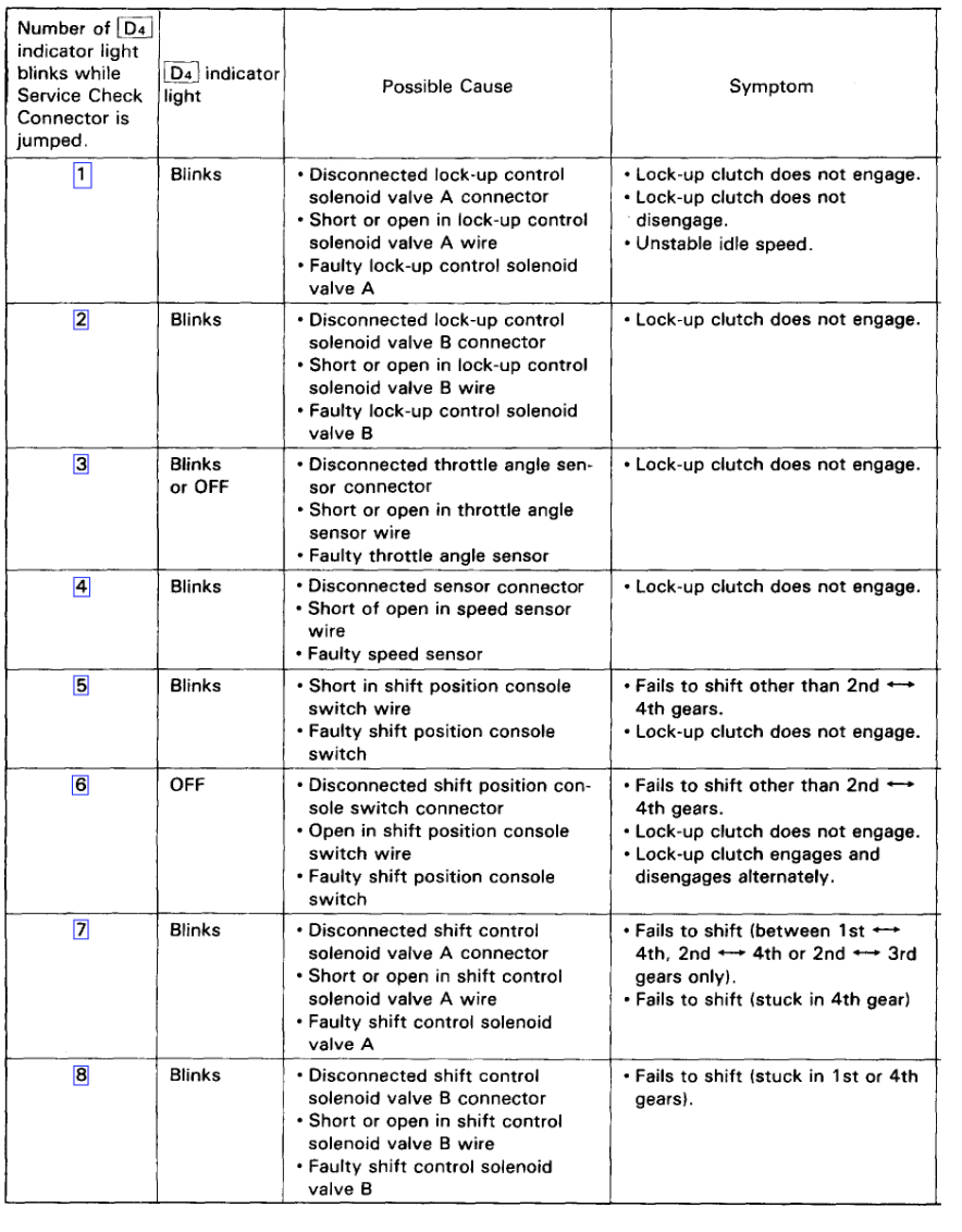

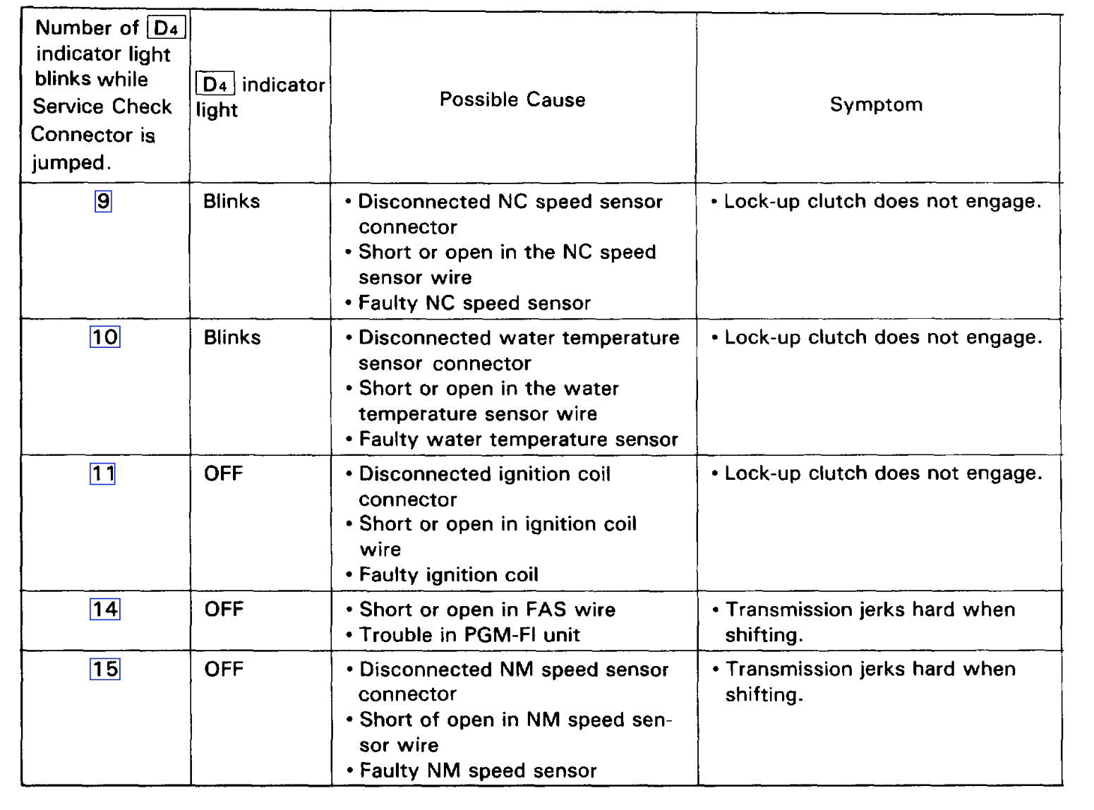

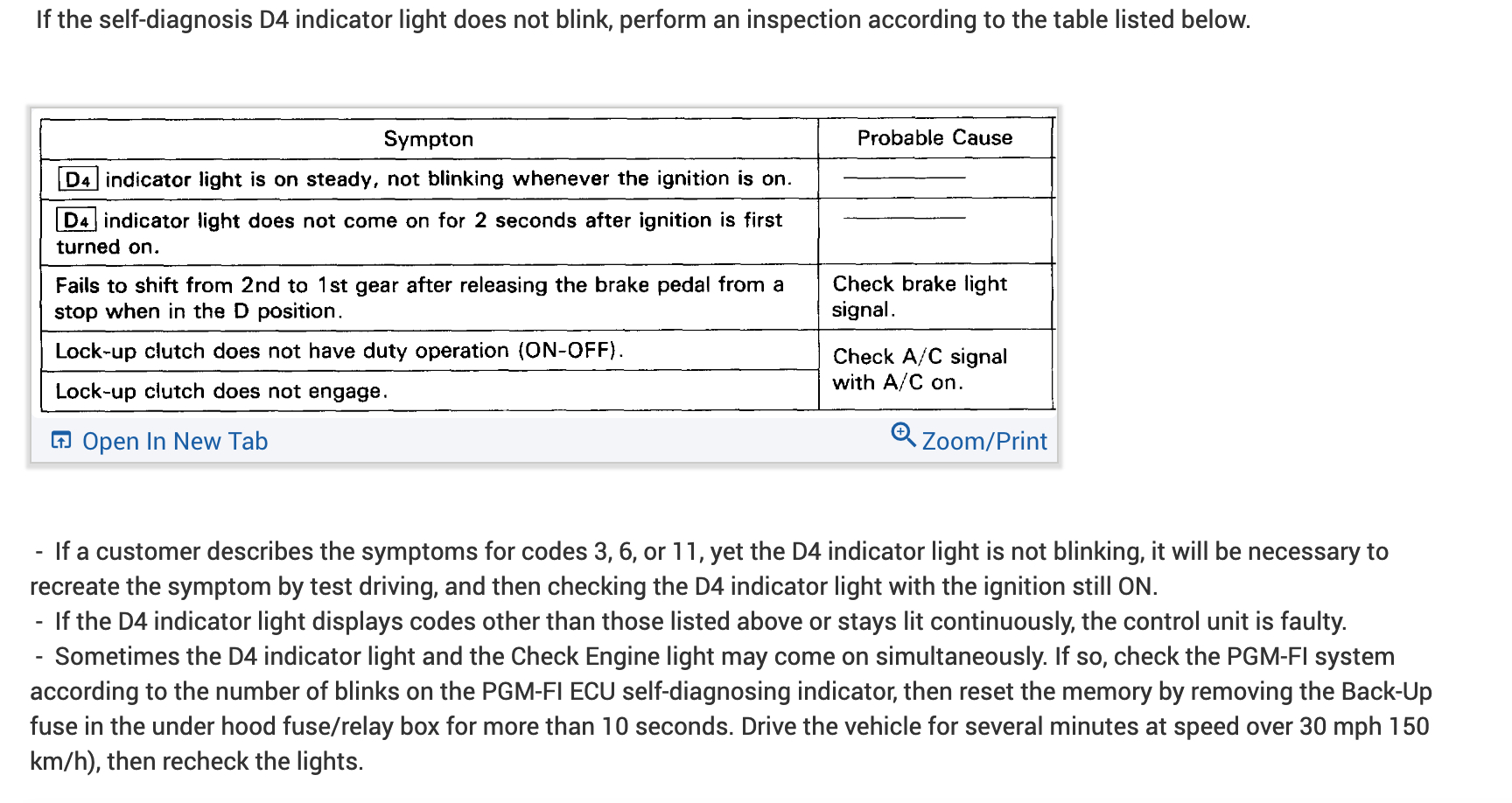

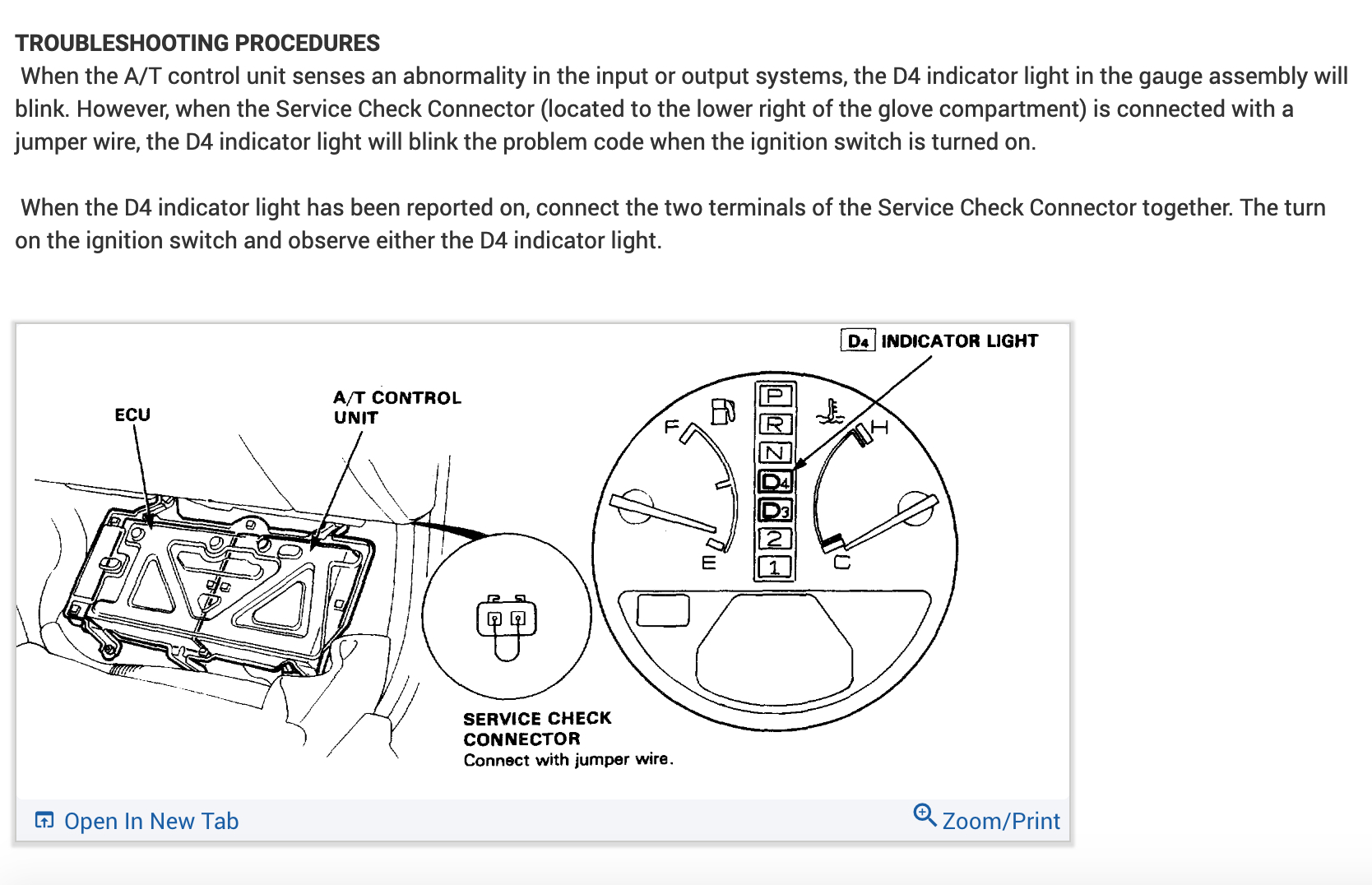

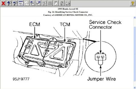

Also, below is a procedure for resetting the TCM and testing for TCM trouble codes.
If the D4 light will not give you trouble codes with the test connector jumped and stays lit it says in the last diagram to replace the TCM, you have already done this.
Is the check engine light on?
Regards, Joe

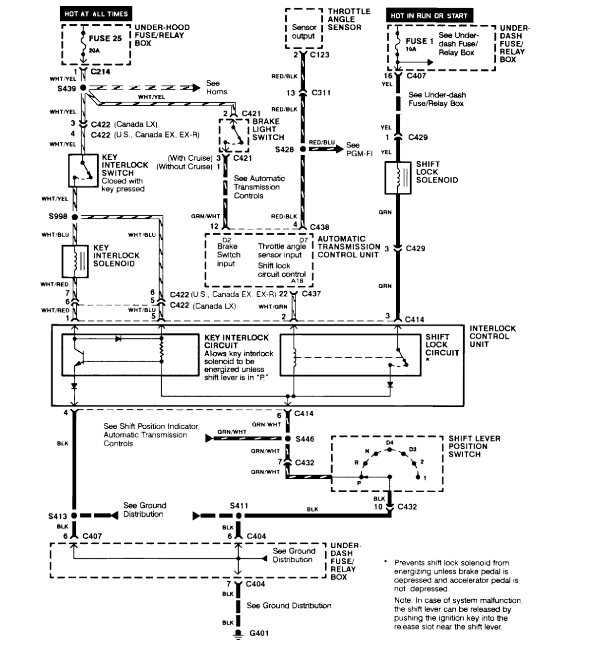

Hey ZACKERY LOOSER,

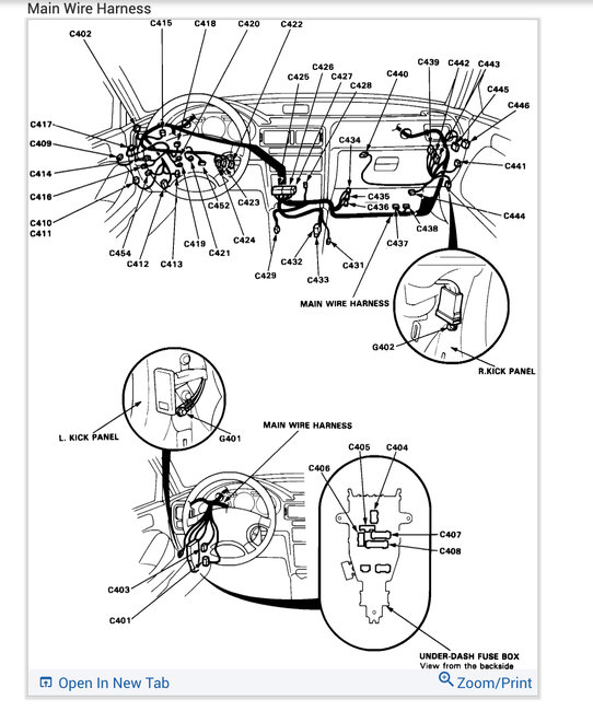

I have attached the wiring diagram for the interlock control you are talking about.
The interlock control unit controls the key interlock solenoid (stops you removing key unless you are in park) and the shift lock solenoid which stops you shifting out of park unless you have your foot on the brake.
The shift interlock is controlled by the TCU.

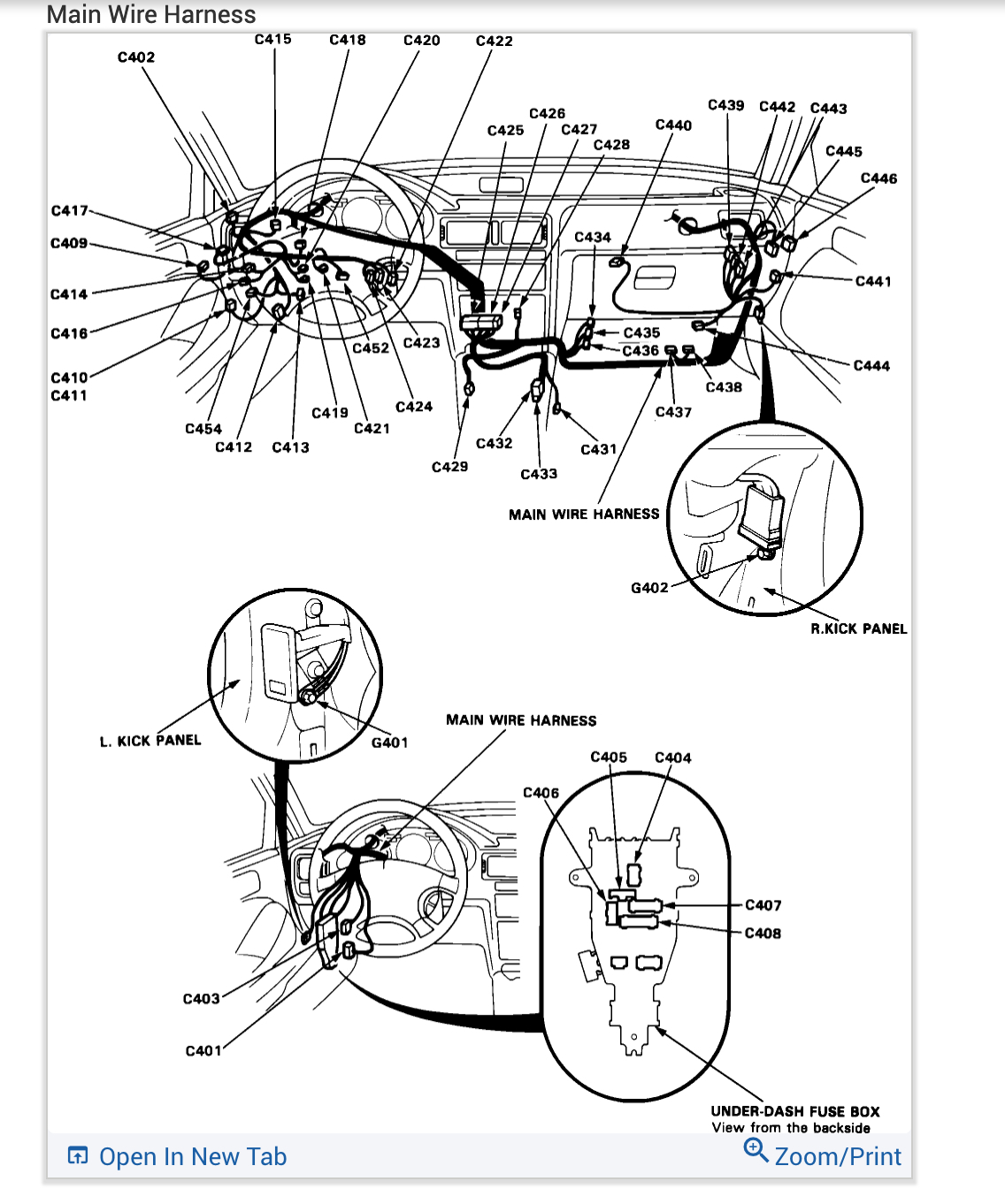

Having replaced the TCU i can only see that you have a power/ground issue or a PCM problem.
They both seem to ground at G401 and G402
I have attached a picture to this message.
Please check if the connections are clean and tight.
Regards, Joe

So, you're thinking I have a bad ground connection? Would explain a little of why it sometimes wants to work and others it does nothing. I'll check these two ground planes and let you guys know how it works out. At this point though, it's starting to get under my skin.

Hey ZACKERY LOOSER,
You do seem to have some interesting faults.
With these ground connections unbolt to inspect the condition and give them a good clean with sandpaper or a wire brush to ensure you have a good ground connection. You should have shiny bare metal both sides of the connection.
It is worth looking around the gas pedal to make sure there is not wiring be crushed and shorted by the pedal.
These faults could be linked or separate but ensuring you have good ground connections is a great place to start.
Regards, Joe

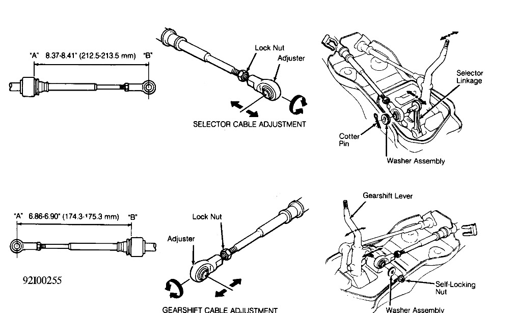

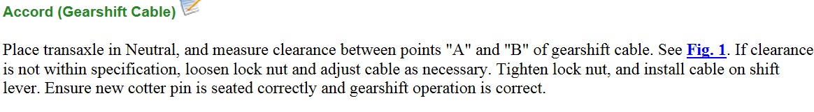

The car was shifting and running fine for months. It started becoming more and more difficult to shift until it eventually would not go into 1st, 3rd, or 5th. A friend and I replaced the clutch and throw out bearing, but it did not fix the problem. The car shifts easily into 2nd, 4th, and Reverse. However it will not shift into 5th, or 3rd at all. Any help would be appreciated.
Sep 26, 2020 at 11:52 AM (Merged)
HMAC300
  • CAR REPAIR CONTRIBUTOR
  • 48,601 POSTS
see pics it may be a bad cable disconnect the cable and see if it will shift into the gears you are having problems with if it won't then it may be a trans problem.

RHKILGOUR
There are no adjustments on the selector or gearshift cable
HMAC300
  • 48,601 POSTS
they sold be under the console so remove cables from trans and see if it will shift into 3rd an d5th if it does then it's cable/shifter problem like stretched or broken cables or shifters.

Hi kennyd42, When the D4 light shows and would not go off,the TCM is most likely to be faulty or there is some shorting of wire circuits. See if you can retrieve any Diagnostic Trouble Code by bridging the SCS connector.
https://images.2carpros.com/forum/automotive_pictures/192750_SCS93Accord_3.jpg
