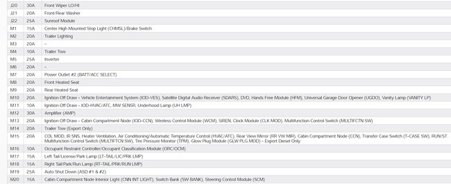

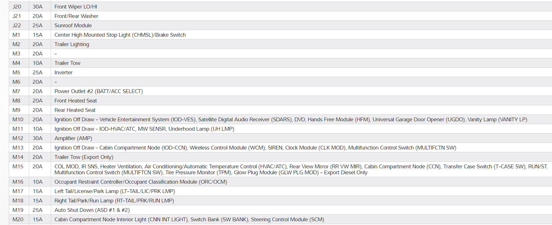

My van will not start, also my radio, turn signals, windshield wipers are also not working, but interior lights horn work. The dash is not working like it shows mileage but fuel gauge does not, move no dash lights come on and there is no clicking sound. My windows do not go down either but as stated earlier horn lights brakes etc work. Please help!
Sunday, July 23rd, 2017 AT 8:02 AM
KEN L
  • MASTER CERTIFIED MECHANIC
  • 55,281 POSTS

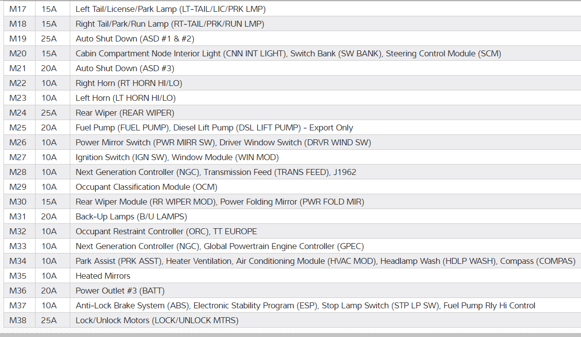

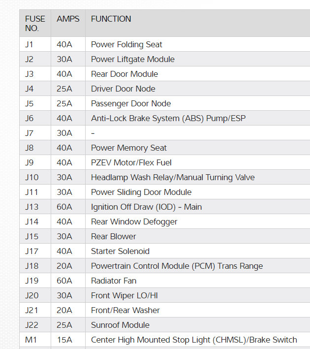

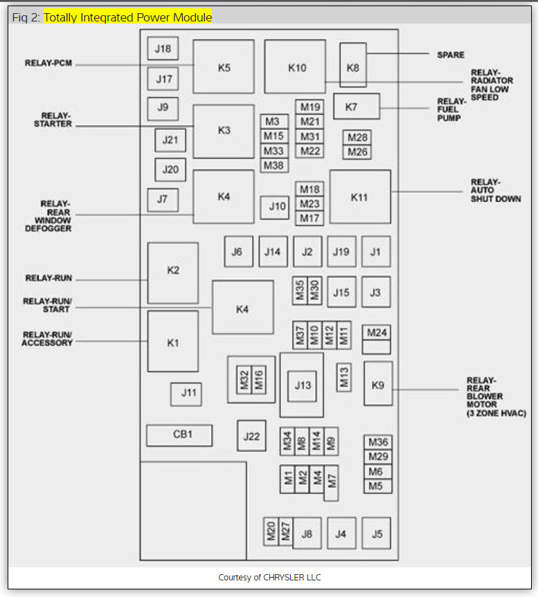

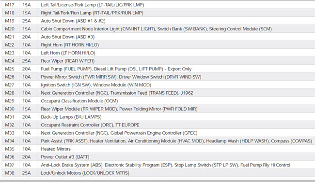

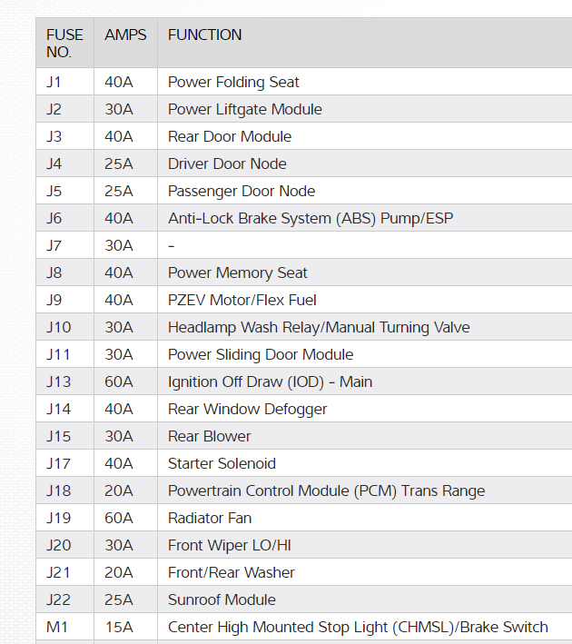

It sounds like you have a fuse that is blown which could have happened when the battery was replaced.
Here is a guide to help you with some fuse diagrams.
and
Please run some tests and get back to us we are interested to see what it is.
