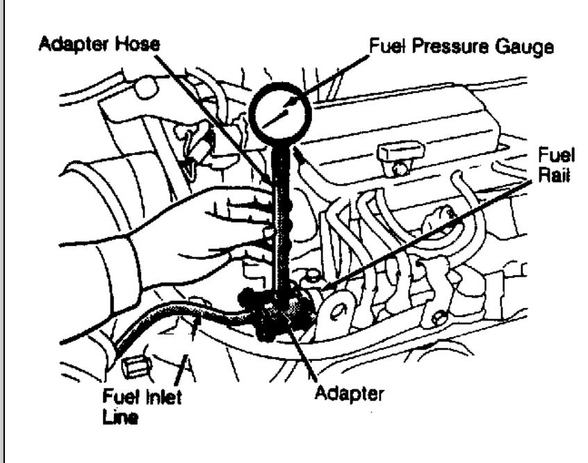

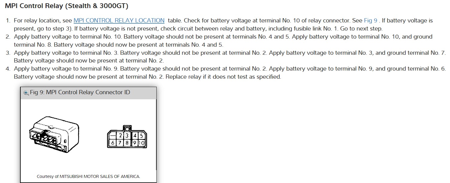

My car will start up but after 1 or 2 minutes it dies, I will have to let it set for a while then try to start it again and it will do the same thing
I have change out the battery, one coil pack, fuel pump, fuel filter, spark plugs and wires, I have change the oil to synthetic, please help

Check fuel pressure with a gauge auto parts rent it. Should be 34 with vacuum connected 43-45 without should not decrease for 2 minutes after engine shutoff. Also test mpi relay see pics.
