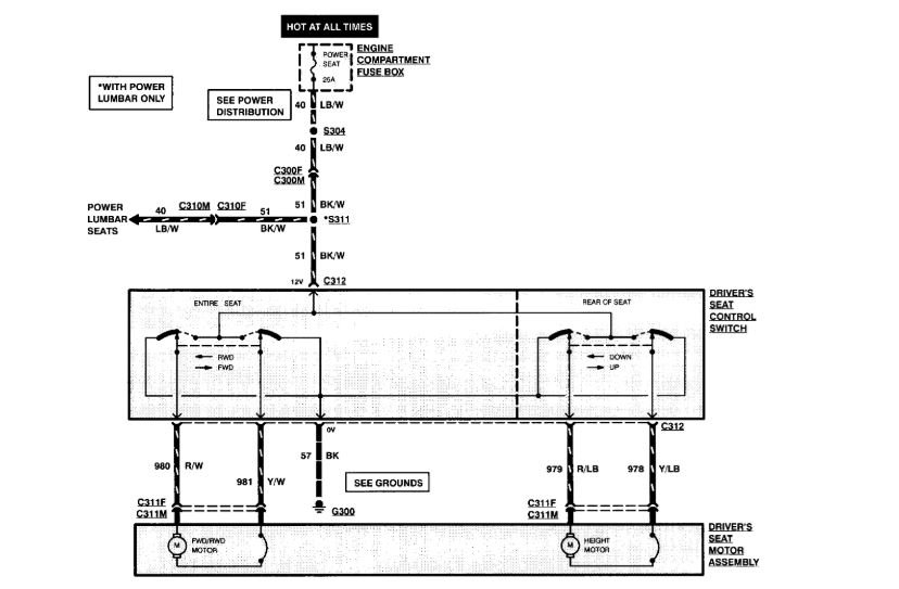

Electric driver seat goes up and down, forward "but not back". Can it be bypassed?
Tuesday, October 9th, 2018 AT 3:15 PM
14 Replies
Good evening.
You can try but you may damage the internals of the switch assembly.
I attached a wire diagram of the seat circuit for you to view.

As long as I can go backwards that is okay, thanks for diagram.

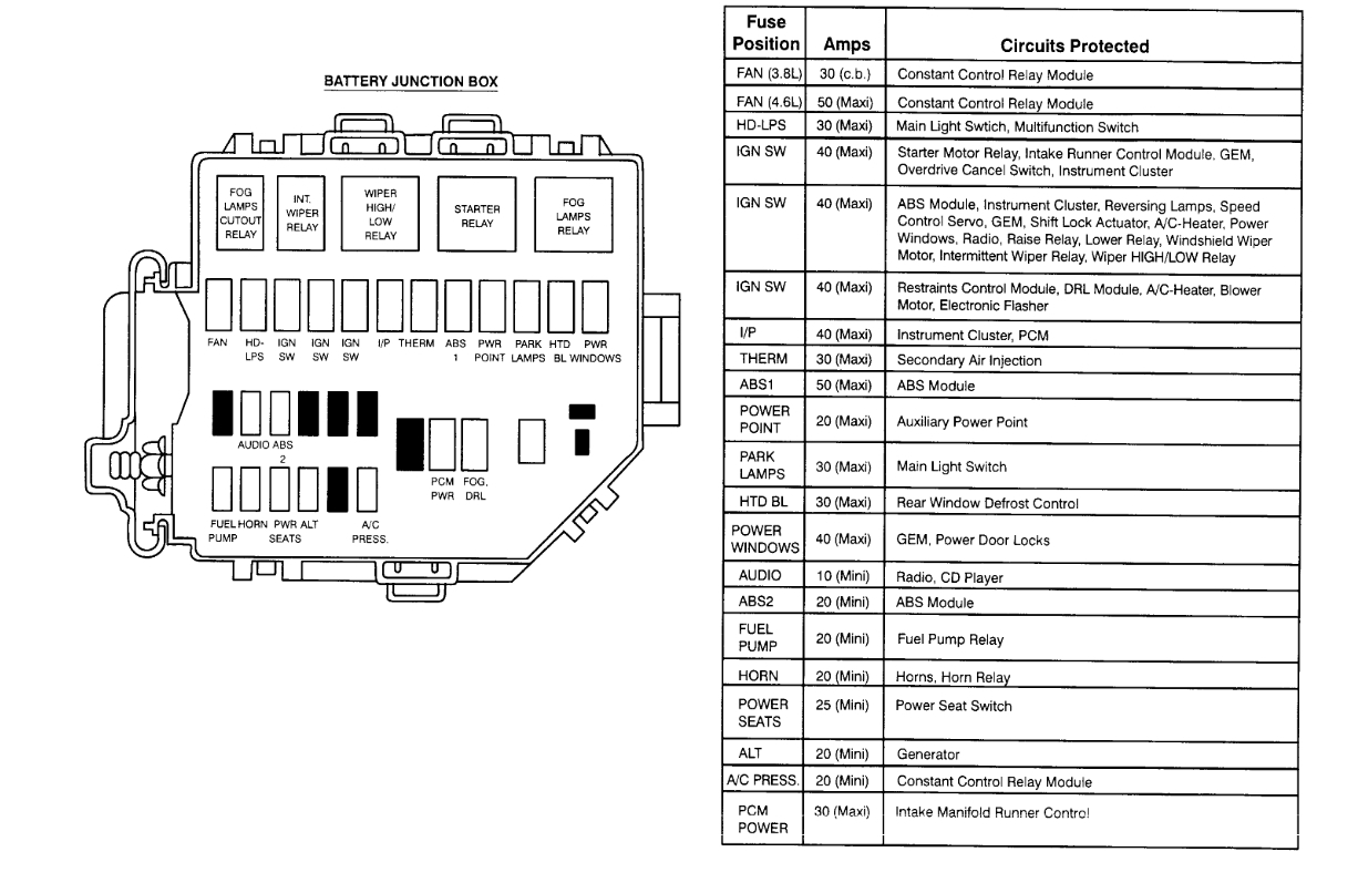

I can not get my driver side electric seat to move back and forward. Would it be the electric motor, tracking or a fuse or relay and where are the fuse or relay located on 1995 ford mustang
Tuesday, July 21st, 2020 AT 5:23 PM (Merged)
KOOLDUDE0788
  • 8 POSTS
I had the same problem on my 95. First check the fuse (Under the hood *Power distributer box*) then lube everything that moves under there. If its still doesn't work its a small plastic gear that is broken. Some genius decided to use really cheap plastic gear thats smaller then a penny to move a 130 lbs + person. Mine would just tweak left and right so the best thing to do is just go to a junk yard and replace the bottom.

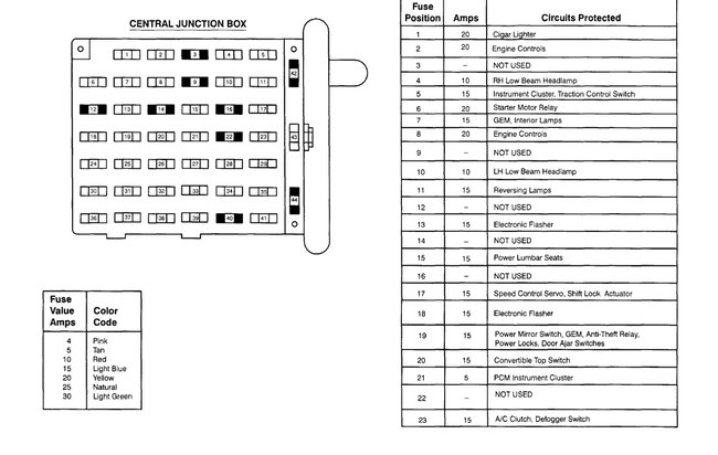

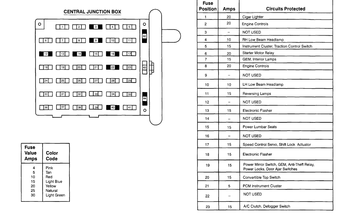

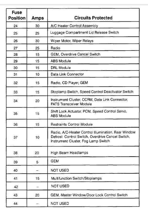

Power seat not working and cannot locate the fuse for it?
MUSTANGMONKEYMOBILE
Here is the fuse panel for your car with a guide to help test it.
