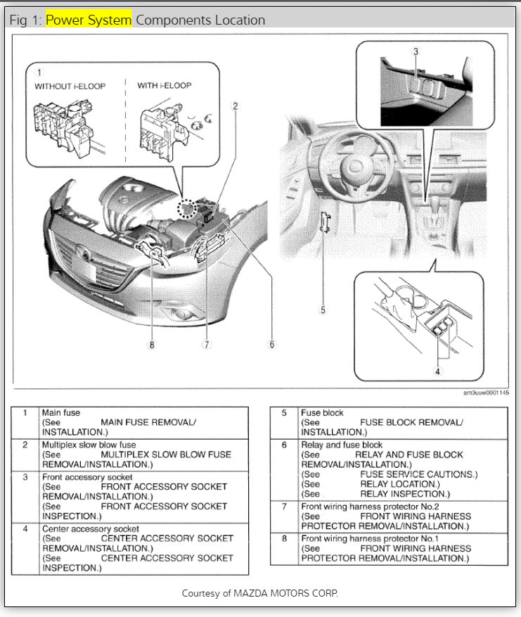

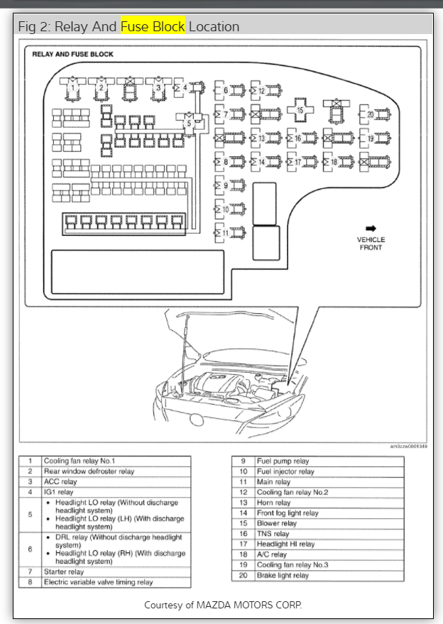

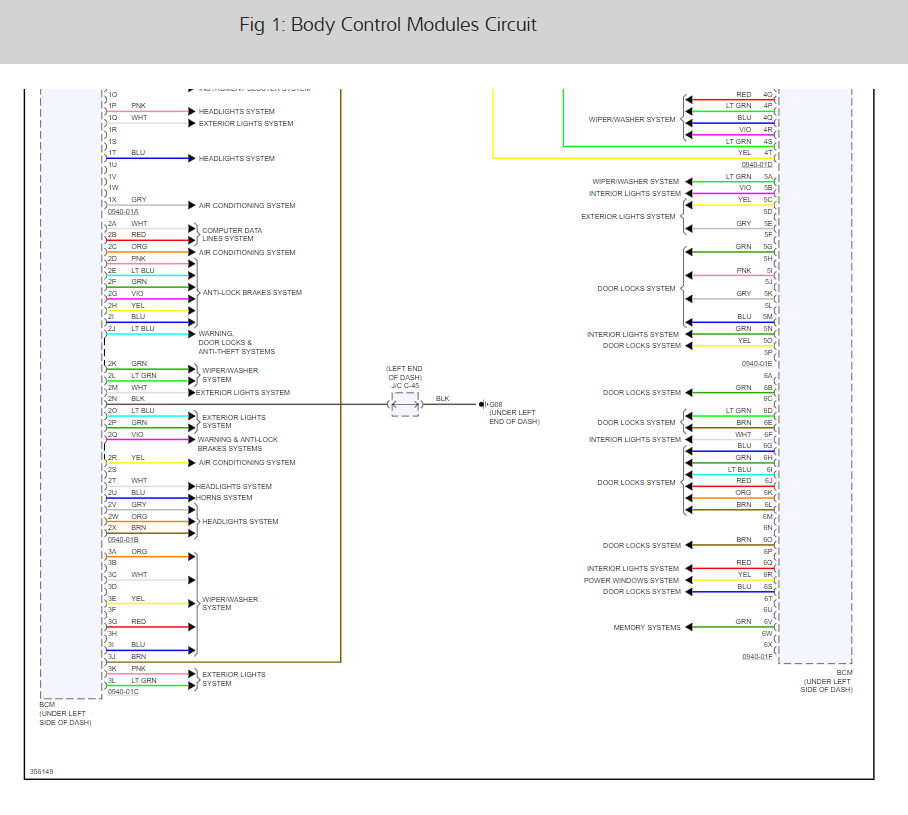

It sounds like you had a voltage surge due to the amp and blew out fuses. lets start by using this guide and checking the fuses for power the fuse locations are blow.
Check out the diagrams (below). Please let us know what you find.
Saturday, July 27th, 2019 AT 12:48 PM

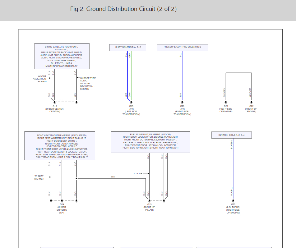

I already tested all fuses from the engine bay and interior side panel with a multi-meter, all of them are fine. I went ahead and tried to remove plugs from the BCM (body control module) and tested the grounds. All ground wire going the the BCM works. Excepts:
- Steering angle sensor ground
- Ambient temperature ground
Both systems are not working, so I guess it’s a loose ground from the bass somewhere. I looked up 4 different grounds near the BCM but all of them all correctly connected and when tested with a multi-meter they all show small resistance.
I don’t really know how to find the ground that as a problem since there are a bunch of them all around the car.
Update:
I just tested the ground wire from the hazard light button, there is quite a lot of resistance from the ground cable of the button to the chassis.

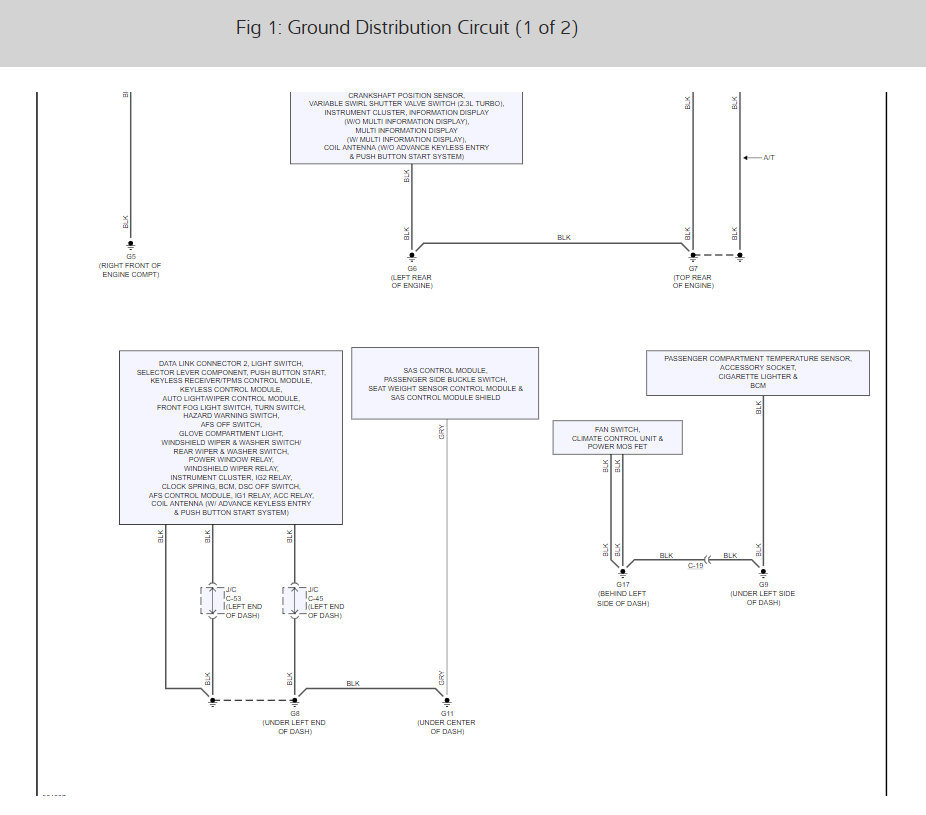

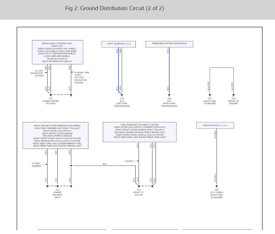

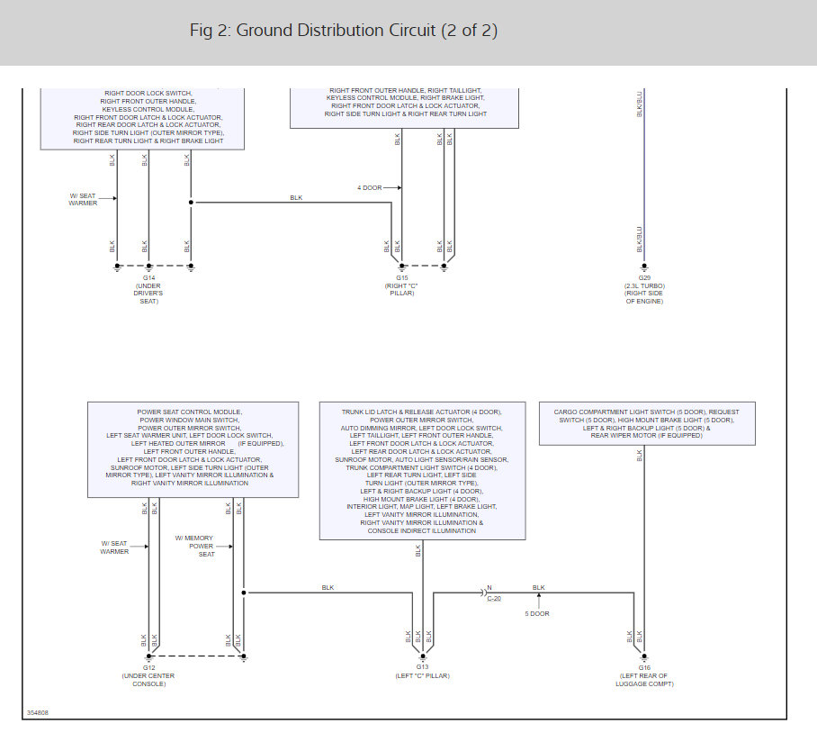

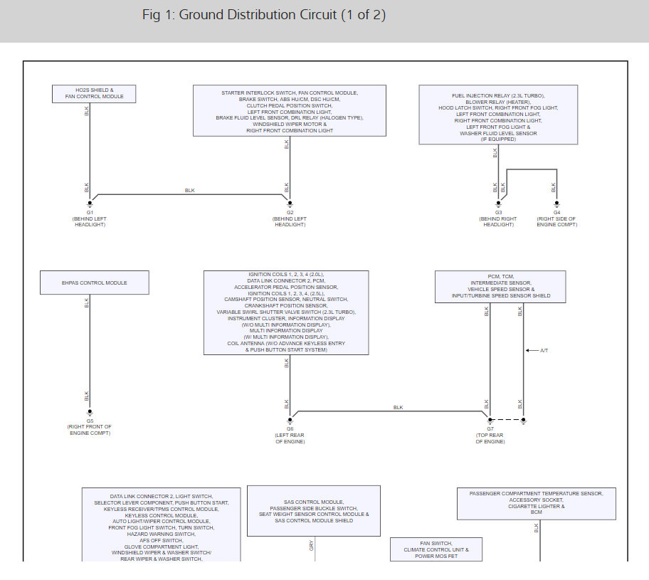

Okay, cool thanks. here is the ground distribution wiring diagrams so you can test them and it give the locations of the grounds as well:
+1
Sunday, July 28th, 2019 AT 11:45 AM

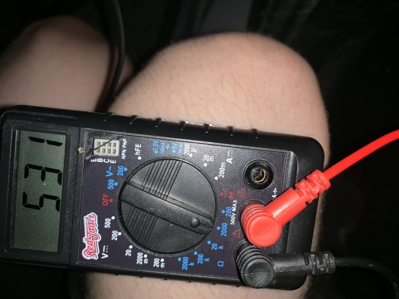

I just tested most grounds related to the problem, all of them are correct. I did another test, I tried to test the resistance in the hazard switch, to see if ground was getting there. There is a resistance but a pretty big one. After that I tried to put a wire into the ambiant air temperature sensor ground wire on the bcm, while the connector was plugged to see if ground goes threw. It does but with a big resistance as shown in the picture, all my test were going back on a working body ground. Here is a picture of the multimeter.
I’m starting to think that it is a bcm malfunction. But I want to be sure before ordering another one.
Thanks for your help! Very appreciate it!
Sunday, July 28th, 2019 AT 7:32 PM

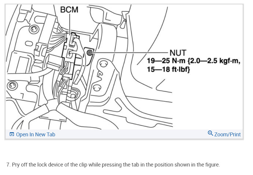

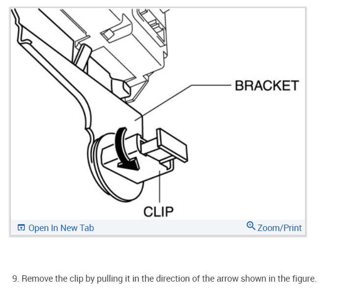

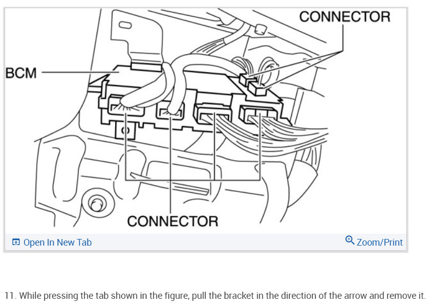

Yep, I was thinking the same thing. to be sure we can do a CAN scan here is a video:
https://youtu.be/InIlnsjOVFA

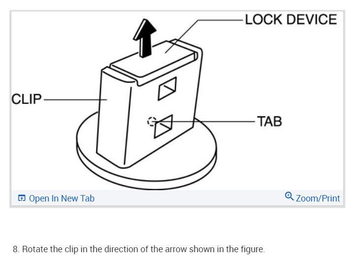

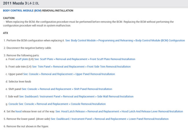

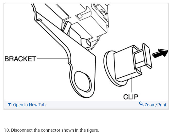

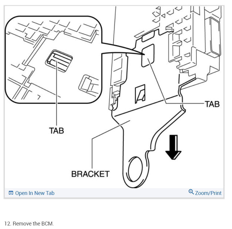

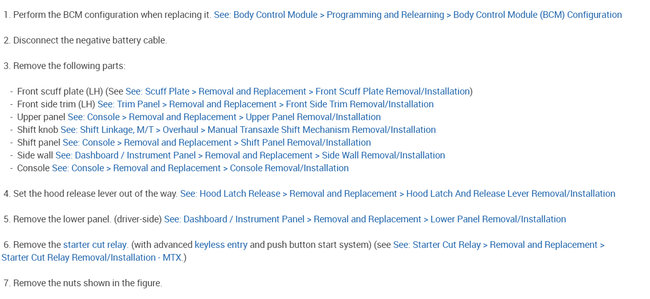

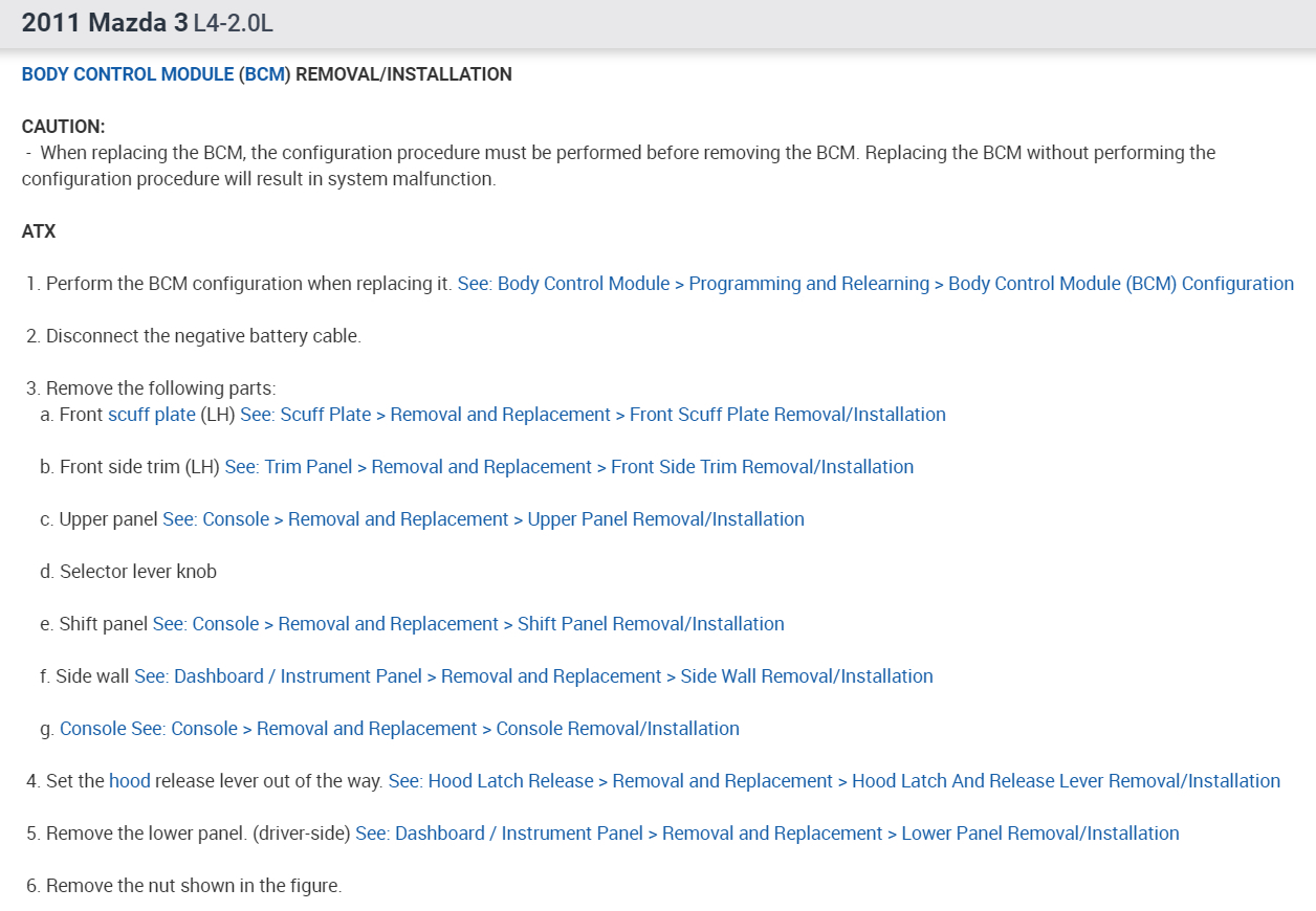

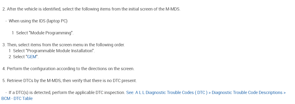

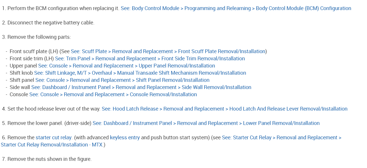

Here are the instructions and locations of the BCM so you can replace it. Check out the diagrams (below). Please let us know what you find.
Monday, July 29th, 2019 AT 10:09 AM

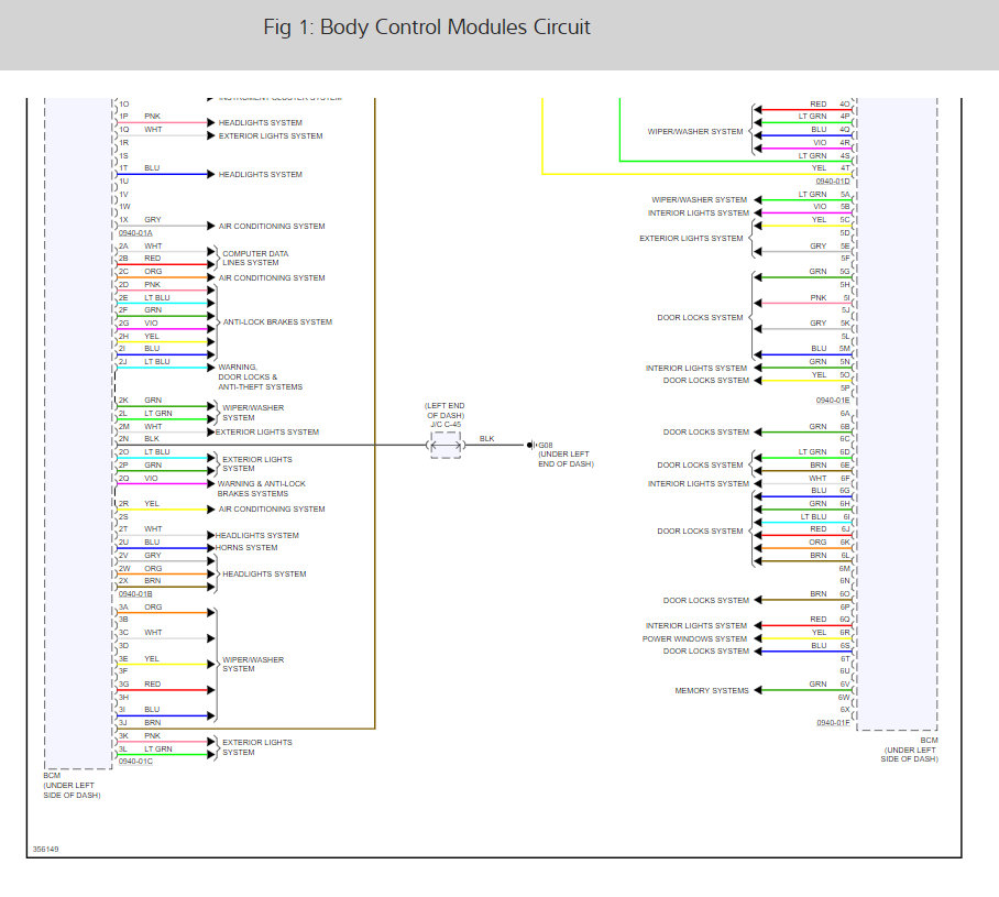

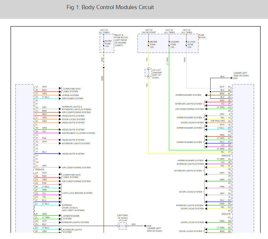

Yes, it could be that's why the CAN scan is such a good thing. Here are the wiring diagrams for the BCM so you can see how it works while testing the powers (fuses) and grounds. Check out the diagrams (below). Please run this test and get back to us.

Thanks, what are the j/c c-XX in the diagrams?
Wednesday, July 31st, 2019 AT 1:01 AM
KEN L
  • MASTER CERTIFIED MECHANIC
  • 55,488 POSTS
JC is junction connector, and CXX connector - number

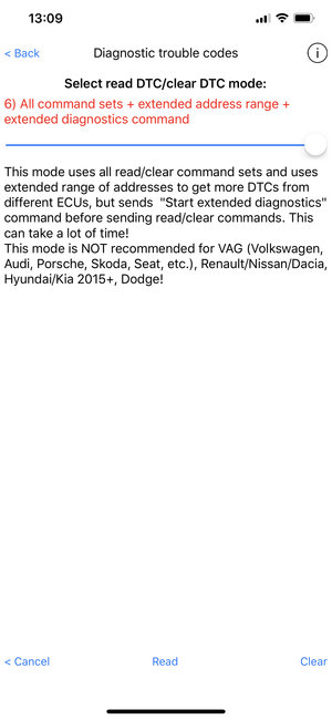

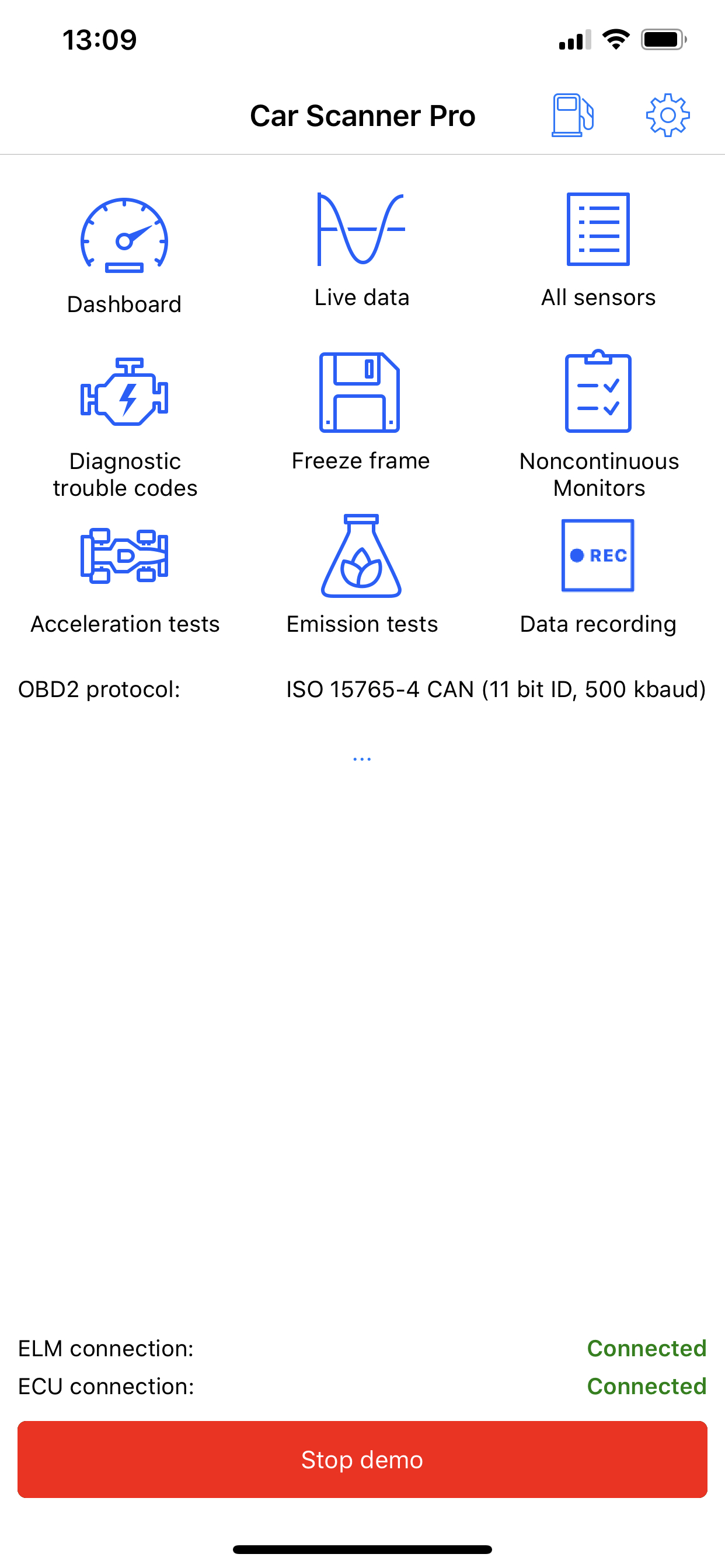

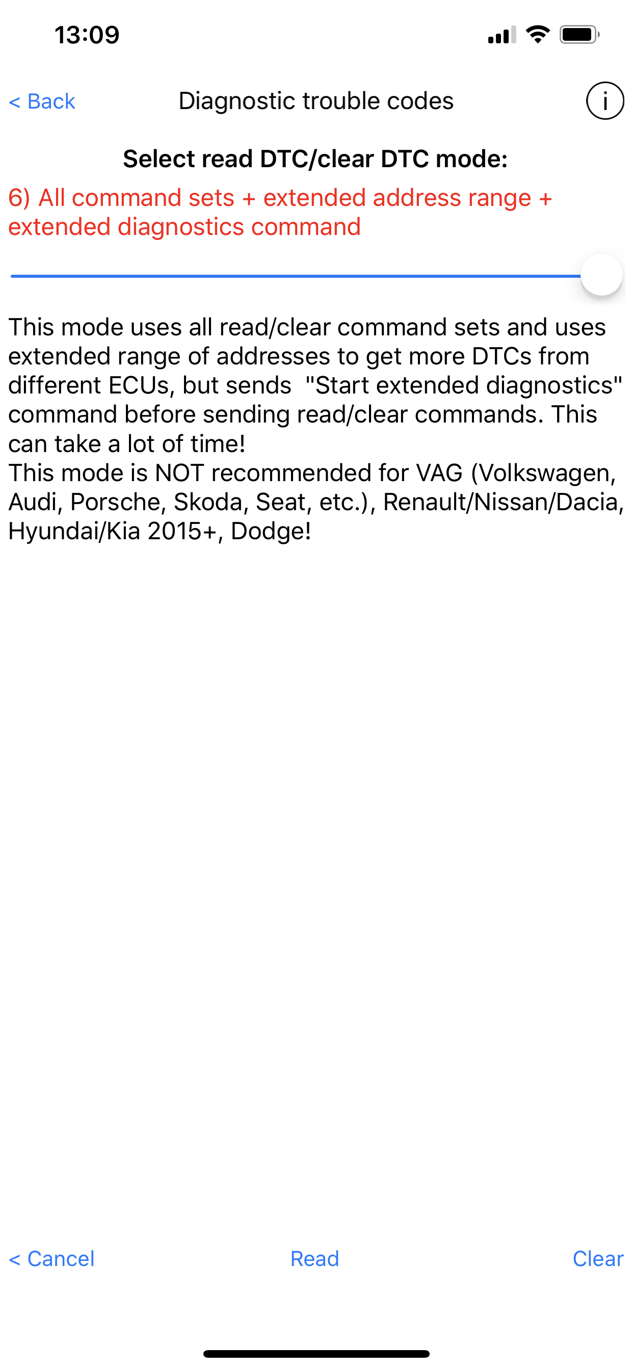

Do I need to go to a mechanic to do a can scan or I can do it with my scan tool? Here is some pictures of the app am using and the capability of it.
Thursday, August 22nd, 2019 AT 10:10 AM
KEN L
  • 55,488 POSTS
That is for PCM only, the CAN scanner looks like this for 59.00 on Amazon:

CEDMAC
  • 12 POSTS
Just went to the junk yard and picked up a BCM. Solved all problems except rear trunk open button and rear wiper, but it’s probably due to the used BCM being in a sedan. Thanks for all your help!
