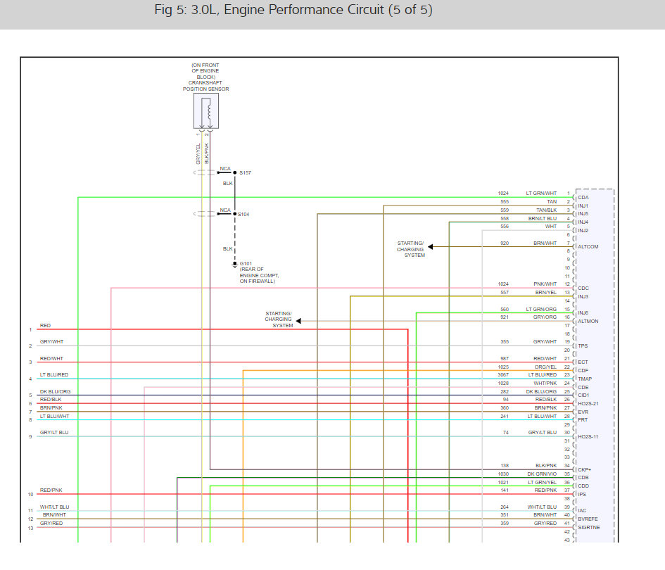

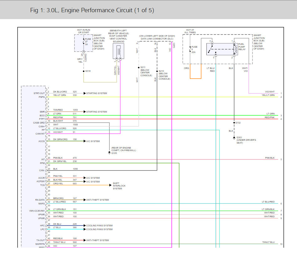

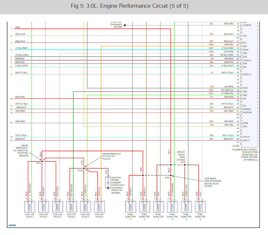

With key on (not running):
Test light connected negative battery terminal to solid red wire on coil connector = light on.
Test light connected to positive battery terminal to orange/yellow wire on coil connector = test light on . Ran the same test on coil # 5 = no light on light green/yellow wire .

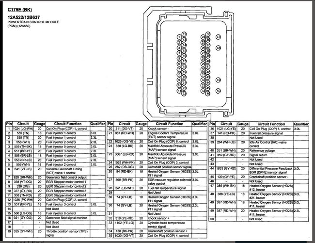

My PCM is a 3 connector type , I would appreciate some help with the proper wiring color/punch out diagram for isolating further this apparent short to ground.
Your assistance is greatly appreciated.
Sincerely, Ian
Sep 2, 2019 at 2:50 PM
  • 54,144 POSTS

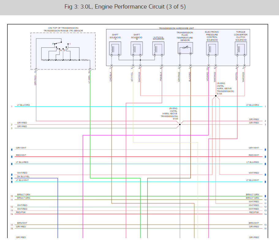

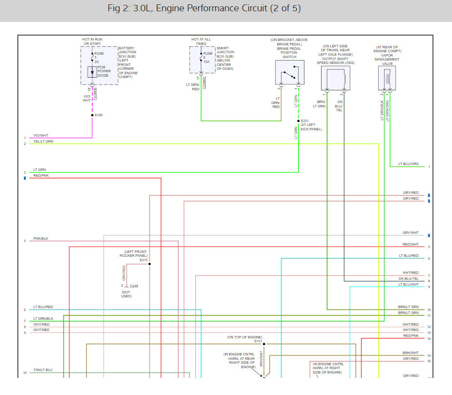

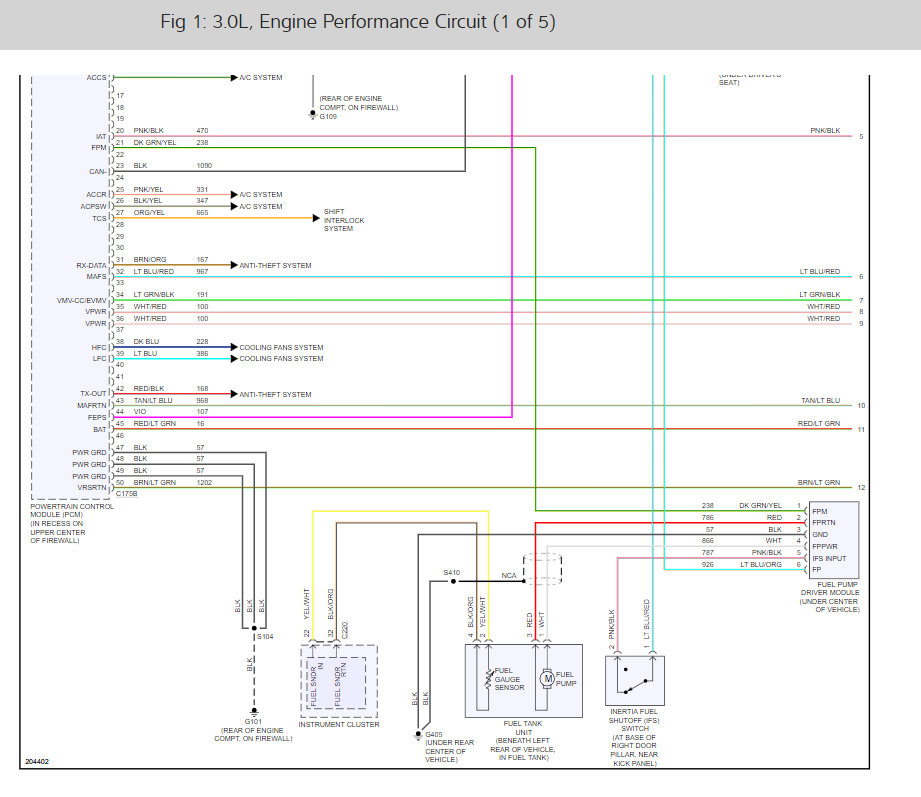

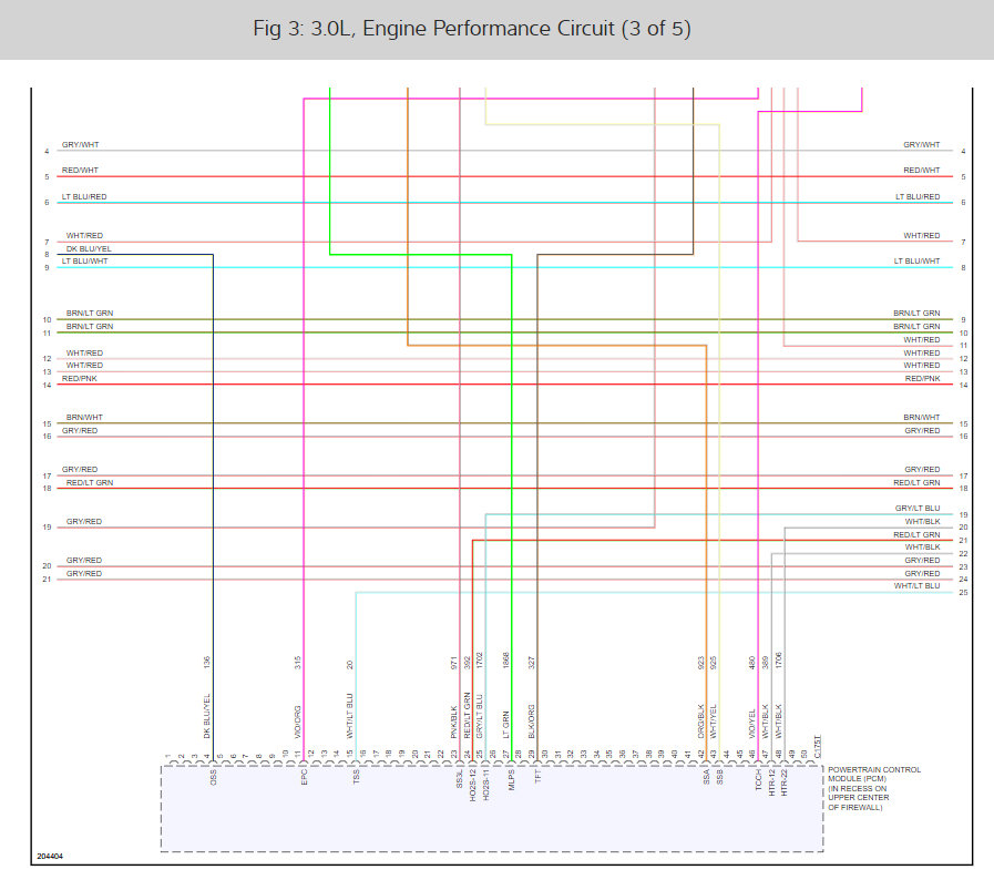

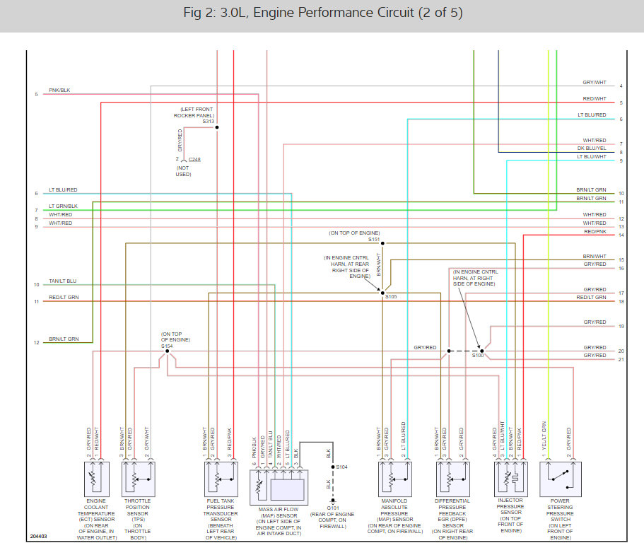

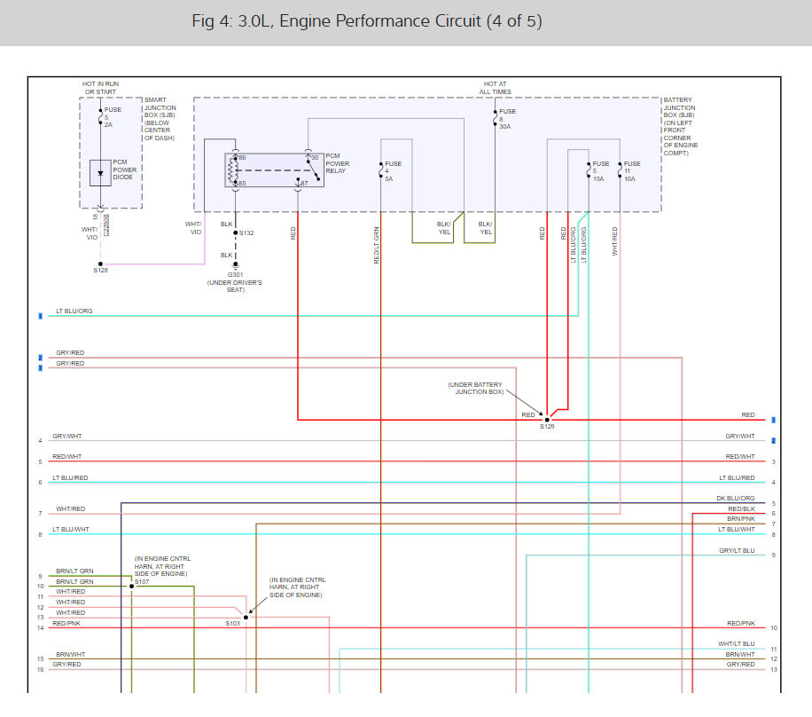

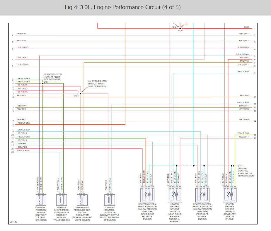

Here is a good guide on how to check the wiring with the engine wiring diagrams below so you can see how the system works and which injector wires to test:
Check out the diagrams (below). Please let us know what happens. Can you please shoot a quick video with your phone so we can see what's going on, that would be great. You can upload it here with your response.
Sep 3, 2019 at 6:47 PM
IAN55
  • 6 POSTS
Ken, thank you very much for the quick response and schematics . Although (diagrams 4 and 5) show this a single PCM connector, I needed the (Red coil wire diagram)(thank you for that ). Interesting during my research using 2carPros I found a previous thread for a 2005 Escape diagram. request providing the attached pinout on a 3 connector type PCM. (fyi attached ).
I did resolve my issue on #6coil / #22 pos. PCM. I ran a new wire: (in sep. loom spliced/soldered/heat shrink at both ends of connectors.) (i know not prof. protocol) but we are back up and running .

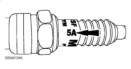

WARRANTY INFORMATION WARRANTY STATUS: Eligible Under Provisions Of New Vehicle Limited Warranty Coverage And Emissions Warranty Coverage. IMPORTANT:Warranty coverage limits/policies are not altered by a TSB. Warranty coverage limits are determined by the identified causal part.. 3.0L ENGINE MIL ON WITH DTCS P0351 THROUGH P0356 - MULTIPLE COIL PRIMARY CIRCUIT TECHNICAL SERVICE BULLETIN Reference Number(s): 09-2-6, Date of Issue: February 9, 2009 FORD:2005-2006 Escape MERCURY:2005-2006 Mariner Superceded Bulletin(s): 05-11-1, Date of Issue: June 13, 2005 Related Ref Number(s): 05-11-1, 09-2-6 ARTICLE BEGINNING ISSUE NOTE:This article supersedes TSB 05-11-1 to update the Service Procedure and Part List. Some 2005-2006 Escape/Mariner vehicles equipped with a 3.0L engine, may exhibit a malfunction indicator lamp (MIL) on with two or more diagnostic trouble codes (DTCs) for coil on plug (COP) primary circuit faults (P0351 through P0356). This may be due to the spark plugs causing RF interference with the powertrain control module (PCM), resulting in damage to the PCM and COPs. ACTION Refer to the following Service Procedure to correct the condition. SERVICE PROCEDURE Connect the Ford Integrated Diagnostic System (IDS) service tool to the data link connector (DLC). Identify the vehicle and perform a key on engine running (KOER) test. If only one (1) coil circuit primary DTC (P035x) is present, follow Procedure A. If there are two (2) or more coil circuit primary DTCs (P035x-P035x), follow Procedure B. PROCEDURE A Remove any spark plug and inspect for a 2-digit date code (Fig. 1). If the date code is not present, replace all six (6) spark plugs. Continue with normal Powertrain Controls/Emissions Diagnosis (PC/ED) diagnostics for the DTC. Fig. 1: Date Code On Spark Plug
https://images.2carpros.com/forum/automotive_pictures/99387_Graphic1_526.jpg
PROCEDURE B Remove any spark plug and inspect for a 2-digit date code (Fig. 1). If the date code is not present, replace all six (6) spark plugs. Replace all six (6) COPs. Check PCM internal coil driver functionality by running the Oscilloscope Escape PCM Driver Test available on IDS version B58 or later. Using IDS select Toolbox. Oscilloscope tools. Escape PCM Driver Test - follow on screen instructions. NOTE:THE OSCILLOSCOPE TEST TO CHECK PCM INTERNAL COIL DRIVER FUNCTIONALITY MUST BE PERFORMED PRIOR TO REPLACING THE PCM. Replace PCM only if coil driver funcionality fails in the oscilloscope test. Program the passive anti-theft system (PATS) keys if PCM is replaced. If the procedure has not corrected the condition, follow normal PC/ED diagnostics for DTC.
