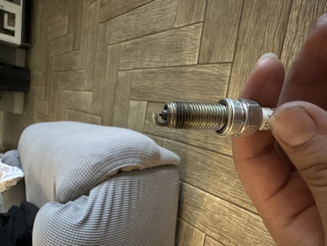

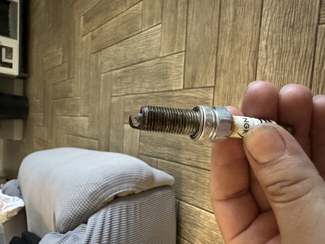

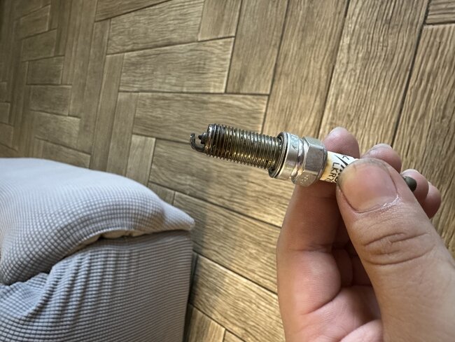

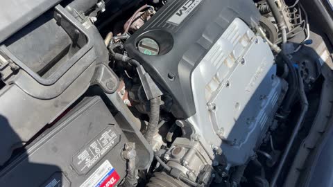

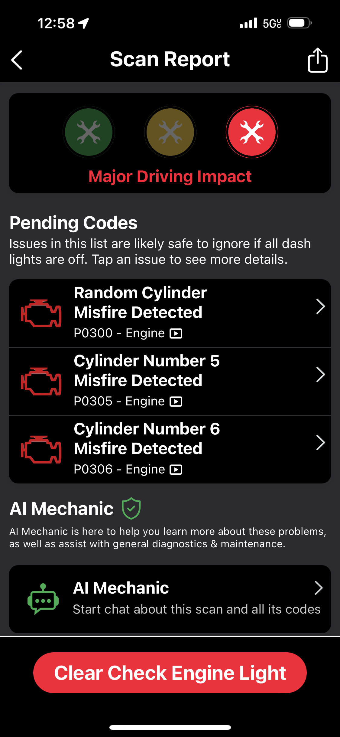

As I was driving home today and parked somewhere, I noticed that my car started slightly vibrating then later the check engine light started blinking. I scanned it for codes and these 3-cylinder misfires came up. I decided to swap all of my spark plugs with brand new NGK ones and I continue to have the same issue with the same codes after scanning again. I posted a few spark plugs that I removed that had some major wear, the others did not seem too bad.

This is a video I took of the engine while running after replacing the spark plugs, you may not notice it too much on video, but it is vibrating more than normal. It was also doing this before I replaced them when the check engine light originally flashed.

Thanks for the images and video. Yes, I can tell there is a slight vibration. Did you clear the codes and if so, did they come back? You may have an intake valve that is leaking slightly. We can do a compression test to confirm the issue,

I think we can rule the ignition coils off, I replaced all of them with a brand-new set. Started the car, and it is still vibrating with the check engine light flashing. However, this time it is only showing one check engine code: P0306 (Cylinder 6). So, I went ahead and cleared the check engine, swapped the coil on cylinder 6 with another and still have the same issue. So, after installing brand new spark plugs and ignition coils, I still have a misfire. I called my mechanic, and he will be checking it today, he will be doing the compression test you mentioned.

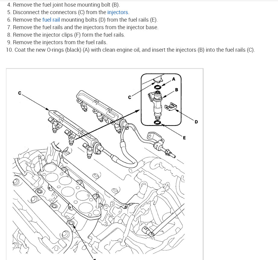

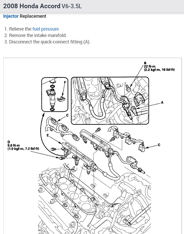

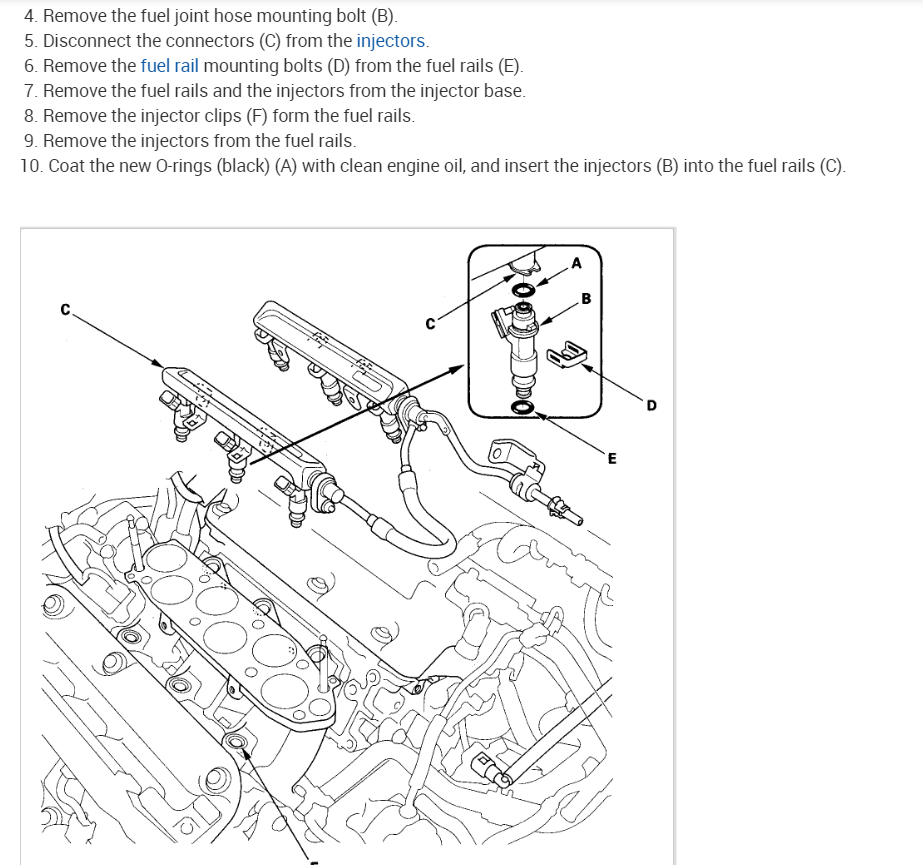

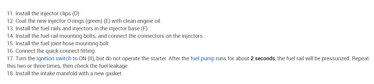

Sounds good, if the compression is good you will need to replace the fuel injector, which is why I wanted you to remove the spark plug and see if there is no fuel being burnt due to a clogged fuel injector. Check out the images (below). Please let us know how it goes.

Yep, sounds about right, you can save money if you do the work yourself, please check out the instructions above to see if it is something you want to do.

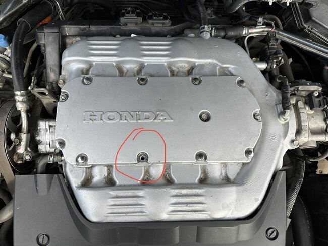

So yesterday I went ahead and cleared the check engine light and let the car run a bit, the RPM is at normal level (between 500 and 1,000) and the engine is not vibrating like it was those last few times and after running the car for a bit, the check engine has not returned. One thing I just realized this morning though is that one of the head bolts is missing. Could this be causing an issue?

Yep, that can cause a vacuum leak, the fact that you are getting the run around and the car is still not fixed I would try another shop or give them one last chance to fix it. Ask the shop to have their top mechanic do the repairs and to use factory parts. Also, you can request them to give you the old parts back in the replacement part box to ensure they did in fact use factor parts. If they did a compression test it would be nice to get the readings.

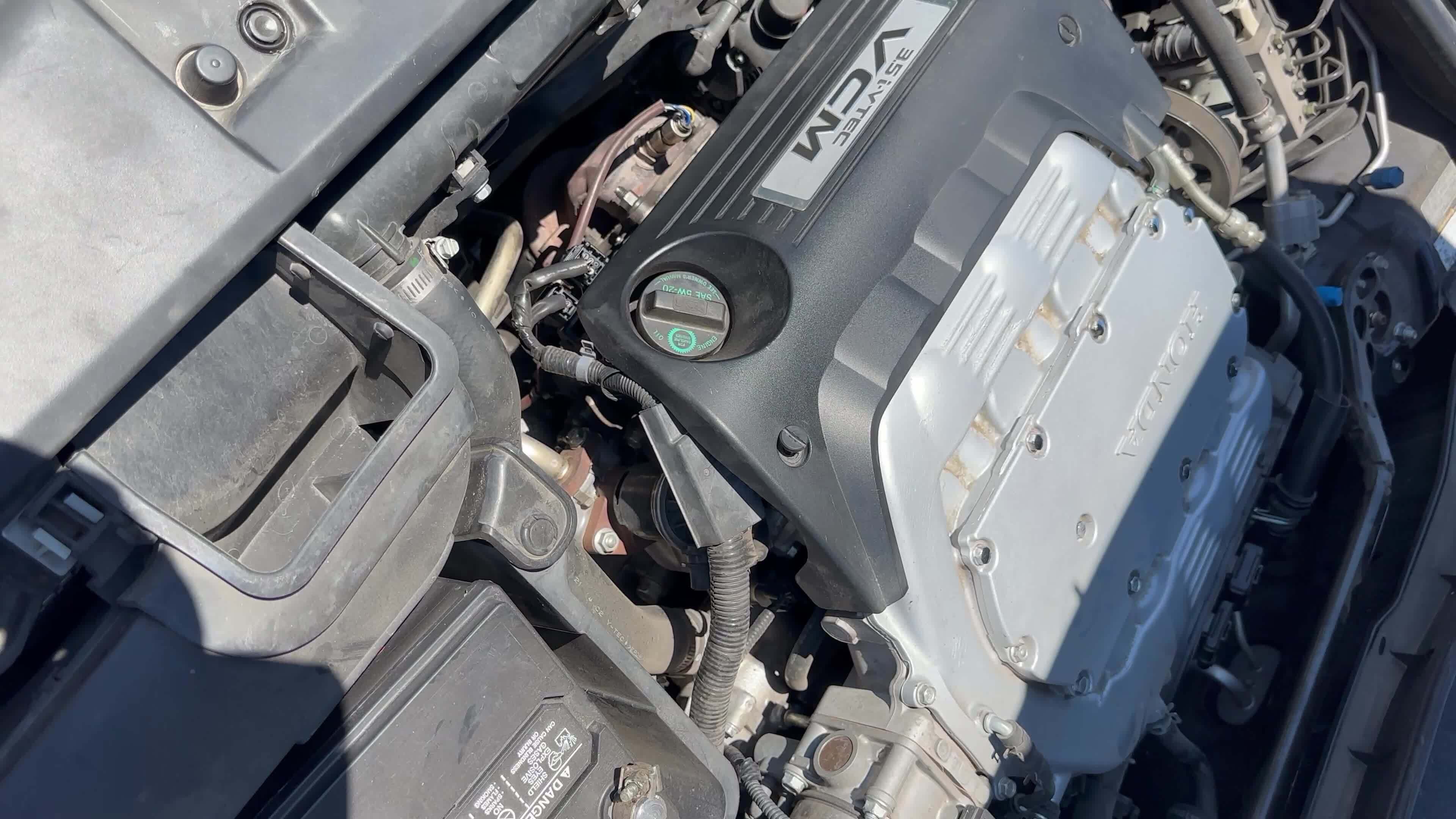

I went to a different shop just to get the bolt put in, he noticed the vacuum hose on the left side of the engine (it is in the image as well) was not fitted all the way and the hose clamp was a little further back than it should be. Right after driving off from that shop, I scanned it twice and the same P0306 code came up, but there was no check engine light. Yesterday afternoon after I left work, I scanned it twice and no codes came up. I’ve been driving it around today and scanning it, no codes at all. It is driving well, no weird RPM readings, should I leave it be until something happens?

Yep, it sounds like the problem might be fixed, keep driving it and if the problem comes back let me know and we can continue.
