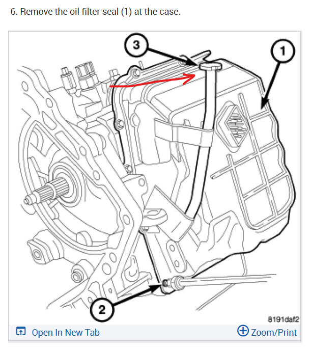

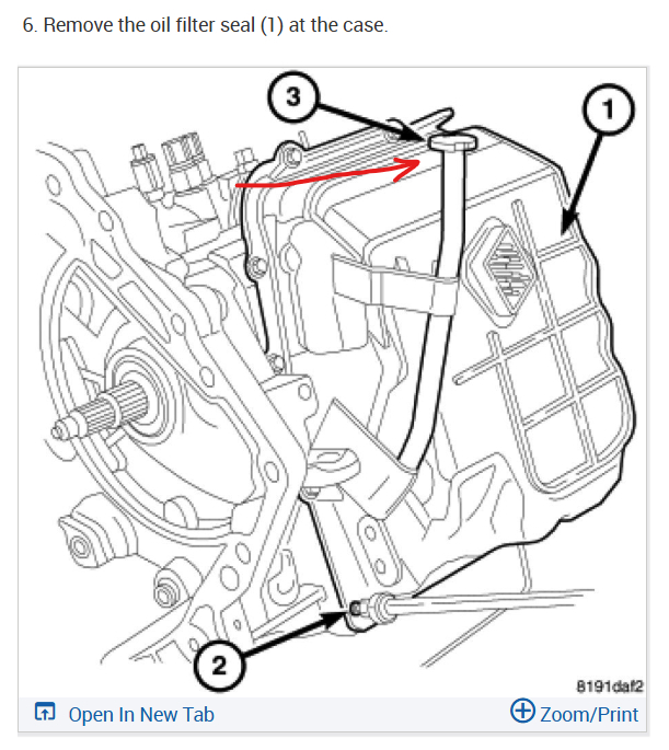

Mr car will start with no problem, but it will not move forward or backward. When I push the gas pedal it's getting gas but it's not moving.
Jul 16, 2025 at 6:51 AM
  • 54,502 POSTS
This can be the transmission fluid is low, also, do you have any warning lights on like the check engine light? If so, we should run the codes, this guide can help:
Here is a guide to help you check the transmission fluid and condition, you should smell the fluid to see if it is burnt.
https://www.2carpros.com/articles/how-to-check-and-add-transmission-fluid
MOPAR(R) ATF+4 (Automatic Transmission Fluid) when new is red in color. Check out the images (below). Please let us know what happens.
