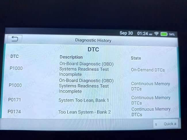

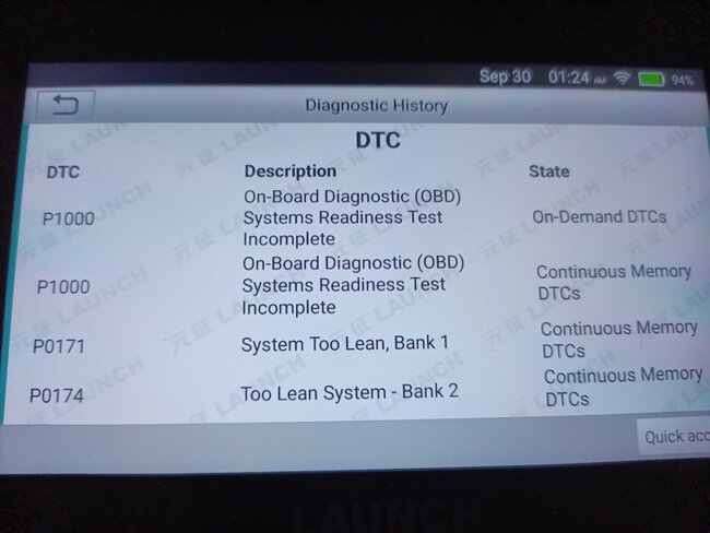

Sure i took a picture of my scanner. It did say lean bank 1 and 2 but it shows another code P1000. I've never seen that one before. And ok i will read over the guides.. Also, this is how it behaves. When you step on the gas it sounds normal. When i put the van in park it sounds normal. But when i am driving along and i come to a red light or stop sign and press the brake is when it the motor sounds funny. Idle then slows down. Idle then slows down.
Oct 7, 2025 at 10:38 AM (Merged)
  • 54,494 POSTS
Don't worry about the p1000 code. So when you press the brake pedal can you hear air escaping? Also, when you pull the check valve out the brake booster can you hear air escaping? If so this can be the problem. Here is a guide to go over that shows common problems for lean exhaust codes.

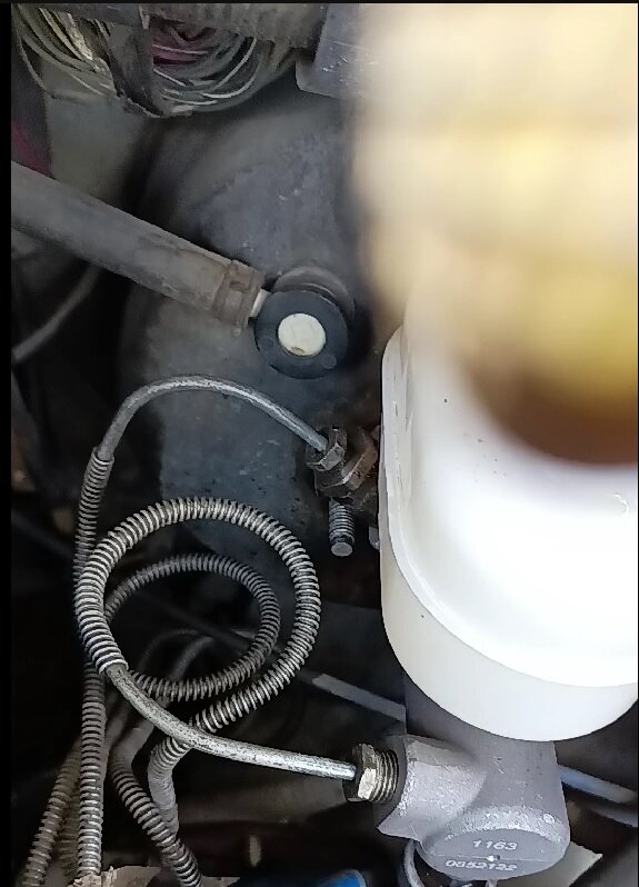

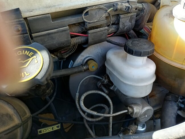

Update: Ok i have brakes the kinda sink a little bit but my motor no long stall or idles rough when i hit the brakes. picture to the left is the old one. And the pic to the right is the new one etc.
Oct 9, 2025 at 2:17 PM
  • 54,494 POSTS
Yep, that is a repair well done, I assume the brakes work okay now?, thanks for the images they help.
