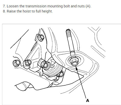

I just noticed there is a motor mount missing on my car listed above Dx model. There are two bolt holes in the passenger side of the oil pan, and holes in the frame. I've searched for this part but can't find it anywhere, not even on YouTube. Does anyone know anything about this part, or what it is called so I can order one? Any sites where I can view or read about this will be greatly appreciated. Makes no sense to me that the previous owner didn't have one, and worse yet, hid this from me. Thanks again.

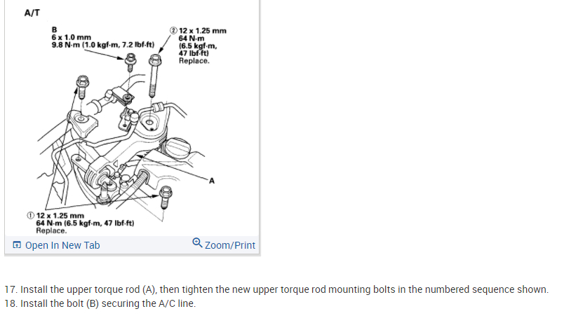

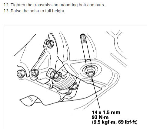

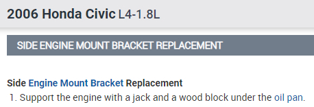

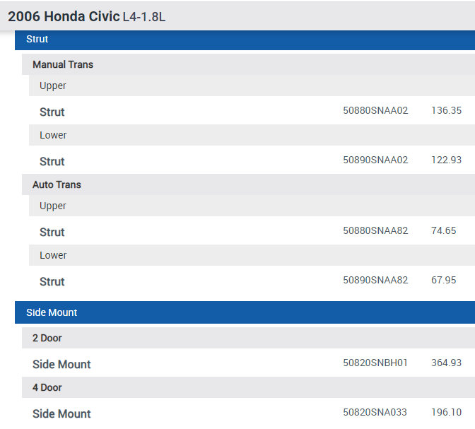

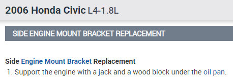

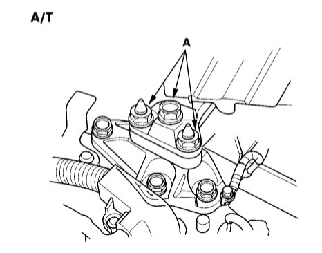

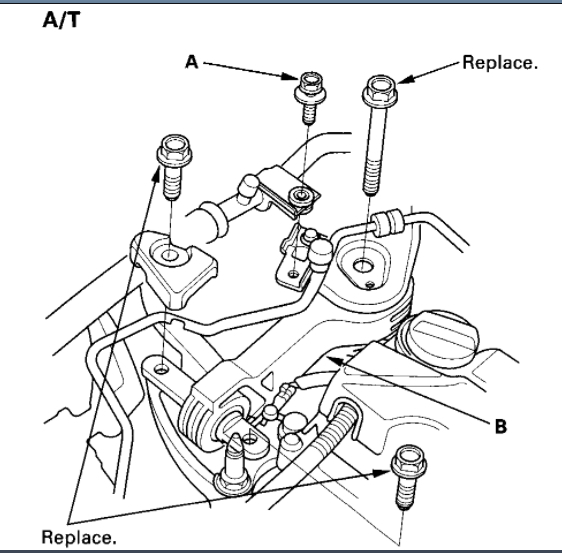

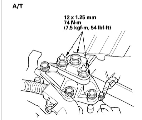

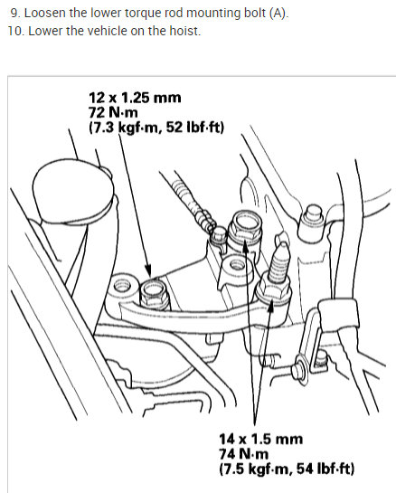

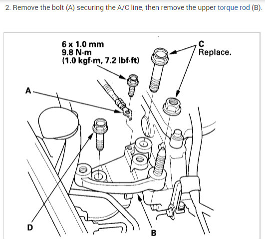

Here is the information you requested. First. Here is a tutorial for you to view showing how to remove and replace a motor mount:
https://www.2carpros.com/articles/replace-motor-mounts
I've attached picture steps below on how to remove and replace the motor mounts on your car and it includes the Honda factory part number for the mounts. Let me know if you have any further questions on this issue. Hope this helps and thanks for using 2CarPros.

Thanks. I have already purchased the mounts that you sent, and have YouTube videos showing how to install. My question still stands: there are threaded holes in the passenger side oil pan, and holes in the frame next to them. It is clear that something is missing. I'm guessing a mount. I cannot find anything, anywhere stating what is missing. I will be going to a dealership. I'm sure they will have the answer. Thanks for your time and help. By the way, the info that you sent, those mounts come in a group if anyone is interested. Cheaper to buy that way.
