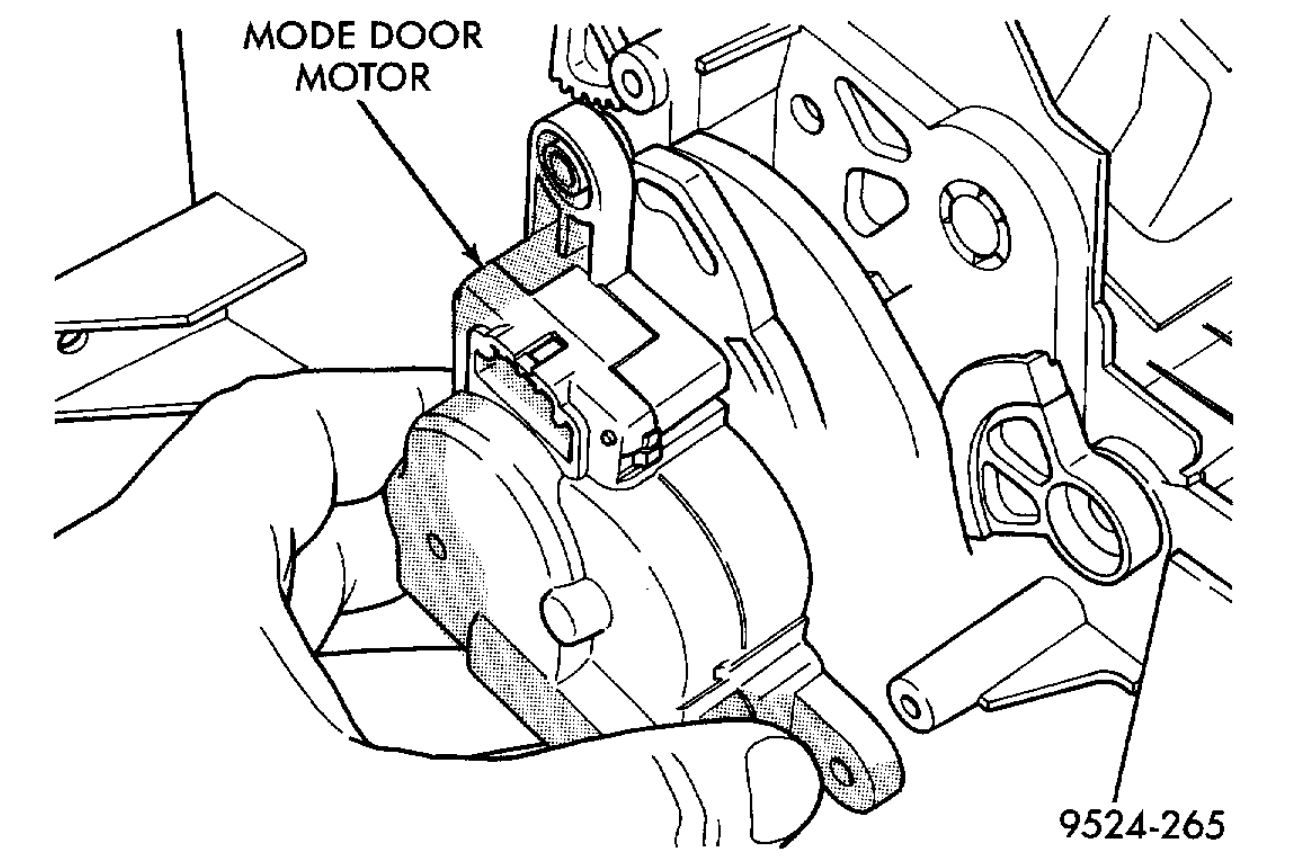

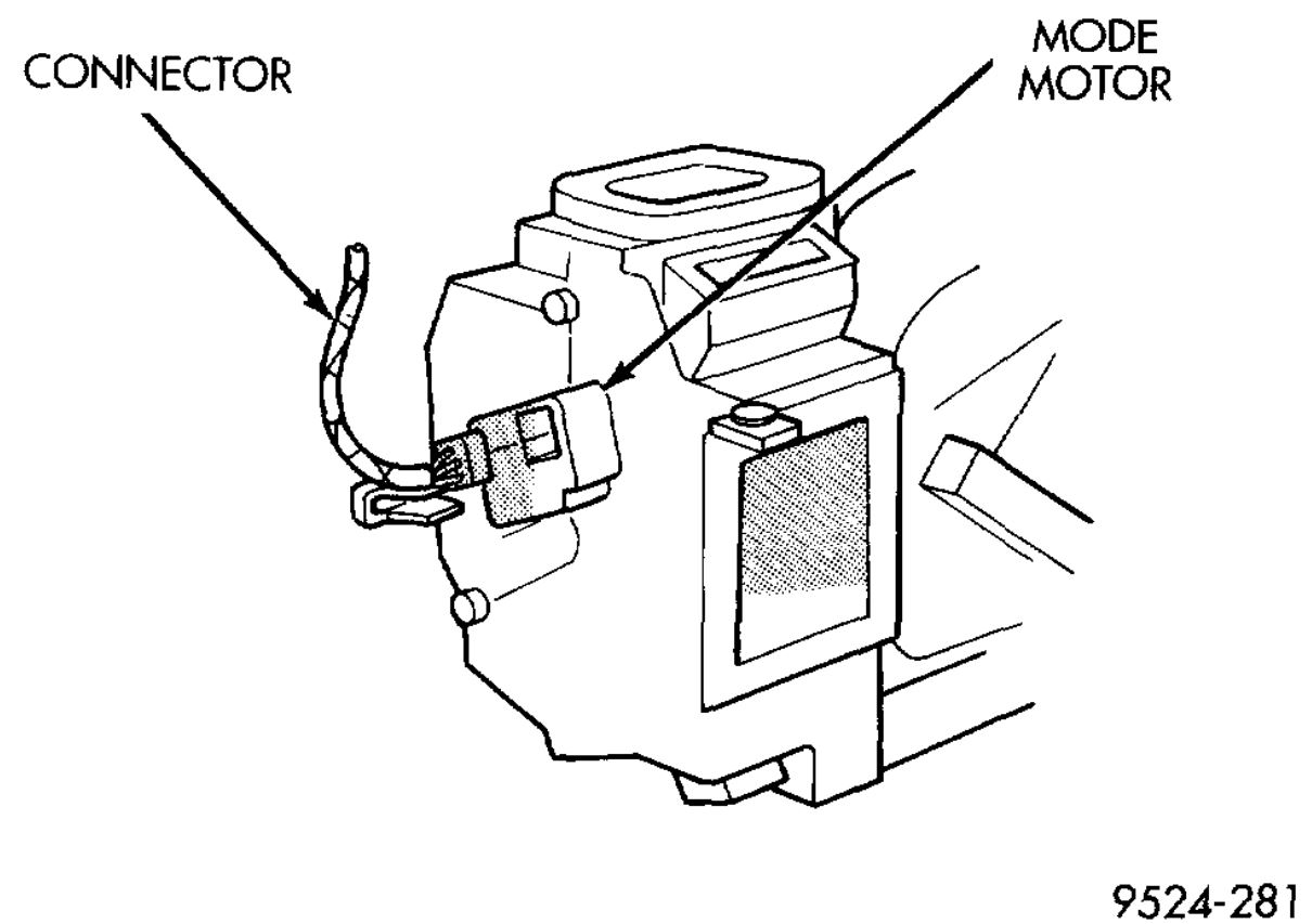

Can someone please tell me where this is located? Do I have to take the dash apart or just one side? I do better with pictures.

The mode door actuator is located on the upper left side of the A/C-Heater housing.
REMOVAL
1. Disconnect battery negative cable.
2. Remove left underpanel silencer/duct.
3. Remove electrical connection on actuator.
4. Remove actuator retaining screws. Then pull actuator straight down. Upon removal, note the shaft position of the actuator, because the shaft on this motor is keyed. When installing new actuator, its shaft must be positioned in the same location.
INSTALLATION
For installation, reverse the above procedures.

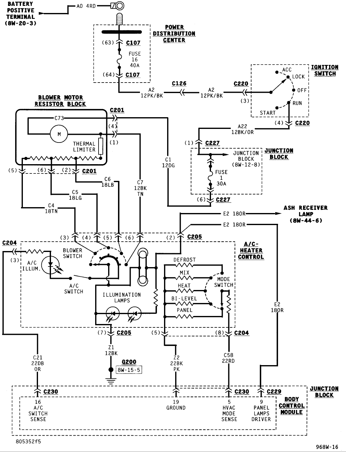

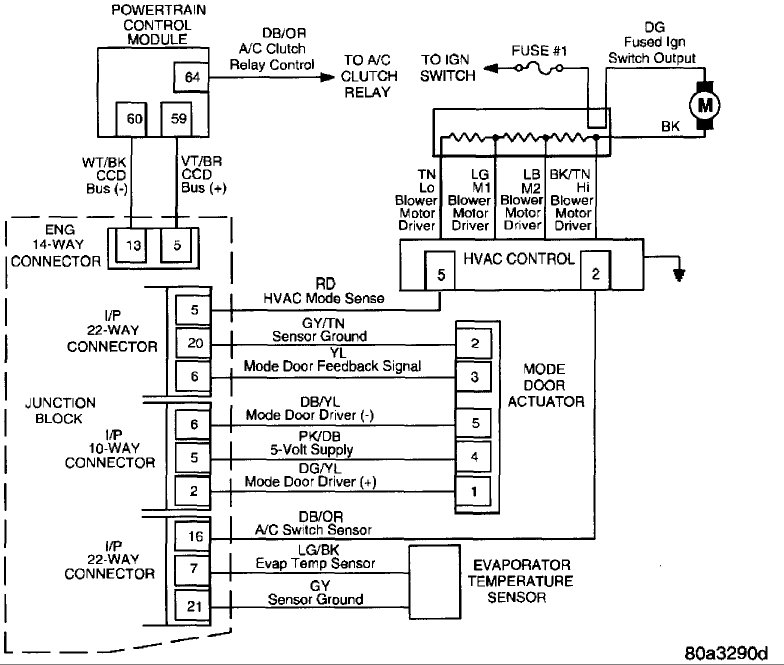

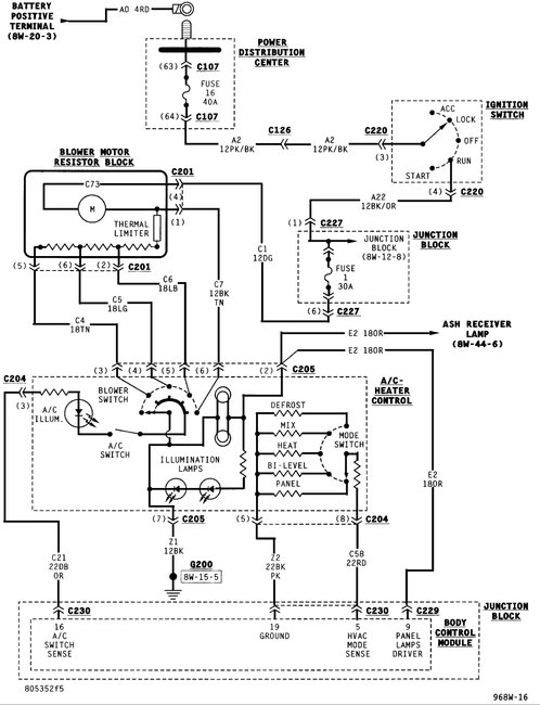

STEVE W.
  • 15,696 POSTS
It sounds like you may have a bad controller mode switch. It uses a voltage drop through it to determine the position of the controller as well as preset resistances in the switch. I am guessing you tried another controller already?
Maybe these schematics of the system will help.
+1
Saturday, October 31st, 2020 AT 11:07 AM (Merged)
MEPHISTOPHELES
  • 10 POSTS
Thank you for the diagrams! I have measured the resistance on the pins on the HVAC control between the mode sense pin (red wire on 8-pin connector) and ground and got the following when switching the mode selector: 0.835K/1.3K/2.3K/5.3K/100K. Probed voltage on 8-pin connector (connector unplugged) and got approximately 2.5 volts. All lights, fan speed selector and window defog switch works. Checked ground connections on both the 8-pin connector (black with pink stripe) and the 6-pin connector (black wire) and it is okay.

STEVE W.
  • 15,696 POSTS
Voltage sounds low, what do you get on the red mode sense wire with the controller unhooked? You should see 5 volts between it and a good ground.

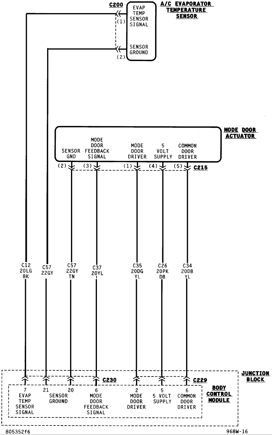

MEPHISTOPHELES
  • 10 POSTS
Checked all the five wires between the 5-pin servo actuator connector and the BCM (body control module) 22 and 10 way connector and it checked out fine, no open circuit. I see two possible solutions: bad servo actuator (despite measurements looks fine) or faulty BCM.
