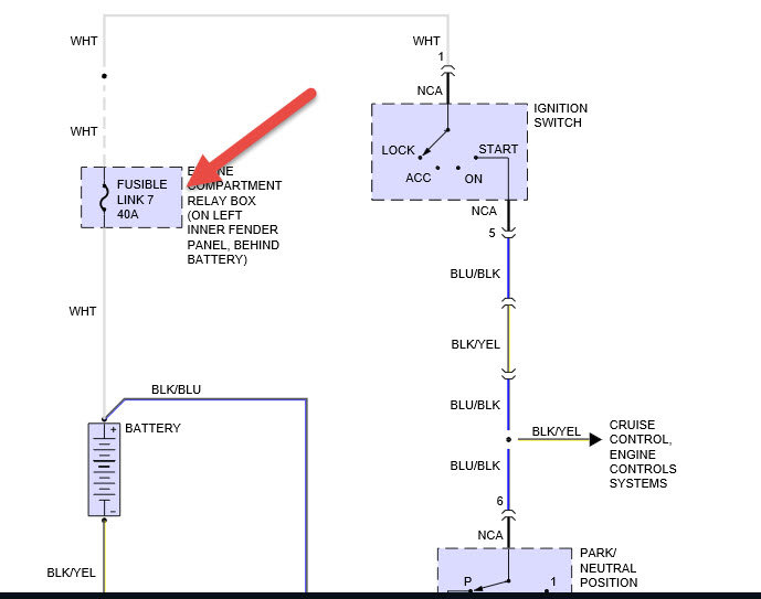

While driving down the highway, all of the electrical components of my car shut off; my radio, windows, locks, and lights would not work, but the car was still running. It felt as if it would die as soon as I hit the brakes or started slowing down alot. I made it to a parking lot, but as soon as I hit the brakes, the car shut off completely and could not be jumped. I don't think that I can get a diagnostic check without the electrical components of my car turning on, so what could be the problem?

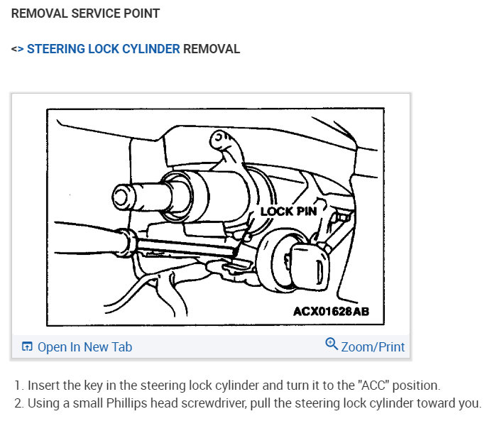

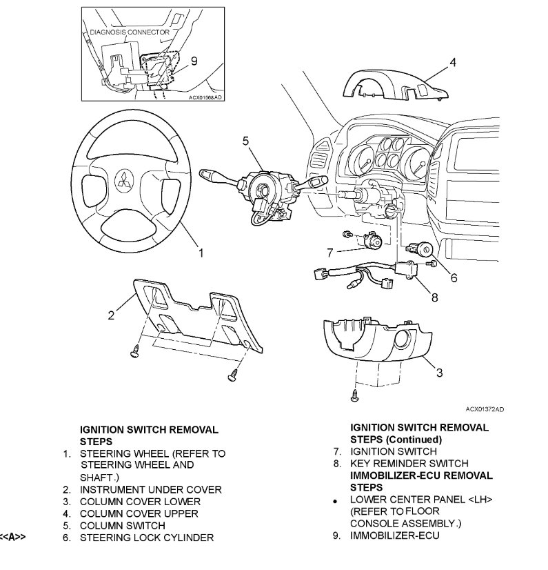

Test the fusibile links and the ignition switch
