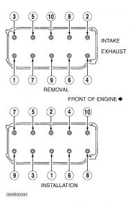

put on new head gasket need to know what head tensions are for lancer 1.8 CC 1994 single over head cam

Tighten head bolts (with cold engine) in 5 steps following sequence below.
55 Ft. Lbs
Fully loosen
14.5 Ft. Lbs
1/4 turn (90 degrees)

Thanks your help was wonderful.
