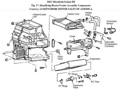

Air Conditioning problem
2001 Mitsubishi Galant 6 cyl Two Wheel Drive Automatic
a/c is leaking into car bad thhe whole carpet is saoked i am almost positive that the drain line from the condenser coil is cloged with slime. in my house i add slime out to the condenser coil collection trak and flush the drain lines my problem on this car is i cant find the coil or the drain line can you help. i have a full range of tools. thsnks

Hi scoobykadi, The AC drain hose is located at central part of firewall and goes in to the evaporator housing.
https://images.2carpros.com/forum/automotive_pictures/192750_Evaporator01Galant_1.jpg
You need not remove the unit to get at the drain hose. Pulling up the carpet should allow you access.
