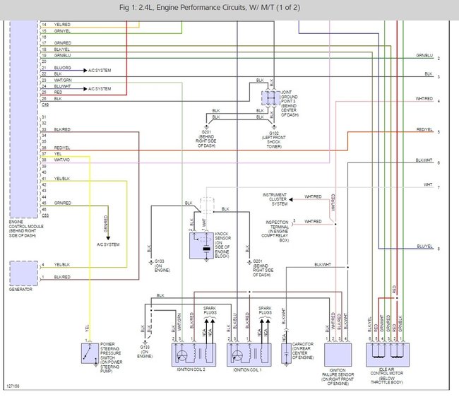

There is an ignition failure sensor that can go out causing the injectors to stop working as a safety feature. here is a wiring diagram that can help you test for the problem.
Check to see if everything is getting power and a good ground.
Please run some tests and get back to us so we can continue helping you.
Best, Ken

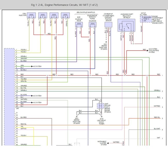

JTMECH
Electrical problem
1996 Mitsubishi Eclipse 4 cyl Front Wheel Drive Automatic 135000 miles
trying to find out why car is running on 2 cyl's, cyl's 1 and 2 are working fine but 3 and 4 injectors are pulsing only every now and then. got a used ecm and it is still pulsing inj. 3 and 4 Intermittently. any ideas on this problem

Although it would require some testing with a lab scope to find out, it sounds like the ignition module may be having a problem forwarding the tach signal to the PCM but that's just a wild guess.

is'nt the ignition module in the ecm?
Mar 22, 2017 at 11:43 AM (Merged)
WRENCHTECH
  • 20,761 POSTS
Yes, after looking at the wiring diagram again, it appears you are correct. I thought that one had a separate igniter but it doesn't.
