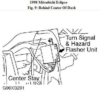

where is the flasher unit for turn signals located
Thursday, February 5th, 2009 AT 1:14 AM
BLUELIGHTNIN6
MECHANIC
16,542 POSTS
Behind A/C and heater control panel, in center console (pictured below)
