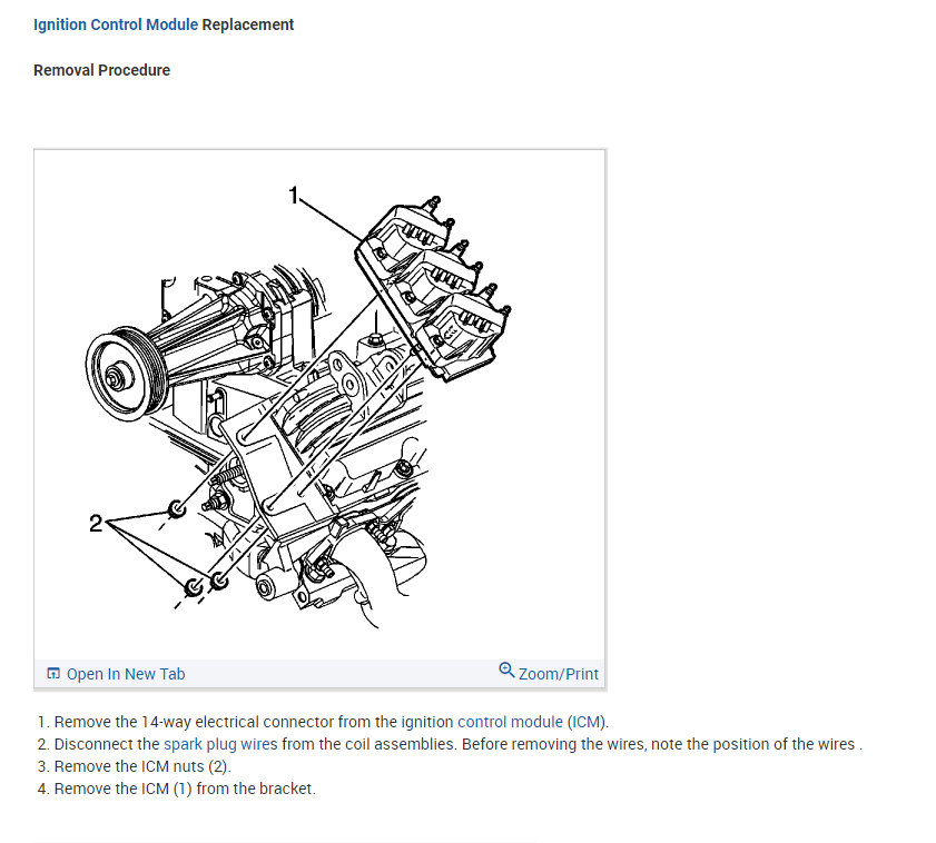

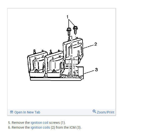

Yes, had a misfire. One coil pack was not firing replaced it and it's still misfiring scan code p300.
Sunday, July 25th, 2021 AT 8:18 AM
MECHANIC
52,796 POSTS
Good afternoon,
You need to change the module that the coil pack is mounted on. That is what commands the coil to fire off.
When we have this failure, we replace all 3 coils and the module together.
