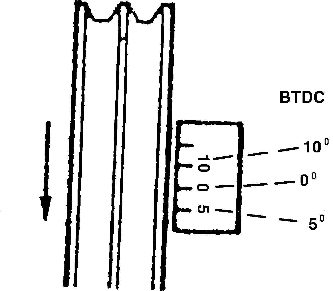

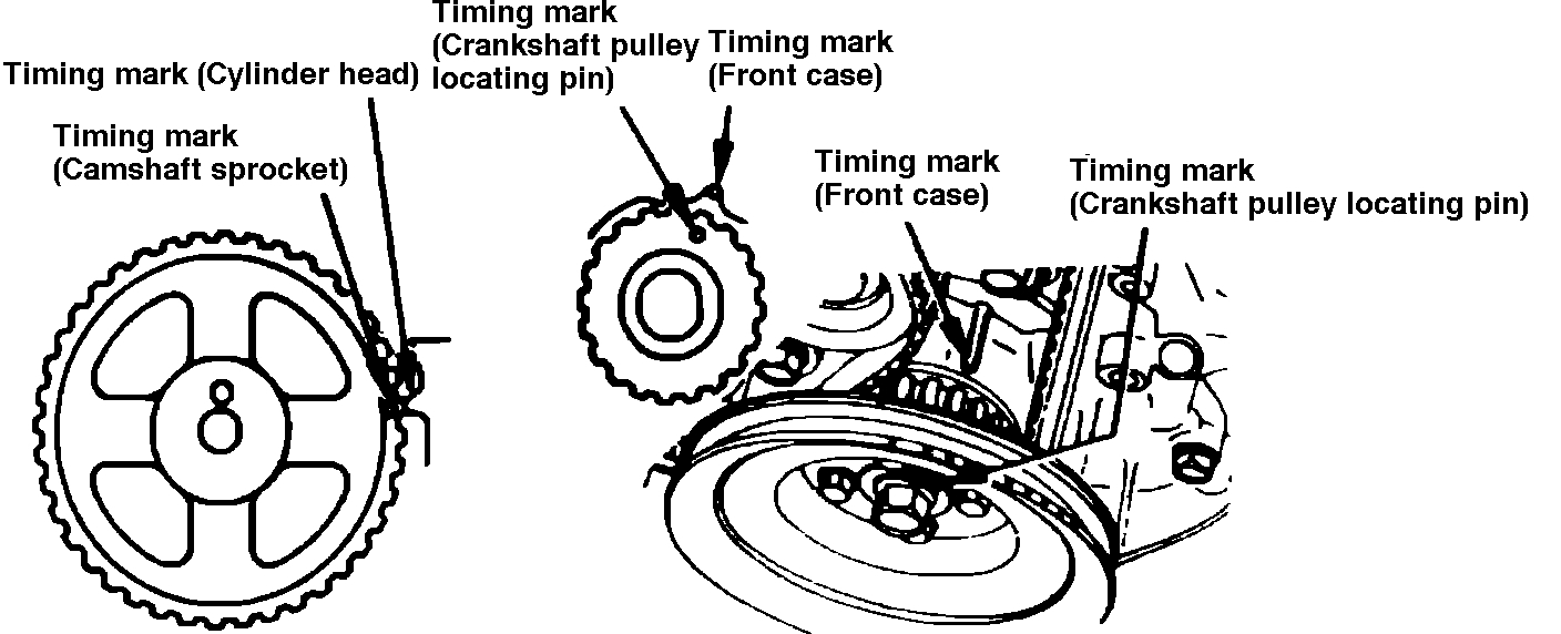

Where are the timing marks on a 1986 dodge colt 1.5 Liter. Trying to time with timing light. Cannot see other mark on pulley. Can you send picture if possible.
Monday, September 3rd, 2018 AT 6:39 AM (Merged)
  • 110,192 POSTS
Hi and thanks for using 2carpros. Com
I just went through my manual and found two pictures. I hope they are helpful.

Where is the timing marks on the bottom pulley for timing. I cannot see one in the picture you sent or on the car. Do you have a clearer picture. Thanks.

Hi. It should be in line with the crankshaft pulley locating pin. It is not a very big mark.
