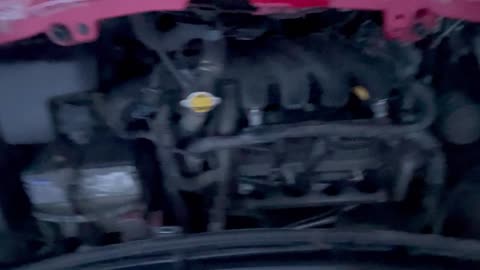

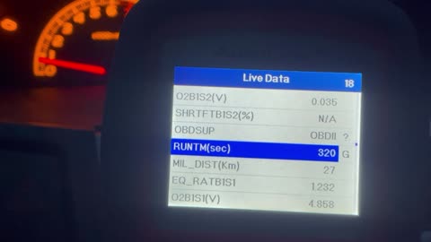

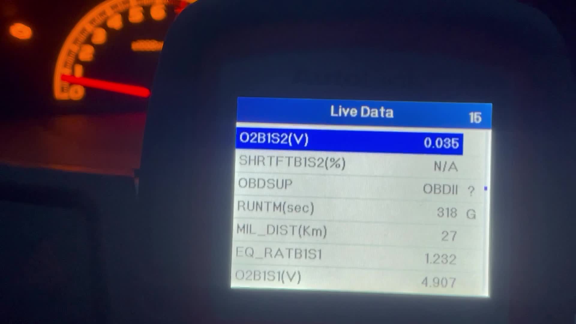

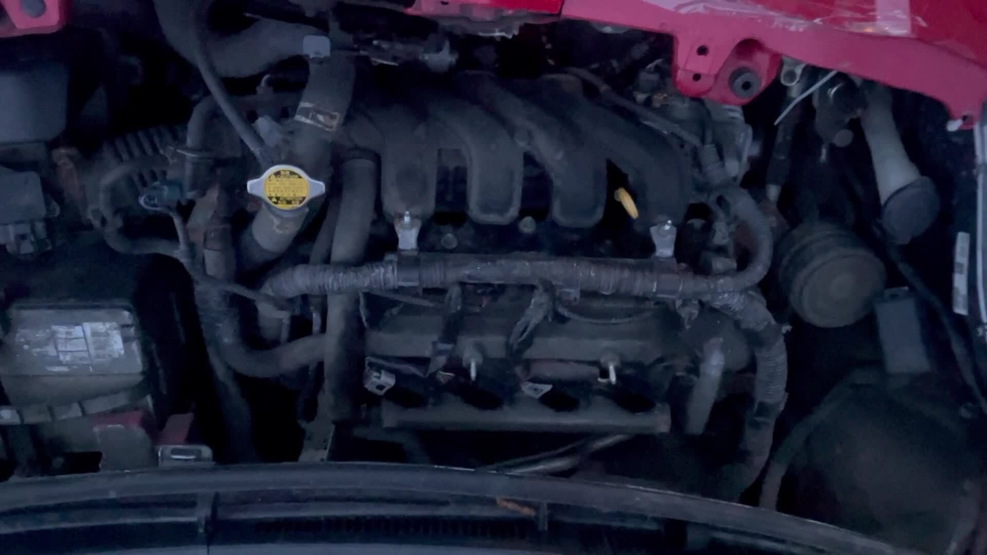

It is down in power and runs rough at idle. It has stalled several times, always when slowing to a stop or turn or when accelerating off of a stop. It is inconsistent, only having stalled a handful of times. I also noticed that it idles ok when first started but starts running rough when it comes off fast idle
Shouldn't a MAF, vacuum leak, fuel pressure, or O2 affect all cylinders? Is it more likely the misfire is causing the lean code? I doubt they are unrelated because they both popped up at the same time
I've included videos showing the ODB data and the engine bay. The roughness is subtle, so it didn't come through well. It's also not as rough as usual. When it's bad the RPMs can fluctuate from as low as 500 up to 1,200.
Dec 15, 2024 at 1:12 PM
  • 54,520 POSTS
Thanks for the video, it helps. The engine noise does not sound good, you may have a roller follower that has fallen apart. Also, the MAF sensor readings look low, I would do a compression test and check for vacuum leaks.

I found the problem. A small hole in the intake manifold directly in front of cylinder four, the one that showed the most misfires. Given the way it only ran rough when it came off of fast idle and seem to be normal on the highway, my suspicion is that the hole was only big enough to make that cylinder misfire when there was low flow but in high flow it couldn't lean it out enough to make that much difference.
Dec 23, 2024 at 7:26 PM
  • 54,520 POSTS
Yes! good find, those plastic intakes can create weird problems like this. Thanks for letting us know, we are here to help, please use 2CarPros anytime.
