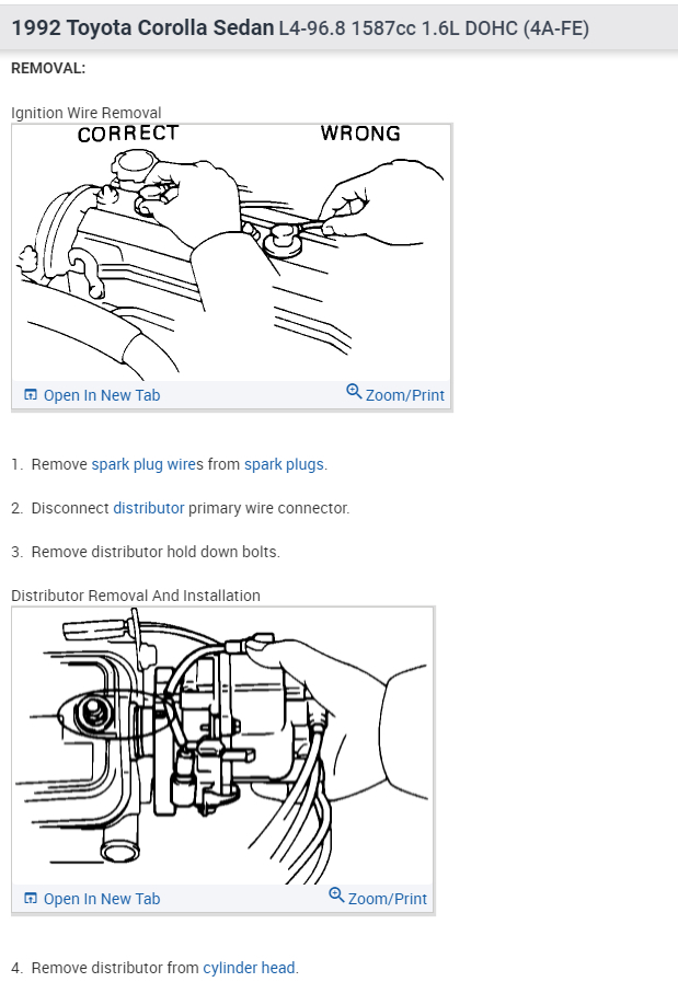

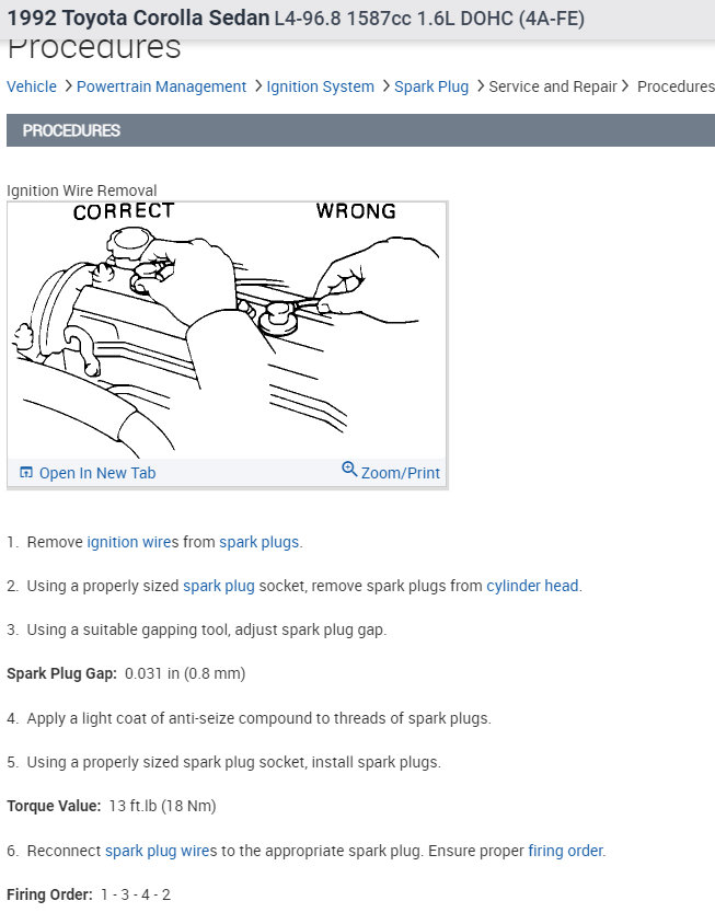

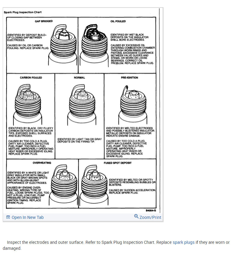

A clogged catalytic converter can lead to a misfire also can cause poor fuel economy.
Here is a guide on how to test the catalytic converters:
Keep in mind that the misfire can also be caused by weak spark plugs. As they can misfire under certain load as you are driving.
Unless you have already done it, it will be good idea to check the plugs and make sure they don't have carbon build up and the gap is set correctly.
Those plugs should be gapped at 0.031 inch.
https://www.2carpros.com/articles/how-to-change-spark-plugs
Also, engine can misfire due to worn components like distributor cap, rotor, wires etc.
