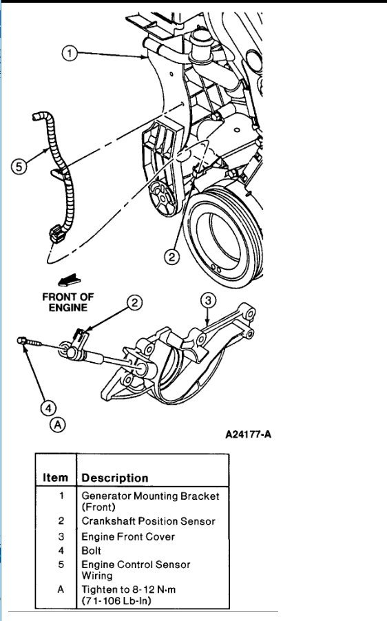

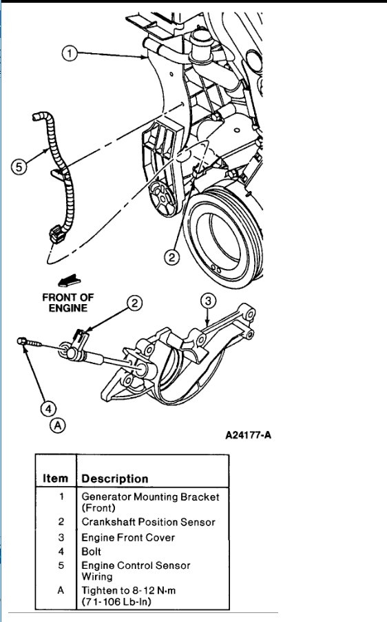

Oh and yes I did look at the plugs they look almost the same as the new one, no carbon, no moisture, no oily residue and this being 2 plugs per cylinder im not sure which side it is causing the problem. Also hopefully someone will know does this have a crank shaft sensor and where it is at? I can't locate it at all
Monday, January 9th, 2017 AT 2:47 PM
KEN L
  • MASTER CERTIFIED MECHANIC
  • 55,281 POSTS
Hey ANTHONY,
Here is the sensor location and a guide to help you know what you are in for when changing it.
Please let us know happens so it will help others.
Best, Ken
Monday, January 9th, 2017 AT 3:49 PM
