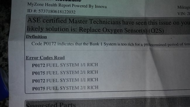

Okay day three car's check engine light. Well as all of you know been having some problems what this check engine light of mine. So far six new fuel injectors, one gas cap, one set of plugs, one camshaft sensor, and one crankshaft sensor. Well today the code came up po172 which is oxygen sensor in bank one. So I believe that would be the upper so I guess that is next. I also replaced the serpentine belt I noticed it was slightly worn. I hope replacing the oxygen sensor will resolve this problem once and for all. Do you think I should replace both of them or just the one thanks again? Your buddy
Monday, June 18th, 2018 AT 9:16 PM
JIS001
  • 3,412 POSTS
P0172 is for system running too rich. You would need to check both banks to see if both are running rich. Looking at long term fuel trims bank one will most likely be -25% or higher.
If bank two shows the same readings then I would focus on the mass air flow sensor. Also, they should look at the freeze frame data to see if the codes are set at idle or cruising to try and duplicate the concern. Get back to us on what fuel trims are at on both banks, both long and short term fuel trims to better guide you before you replace the oxygen sensor. Also, what were the trims on freeze frame and if rpm shows idle or cruising speed?

Here is what I have so far:
Tuesday, June 19th, 2018 AT 1:40 AM
JIS001
  • 3,412 POSTS
Both banks are running rich. Can you post what the freeze frame is? Would need to see RPM and short and long term trims.

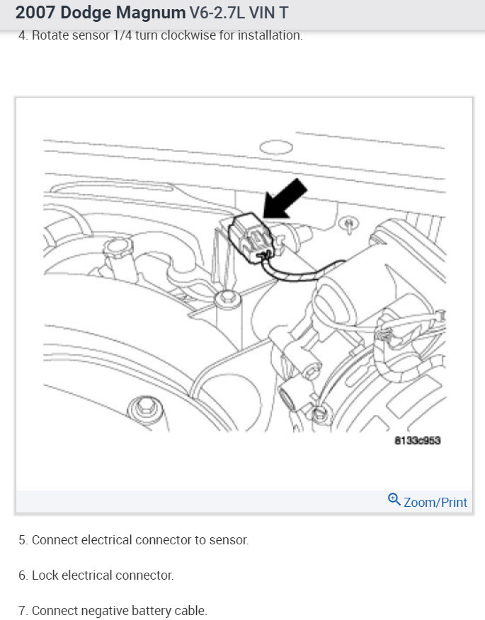

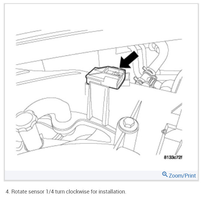

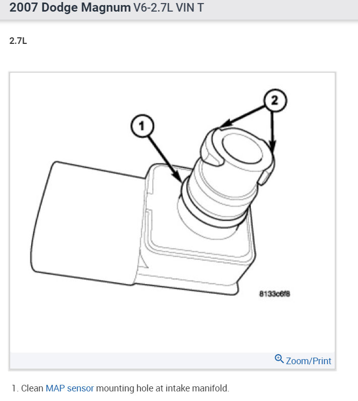

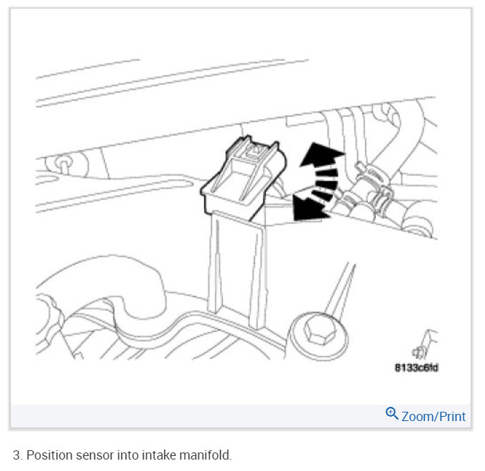

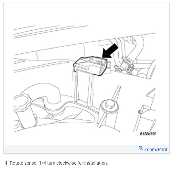

KEN L
  • MASTER CERTIFIED MECHANIC
  • 55,279 POSTS
These fuel trim issue can be caused by a MAP sensor that needs to be replaced. The problem is when this sensor gets off a little it will affect the engine management without triggering a check engine light. here are diagrams to help you replace the sensor.
This guide can help as well.
https://www.2carpros.com/articles/repair-lean-mixture-codes-p0171-or-p0174-on-some-manufacturers
