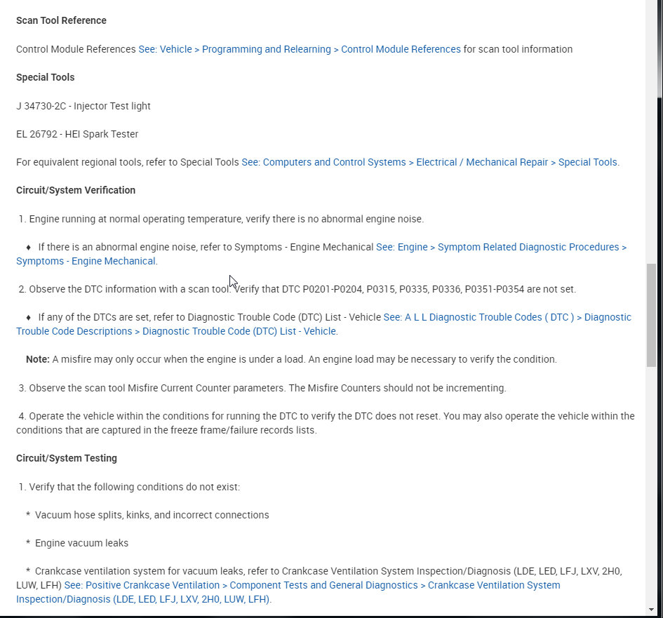

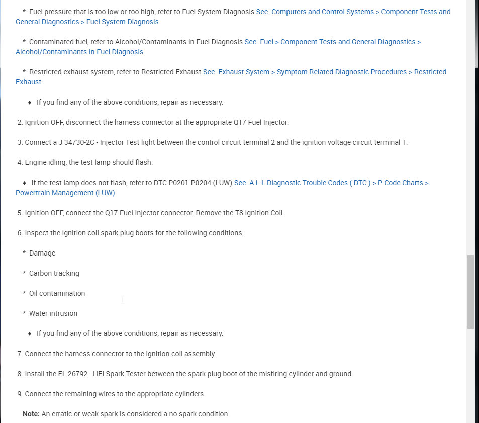

Changed coil pack, and plug, but is still doing it.
Sunday, February 2nd, 2020 AT 6:29 AM
MECHANIC
18,907 POSTS

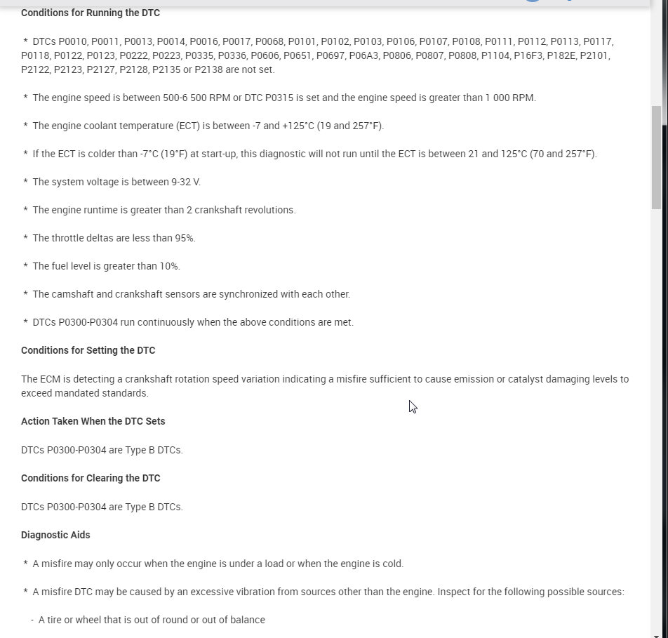

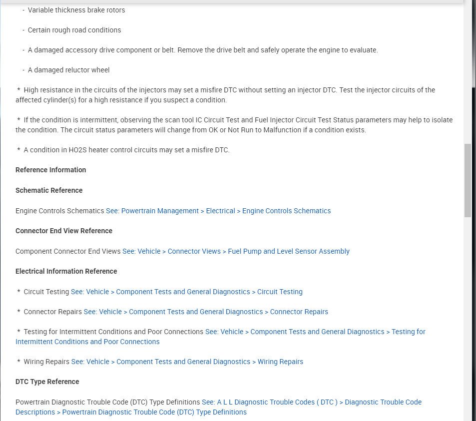

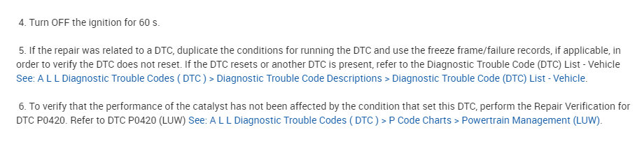

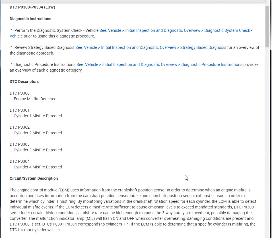

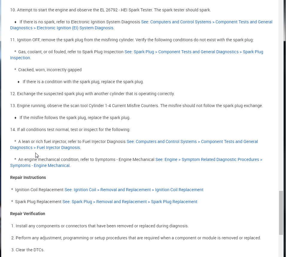

Have you pulled the codes to determine which cylinders are missing?
I attached the testing for misfires assuming you have a P0301,2,3, or 4.
Clearly there are other things that can cause a misfire but we need to limit them down. Let's start with the codes and go from there. Thanks
