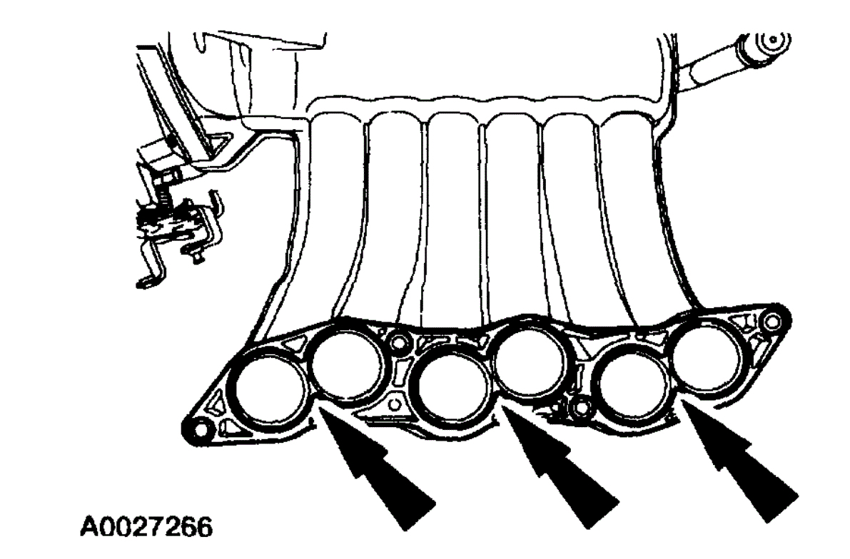

Well, I did not do the compression check but I took the upper Manifold off to change the gasket and first off it was really dirty and corroded bit also it had the little blue ring isolated gaskets inside the holes, but it did not have the large full gasket that separated plastic from metal. Does that matter? Do the blue rings serve as a gasket or does it still need the large gasket as well?

Yes, the intake gasket is comprised of rubber o-rings only. See pic below.

See pic below.

Hi Joe, thanks for responding, so I bought a fitting long gasket for it today and installed it. I did not take the o rings off though. Would that cause a problem or would it be okay? About the head gasket, I was told it would cause overheating and some hissing under the hood also if it was bad and I have neither. Is this true? I am mysteriously losing coolant but was told it could be because the gasket missing from the Manifold letting air in or escape. I have no idea what I'm doing, just trying to get rid of the misfire. I am going to drive it around a bit in the morning and see if I can still feel the misfire or now. But if I do, I really don't know what else to try. Could any of the sensors cause misfiring?
