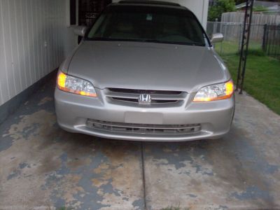

Where should I begin...when I start my car up, put it in gear, or begin to drive, it shakes for a few seconds and then stops, only to begin shaking again a few seconds later. When im driving, it feels as if it is going to cut off when I come to a stop. I had the car tested and the codes P0300,301,302,303,304, and P1399 keep appearing, all which read "cylinder misfire"...This is rather irritating! Another thing that I have noticed is that my battery seems to die if my car sits in the driveway for a day or two, whether hot or cold weather. I got it recharged at Autozone yesterday and today it is dead again...I recently bought that battery also and it tested "OK". Im a college student and I really would like your help before I spend any money to get my car fixed! THANKS!
