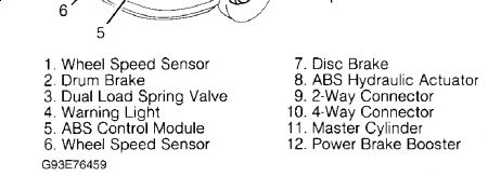

DESCRIPTION & OPERATION Hydraulic brake system has power assisted dual piston master cylinder with diagonally split disc brakes in front and drum brakes in rear. Wheel speed sensors signal ABS control module, which allows ABS hydraulic actuator to control braking effort on separate brakes to control tendency to skid during a stop. A dual load spring valve is located on rear axle. When vehicle is unloaded, valve closes partially reducing pressure to rear brakes. As vehicle is loaded, valve opens gradually until full pressure is supplied for a full load. See Fig. 1 .
https://www.2carpros.com/forum/automotive_pictures/62217_a_2.jpg
https://www.2carpros.com/forum/automotive_pictures/62217_b_2.jpg
https://www.2carpros.com/forum/automotive_pictures/62217_c_2.jpg
https://www.2carpros.com/forum/automotive_pictures/62217_d_1.jpg
https://www.2carpros.com/forum/automotive_pictures/62217_e_1.jpg
BRAKE LOAD SENSOR PROPORTIONING VALVE Measure spring length with vehicle in unloaded position. Spring length "A" should measure 6.25- 6.37" (158.8-161.8 mm). See Fig. 4 . If spring is not as specified, sit on rear of vehicle then slowly get off. This will stabilize suspension deflection. Loosen eye bracket bolts. Adjust spring length by moving bracket. Tighten bracket bolts to 13-15 ft. lbs. (17-21 N.m). See Fig. 5 . NOTE: All fluids should be at specified levels (fuel tank full) and spare tire, jack, hand tools and floor mats should be in their stowed positions.

Thanks for the great info. Our villager doesn't have ABS though.

Could my problem with only the left rear brake line be caused by a failed proportional/dual load sensing valve? Is it possibly for them to fail and only effect one line? Thanks for the help.

It would be affecting that rear and the opposite front, How is the pressure at the right front? This is a diagonaly split system, rf and lr are paired off the master. So if the master is weak on that half, you will get problems like that, or the combination valve up front that the lines branch out of. And yes that rear hieght sensing valve too.
