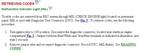

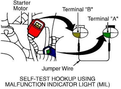

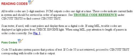

I cannot get the device to retreat it because it is made in 1993. So please teach me any method to retreat the code. Thank you.

Post the codes here, and we'll help diagnose.
