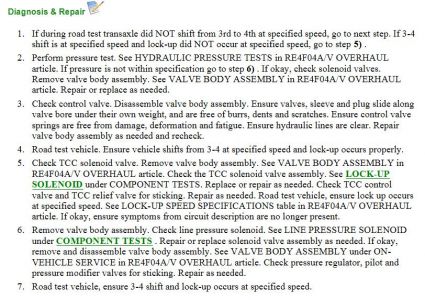

Here is a description of the problem and diagnostic procedures.
DTC P0744/1107: TCC SOLENOID VALVE
Circuit Description
DTC is set when improper shifting to 4th gear position or improper torque converter clutch operation is detected. Problem is NOT caused by electrical failure of A/T circuits but by mechanical failure. Control valve sticking, improper solenoid valve operation, malfunctioning oil pump or torque converter clutch etc.
https://www.2carpros.com/forum/automotive_pictures/192750_DTCP0744Repair98Villager_1.jpg
Tuesday, May 12th, 2009 AT 10:42 AM

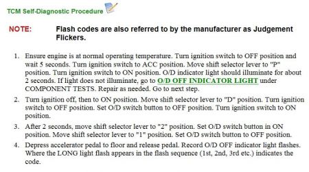

Maybe you can try a manual code retrieval to see if there are any codes stored. I am not able to upload the codes charts now as there seems to be some problem with my connections and will do so later.
https://www.2carpros.com/forum/automotive_pictures/192750_TCMOBD99Villager01_1.jpg
Tuesday, May 12th, 2009 AT 12:21 PM

Been follow your posts got an idea what might be going on. Need to know if you did the TCM selfdiagnoses test and did long pulse occure in flash #7?
Let me know
Wednesday, May 13th, 2009 AT 9:23 AM
PRP2298
  • 15 POSTS
Seems there was long pulse, any ideas?
Wednesday, May 13th, 2009 AT 10:35 AM

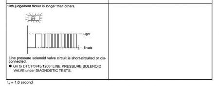

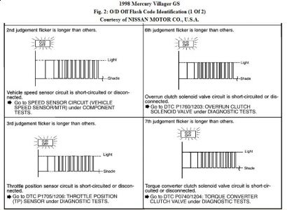

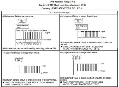

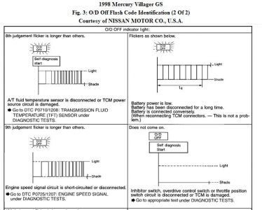

Which of the following conditions described the pulse that you are getting?
https://www.2carpros.com/forum/automotive_pictures/192750_TransDTC98Villager01_1.jpg
https://www.2carpros.com/forum/automotive_pictures/192750_TransDTC98Villager02_1.jpg
https://www.2carpros.com/forum/automotive_pictures/192750_TransDTC98Villager03_1.jpg
https://www.2carpros.com/forum/automotive_pictures/192750_TransDTC98Villager04_1.jpg

Overdrive off light is not flashing. Sometimes comes on when shifting into gear, goea off with tap to button on end of shifter. Overdrive off function works well at all times, even when service soon light is on.
Wednesday, May 13th, 2009 AT 11:49 AM

You need to go into TCM diagnostic modes to get the OD light to flash.
Refer to previous replies I made.

You did the test and there was a long flash on seventh pulse. If yes then there is a hard part failure in trans ie convertor, solenoid, oil pump, ring seals on input shaft damaged during rebuild. Hope you got a warrenty because it needs to come back out and problem found.
