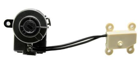

Nothing in the car works when the no start problem happens. No interior lights, no dash lights, no radio. When it will start, all the lights come on normally, however sometimes when it's hot out IF you don't get it started on the first try, it will sometimes go out- all lights, radio, indicator lights die. Sometimes it will start by repeated tries, sometimes it won't start for days. Have not tried the ignition switch which is $55 but this looks like a part built to fail. What is the small box with two wires hanging from the side?

Think little box is ignition illumination. Remove collumn covers and wiggle connection see if stuff cuts out. If so replace
