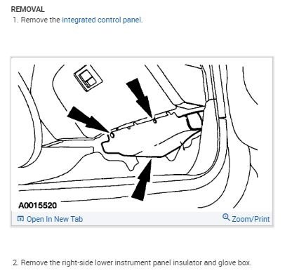

My heater will blow warmish air when it is first turned on after the car has warmed up. Within a minute or 2 it starts blowing out cool air. I have flushed out the cooling system all ready. It is not dripping water anywhere (as it would for a heater core problem). A mechanic told me it sounded like it might be a issue with the blend door. Does this sound right, and if so is this something I could fix myself?

Check and test the thermostat and heater control valve if both okay could be one of the following-air mix/blend/mode door problems, vacuum and actuators to include the HVAC control module

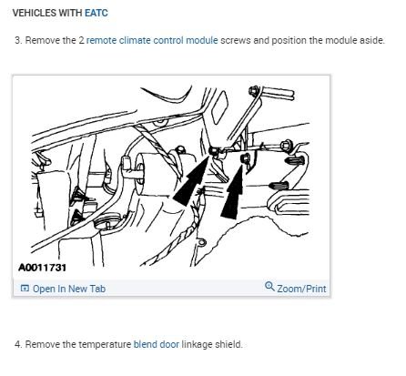

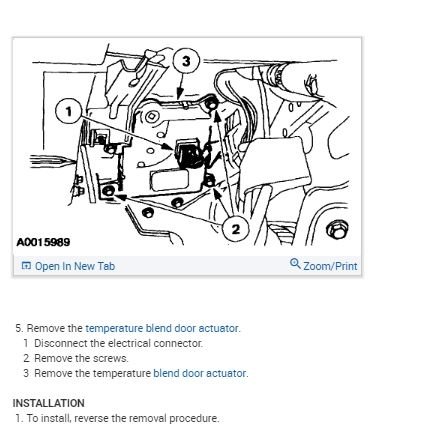

Heres a guide on replacing a blend door actuator. Not vehicle specific, but it will give you an idea of whats involved
Attached below you will find the diagrams to replace the blend door actuator fro your vehicle
