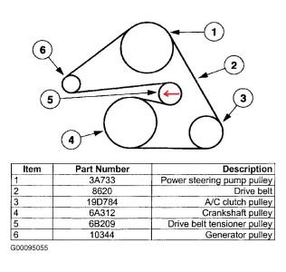

how do u change the fan belt

Pull belt tensioner away from the belt
