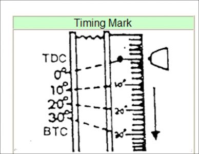

If it were me, I would remove the right valve cover - pull all the plugs - put a long thin piece of something sturdy so it doesn't brake off inside, into #1 plug hole and let it sit on top of the piston. Someone should kind of hold it steady so it doesn't rub the side of the piston wall. Then slowly rotate the engine to where it shows TDC.
https://www.2carpros.com/forum/automotive_pictures/248015_Timing_3_2.jpg
Then make sure your distributor is on #1. I have had to cut the side of mine before just to see if it is lined up correctly. Of course that means a new cap but that is okay. If rotor is not lined up exactly to number one, keep pulling it out and moving to the next tooth. One tooth off is not good enough.
https://www.2carpros.com/forum/automotive_pictures/248015_Timeing_1_2.gif
Then do your timing light and I show 10 degrees timing. . ...is that what you show?
Let's get it running then figure out why it dies with a quick throttle input. Sound okay to you?

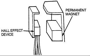

Well okay. . ...more progress. . ...may not be the exact direction we were expecting. . ..but we have progress.
I didn't see any relation to 1,2, or 5. . ...so now who knows, with none of them firing that may be easier.
This black thingy. . ...is this what it looked like?
https://www.2carpros.com/forum/automotive_pictures/248015_2_51.gif
I wouldn't go for the distributor out of the junk yard yet. . ...
Again, is the pic what you scraped off of?

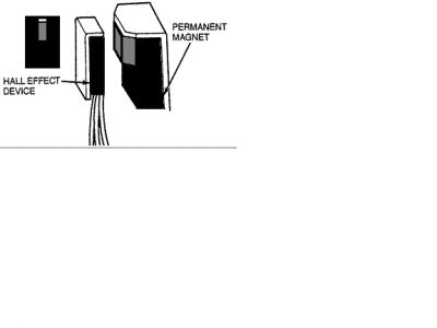

i attached a modification to your picture, the one we have looks more like the one i crosly drew. it parts are all black composite and the grey on the left is a magnet. On the right it is shaped more like a rectangle made of composite material, with the not grey little area at the top appearing to be metal or a magnet. i noticed the general "idea" of the picture you posted and the one i modifiied the concept is the same. the outer part on the left of the pict with the wires is on the outer edge of the distributor and the bigger one is toward the center of the distibutor.
What's your thought's?

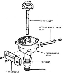

My thoughts... You cleaned off the Hall Effect Pick up. The Profile Ignition Pickup (PIP) signal is created in the Hall Effect and Stator assembly and indicates crankshaft position and engine rpm. The PIP signal is fed to both the Thick Film Integrated (TFI-IV) module and the Electronic Control Assembly (ECA).
Now - see what you think... It some were working before and now nothing and the only thing you did was on this... My thought; replace the pick up coil.....
Well, do you feel up to taking the distributor apart? Verify, but from what I see Auto Zone has the Hall Effect Pick Up for about $20 beans.....
I have attached info on replacing it.......
I don't like, this is me, others have their own thoughts.....I don't like getting electrical parts from the junk yards... You don't know the history...A non electrical part... Say.....A seat... You can look at it, touch it see if it works....... Not an electrical part.
What to you think....... Maybe the Hall Effect?

REMOVAL
NOTE: Do not replace stator without an arbor press.
Use a screwdriver to remove distributor cap. Position cap and wires to prevent interference with work area. Remove distributor harness connector.
Remove distributor from block, then remove rotor. Next, hold gear to loosen armature screws (Do not hold armature). Finally, remove armature.
Mark armature and gear to note orientation with felt tip pen. Remove and discard pin in gear.
Invert distributor and place in Axle Bearing/Seal Plate T75L-1165-B or equivalent, and press off gear using Bearing removal tool D84L-950-A or equivalent.
Deburr and polish shaft with emery paper and clean cloth so shaft slides out freely from distributor base.
Remove shaft assembly, stator assembly screws, and stator assembly.
Inspect base bushing for wear or signs of excess heat. Replace distributor assembly if damaged.
Inspect base and O-ring for cuts, cracks, wear or damage. Replace if necessary.
INSTALLATION
Place stator assembly over bushing and press down to seat.
Place stator connector in position. Fit tab in notch on base and align fastening eyelets with screw holes. NOTE: Prevent wires from interfering with moving parts.
Install and tighten stator screws 15-35 lb-in.
Apply a light coat of engine oil to distributor shaft below armature and insert shaft through base bushing. Place a 1/2 inch deep well socket over shaft, invert and place on arbor plate.
Place distributor gear on shaft end. Line up the mark on armature and gear. To ensure ease of roll pin insertion, the hole in the shaft and gear must be lined up as accurately as possible.
Place a 5/8 inch deep well socket over the shaft and gear and press gear to align with original drill hole. If the gear holes do not align, the gear must be removed and repressed. A drift punch will not align the holes.
Insert new roll pin through gear and shaft (Ensure pin has proper extrusion). Replace armature and tighten screws to 25-35 lb-in.
Check distributor for free movement over full rotation of shaft. If armature contacts the stator, replace the entire distributor.
Install distributor into block and connect module to wiring harness. Replace rotor, cap and screws, and set engine timing.

i replaced the Pick up coil per your recommendation and instructions. Gave thanks to God for the car repair, started car and brought car up to temp, checked timing, was about 12 degrees, set it to 10, tightend distributor nut, shut car off. Pluged back in the little grey connector (not sure what it is called) but I know you have to unplug it to set the timing. Toped off radiator fluid, changed oil and filter, then took father-in-law for a ride 2 mile ride.

Once you plugged the shorting plug or the single wire in-line Spark Output (SPOUT) connecter near the distributor, when you would increase the RPM, the timing did advance a little didn't it?

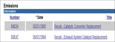

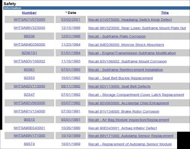

Okay - one other thing to check on. Looks like you may have some recalls on your vehicle. The dealer may fix these for free. Please contact the dealer service department, give them the VIN number of your car and have them check on these to see if they apply to you. I put those at the bottom for you to refer to.
Well, let me know any updates on the above - and this will be closed.

I am not sure if the timming advanced some after I plugged in the spout connector. I just followed the timing steps per the hanes manual. Should I re-check the timing to see what is, what should it be after the spout connector is plugged in?

As for the timing advance. . ..you can look at it with the light. It should be 10 degrees like you set it. . ..then with a little throttle it should move up a little showing the advance is working.
My only thought there is the "dieseling" as you describe. . .that is timing. . .so there the advance and on the side of the distributor is the octane adjustment rod. So just things going through my head.

i did read about the octane rod in the hanes manual. Well so much for being detailed. Lol I have been so happy with the car running I overlooked what that thing does, is there an adjustment?

I have attached info on the rod. . ...I wouldn't replace it right away. . ...nothing really changed with the car other than replacing the head gasket. So I would wait just a little bit. Run a couple of tanks of fuel through. . ...put some of that BG-44K in a couple and see how it does.

The octane rod adds a provision for a fixed octane adjustment. The adjustment is done by replacing the standard zero-degree rod located in the distributor bowl with a three degree or six degree retard rod. This is done only if the engine is experiencing a pinging or engine knocking condition and can not be repaired with the conventional methods (timing adjusted, proper operating temperature, higher gasoline octane rating....etc).
