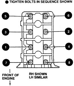

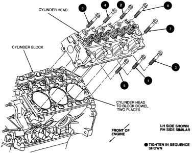

I HAVE A BLOWN HEAD GASKET AND NEED HELP KNOWING ABOUT THE TOUQUE ON HEAD BOLTS.
Jan 24, 2009 at 9:09 PM
BLUELIGHTNIN6
  • 16,542 POSTS
FOR 3.0L OHV ENGINES: First pass: tighten the cylinder head bolts in the sequence illustrated to 52-66 ft. lbs. (70-90 Nm), then back off the bolts 360 degrees. Second pass: tighten the cylinder head bolts in the sequence illustrated to 45-55 ft. lbs. (34-40 Nm). Final pass: tighten the cylinder head bolts in the sequence illustrated to 63-73 ft. lbs. (85-99 Nm).
https://images.2carpros.com/forum/automotive_pictures/261618_0900c1528003a912_1.jpg
FOR 3.0L DOHC ENGINES: Tighten the bolts, in sequence, to 28-31 ft. lbs. (37-43 Nm) Rotate the bolts, in sequence, 85-95 degrees Loosen the bolts, in sequence, a minimum of one full turn Tighten the bolts, in sequence, to 28-31 ft. lbs. (37-43 Nm) Rotate the bolts, in sequence, 85-95 degrees Rotate the bolts, in sequence, an additional 85-95 degrees
https://images.2carpros.com/forum/automotive_pictures/261618_0900c1528003a912_2.jpg
