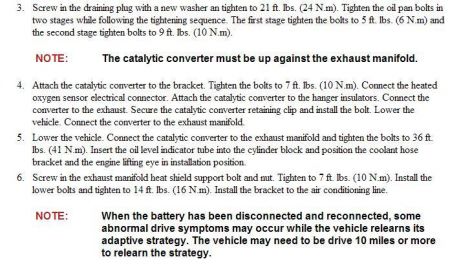

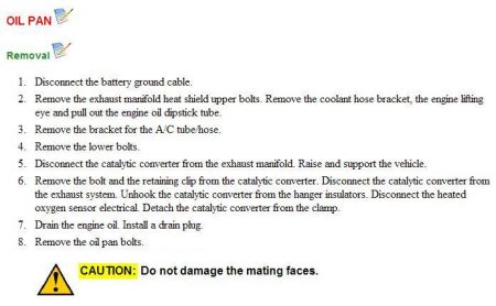

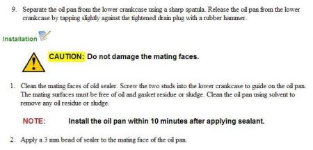

What needs to be done to change theoil pan ;does exhaust have to be removed?Does oil sump have to be removed?
