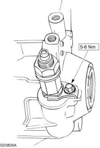

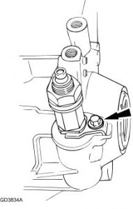

Just had another issue where the rpm's and speedometer would just rocket up there. Went to advanced auto and they said it was a code for a bad speed sensor. Forgot to get the code number but will get it if you need it.
Should I go ahead and replace the speed sensor? Been trying to find out how to find the speed sensor in the car, but unsure on where it would be. Is it a pretty simple thing to repace the speed sensor? Just wondering on the location of it?
Sunday, October 24th, 2010 AT 5:35 PM
BMRFIXIT
  • 19,053 POSTS
Codes should help for sure
this is what i have on speed sensor
Vehicle Speed Sensor (VSS)
Material MERCON Â Multi-purpose automatic transmission fluid MERCON Â XT-2-QDX
Removal
Raise and support the vehicle. .
Remove the vehicle speed sensor (VSS) cable.
Disconnect the VSS electrical connector.
Remove the VSS bolt and the VSS.
Remove driven gear.
Remove driven gear retainer.
Inspect the speedometer driven gear retainer O-ring seal for nicks and cuts, install a new as necessary.
Installation
Install the driven gear.
Coat the driven gear bore with Motorcraft MERCON Â Multi-purpose automatic transmission fluid or equivalent meeting MERCON Â specification.
To install, reverse the removal procedure.
https://www.2carpros.com/forum/automotive_pictures/99387_2_20.jpg
https://www.2carpros.com/forum/automotive_pictures/99387_5_4.jpg
https://www.2carpros.com/forum/automotive_pictures/99387_6_3.jpg
