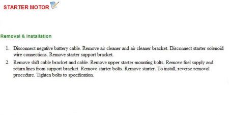

Where do I find my starter on my car and how do I remove it?

You can just follow the positive battery cable through engine compartment, it leads straight to the starter.
