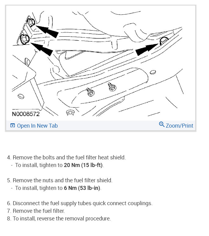

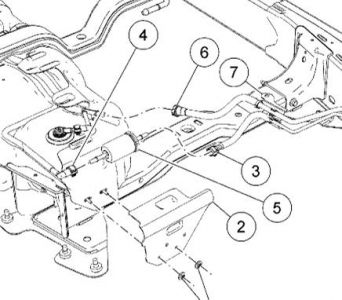

Fuel filter is under vehicle on fuel rail, next to frame. You need FORD special fuel line service tool to release the fuel filter and replace it.
Here is a video that shows how
https://youtu.be/Boi0DPXVHbM
Here are some instructions in the diagrams below to show you how on your car.
+2
Tuesday, October 26th, 2010 AT 9:09 PM
BLUELIGHTNIN6
  • 16,542 POSTS

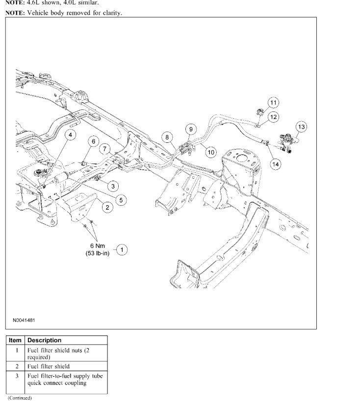

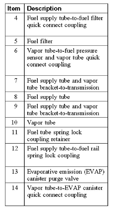

Fuel filter is on the leading edge of fuel tank on right side of vehicle, mounted behind the fuel filter shield
+3
Monday, August 12th, 2019 AT 5:33 PM (Merged)
  • 75,992 POSTS
Fuel filter is location at #5 on diagram below.
https://www.2carpros.com/forum/automotive_pictures/12900_ff_4.jpg

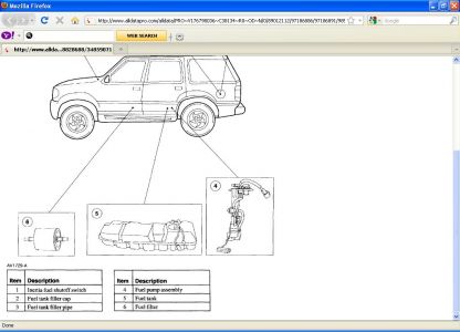

https://www.2carpros.com/forum/automotive_pictures/416332_2003_mercury_mountian_fuel_filter_1.jpg
First of all thank you so much for your donation.If you have the gasoline engine that's where it is on the frame rail.

Just a guess but I bet it is going to be under the vehicle bolted to the frame. If it is not there just follow the fuel lines either back from the fuel rail or forward from the fuel tank.

Usually it's mounted not far from the tank on a frame rail. 2 hoses held in place by 2 plastic clips. Pull the clips out and the lines come right off! Relieve the line pressure first!

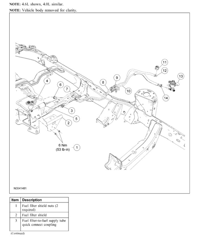

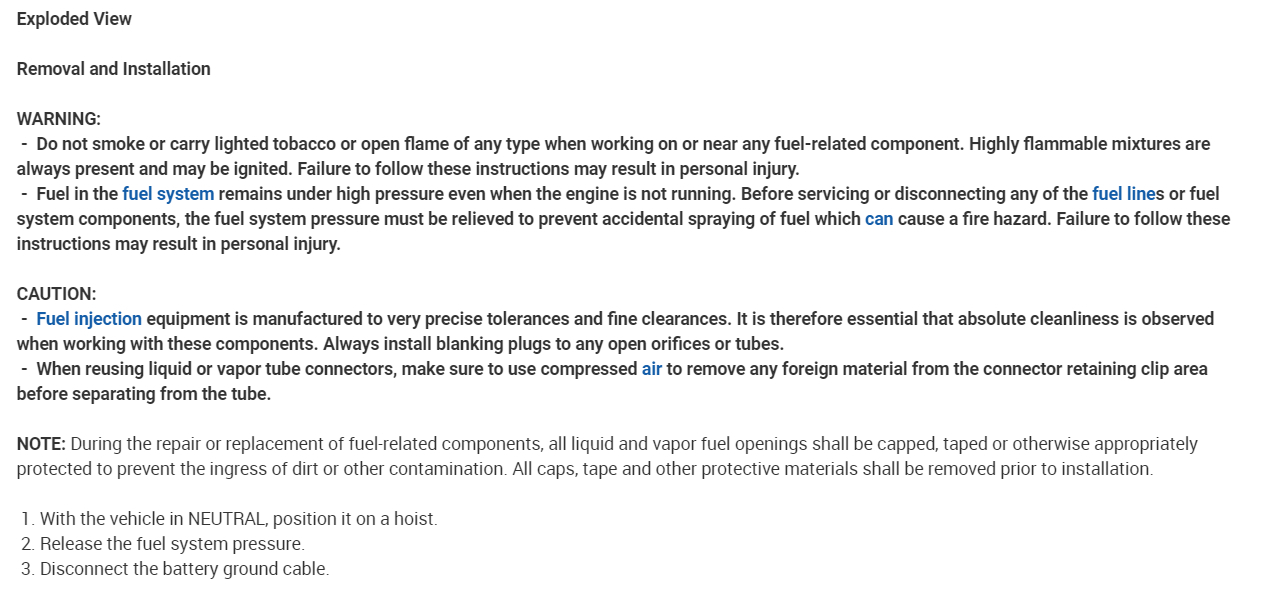

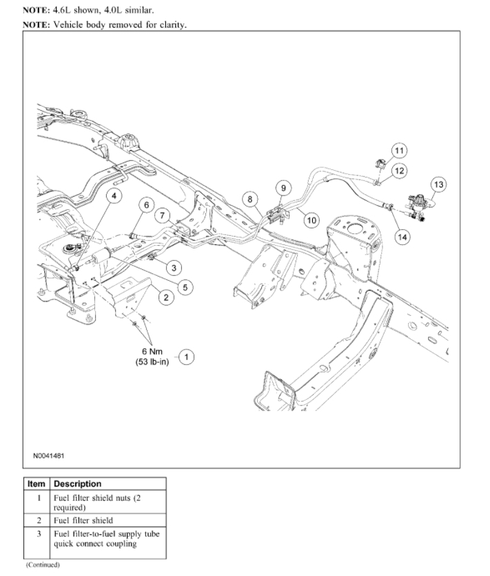

MERLIN2021
  • 17,250 POSTS
The MAF at air filter can cause this too, is your check engine light(MIL) on? Here is the fuel filter location so you can change it out (diagrams below). You will need to watch this video on how to get the fuel line off the filter also go over this guide as well.
https://www.2carpros.com/articles/how-to-change-a-fuel-filter
and
Check out the diagrams (Below). Please let us know what you find. We are interested to see what it is.
