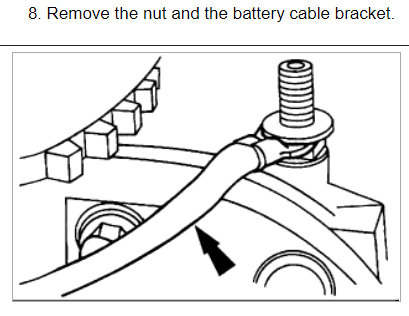

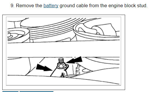

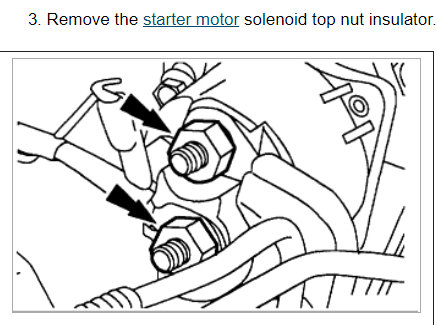

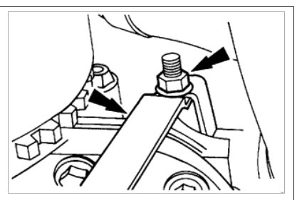

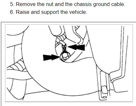

Have a 1997 mercury mountaineer will turn over but turns over slow. And will not crank. We replaced the battery, we had the alternator and starter checked and they are good. Replaced the fuse under steering column. Still cranks slow and will not start. Please help
Tuesday, December 26th, 2017 AT 10:09 AM
KEN L
  • MASTER CERTIFIED MECHANIC
  • 55,281 POSTS

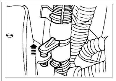

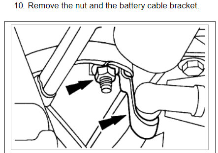

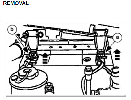

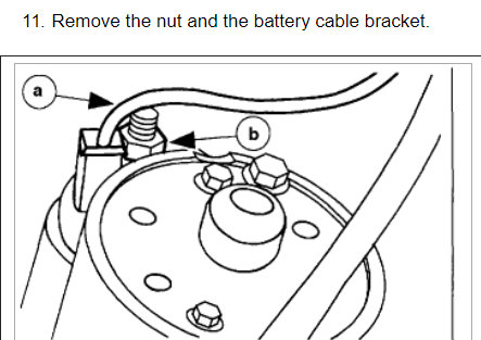

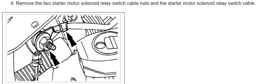

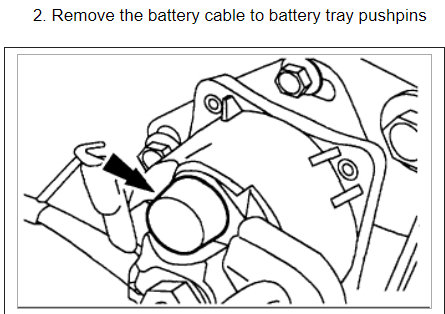

This sounds like you have high resistance in the battery cables not allowing the starter to pull full voltage. I would replace the positive battery cable to start. Is there a chance you can shoot a quick video of what the car is doing with your phone and upload it here?
That way I can tell for sure. I would also replace the starter solenoid as well. Here are disgarms for you to see how to do the job on your car (below)
