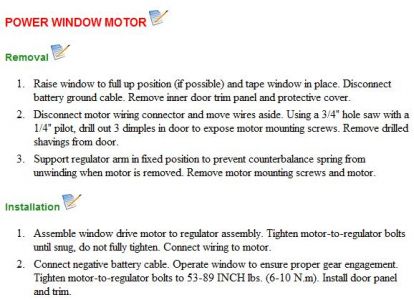

How do you replace the power window motor on my 1997 mercury cougar? I believe it is attached to the window regulator which is spring loaded. So what is the correct way of replacing it.

Proper replacement steps are below..
https://www.2carpros.com/forum/automotive_pictures/261618_Noname_2428.jpg
