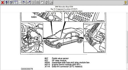

Hi dw_gardner, Welcome to 2carpros
If there is no power reaching the red and green wire at the fuel pump connector-check fuse no.6 25amp in the rear fuse box below right rear seat, if fuse is okay test the fuel pump relay module under rear seat-See Pic K 27. If okay test the polarity protection relay at right rear of engine compartment, last place will be the computer controlled of the fuel pump.
https://www.2carpros.com/forum/automotive_pictures/12900_k27_1.jpg

DW_GARDNER
I have checked the fuse and replaced the k27 FP relay. The picture you posted did not show the polarity protection relay very well or the computer controller. With it doing the same thing over and over and nothing different that would seem to be like a relay more than a solid state controller? I always thought a computer controller would work or not work. It just seems like it runs for the exact same amount of time then dies, like its on a timer.

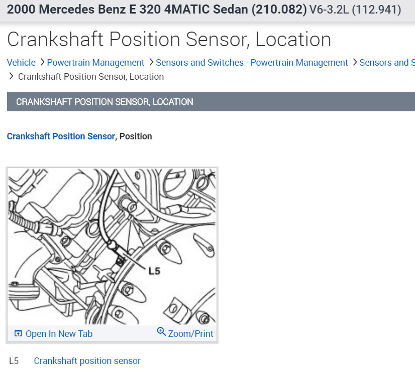

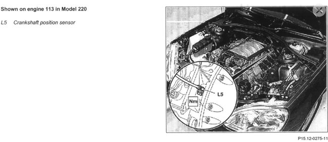

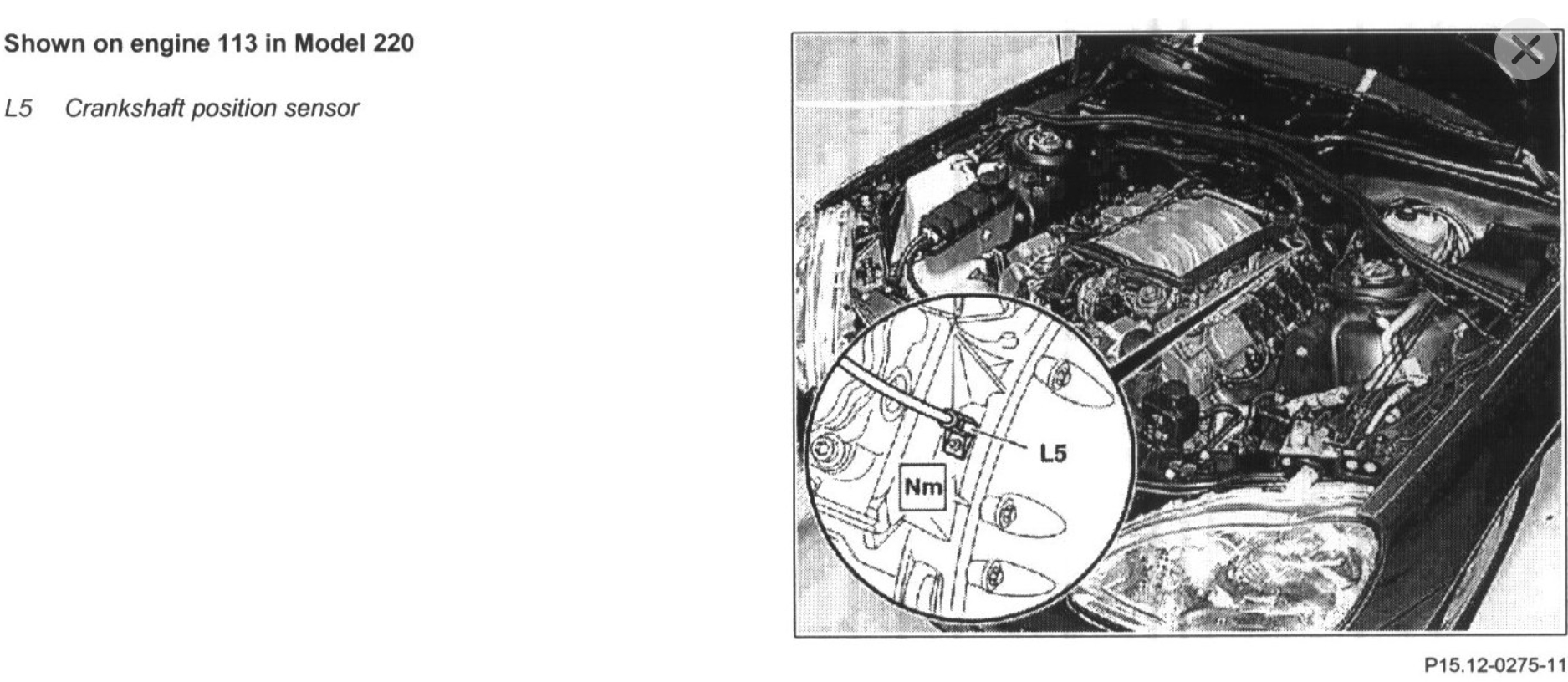

KEN L
  • MASTER CERTIFIED MECHANIC
  • 55,535 POSTS
Yep, this sounds like a classic crankshaft angle sensor which when they go bad they do not set a code. Here is the location so you can change it out. Check out the diagrams (below). Please let us know what happens.
+1
Thursday, August 1st, 2019 AT 10:32 AM
CORTEZ22
Hey Ken sorry for responding so late but that exactly what it was the Crankshaft Position Sensor it was pretty easy to replace if you using the right E-8 socket thanks again for your help.
