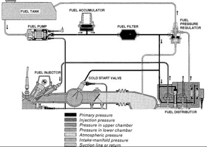

1990 Mercedes Benz 190e 6 cyl Two Wheel Drive Automatic 300K miles
I HAVE A 1990 2.6 LTR GAS 190E I'VE REPLACED THE OVP / CAM SENSOR / DISTRIBUTOR / FUEL REGUALTOR / THE CAR STARTS WITH MANUAL PRIMING AND WILL RUN IF THE RPMS ARE KEPT HIGH. IT SEEMS TO STARVE ITSELF FOR FUEL AND STALLS OUT.
THERE IS A VACUUM HOSE COMING OFF A SOLENOID ON THE RIGHT SIDE OF THE FUEL REGULATOR THAT I CANNOT FIND THE LOCATION FOR. THE HOSE HAS A HARD PLASTIC HOSE STICKING OUT. I'M NOT SURE IF THIS IS RELATED TO THE PROBLEM OR NOT.
ANY IDEAS?

Hello
I have attached where each hose goes from the regulator. This should help you out there. Next, you need to check the pressure on your fuel pump. It sounds like it is that to me with that many miles. If you do replace it change your fuel relay also.
https://www.2carpros.com/forum/automotive_pictures/248015_1_55.jpg

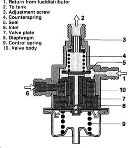

The primary-pressure regulator maintains fuel supply pressure to the fuel distributor and injection valves.
The control pressure must be held constant, even when fuel delivery from the supply pump, and injected fuel quantity, vary considerably. This is due to the fact that any variation of the control pressure has a direct effect upon the air-fuel ratio.
Fuel enters on the left; on the right is the return fuel connection from the fuel distributor. The return line to the tank is connected at the top. When the fuel pump starts, fuel pressure forces the control diaphragm downward. The pressure of the counterspring forces the valve body to follow the diaphragm until, after a short distance, it comes up against a stop and the pressure-control function begins.
https://www.2carpros.com/forum/automotive_pictures/248015_2_36.jpg
Fuel returning from the fuel distributor now flows back through the open valve seat to the tank along with excess fuel from the control system. When the engine is switched (OFF), fuel pump operation stops and the system pressure drops. As a result, the plate valve moves back up again and pushes the valve body upward against the force of the counterspring until the seal closes the return to the tank. The pressure in the system then sinks rapidly to below the injection-valve opening pressure with the result that the valves then close. The system pressure then increases again to the value determined by the force of the fuel accumulator spring.
