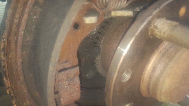

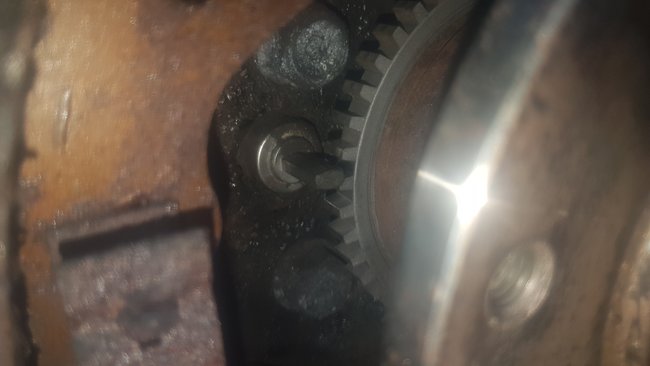

I used a full 500 ml can of brake cleaner for the inside of the drums, springs, reluctor wheel and everything in between, on both sides while cleaning - there may be residual brake dust again since I have been driving, but aside from that I would say I was very thorough on that day (even the brake shoes got a bit of sandpaper). :)
adding a before and after photo, of the rear left sensor (the good one).
A sensor doesn't cost a whole lot, thankfully, but before I can replace it and give another update, i'll need to have the remaining piece of the bolt extracted, which keeps the sensor in place on the rear right (it broke, bleh!).
