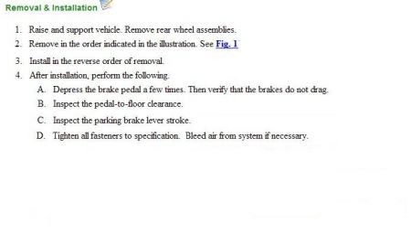

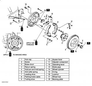

After removing the wheel and 2 phillips screws I am still unable to remove the brake drum. It does spin freely.
What more do I need to do to remove the drum?
