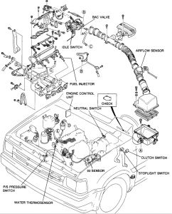

I cannot find my computer connector for a code scanner, I look everywhere under the dash no success. Also im trying to locate my crank sensor on the engine cannot find it! Please help me. Because my truck stall when running on the highway or while I stop at a corner. But then restart easily sometime it dos not start at all so please I need help to find it.
Saturday, August 21st, 2010 AT 7:05 AM
16 Replies
  • 75,992 POSTS
Test Connector
https://www.2carpros.com/forum/automotive_pictures/12900_d_2.gif
https://www.2carpros.com/forum/automotive_pictures/12900_ecu_10.jpg
The Test Connector is a green, one pin connector located in the engine compartment. When grounded, the test connector activates the self-diagnostic system and causes the dash mounted "CHECK" light to flash malfunction codes (California vehicles only).
Test connector signal can be checked at ECU terminal 1E. When ignition is switched "ON," MIL lamp should light for three seconds with terminal voltage reading below 2.5V. After three seconds, the MIL lamp should go out with terminal voltage now reading approximately 12V.
Crank angle sensor is part of the distributor assembly.

  • 75,992 POSTS
B-Series
1987-88On Right Front Fender Apron
1989-93
Engine Control Check Connector (Black 6-Pin)Near Windshield Washer Motor
Trouble Codes Connector (Green 1-Pin)Near Black 6-Pin Connector (Engine Control)
1994-95On Right Front Fender Panel

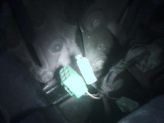

BILLMILL5050
  • 66 POSTS
Thanks but how do I jump ground and tens pin? What is tens pin? Do I jump green 1 to ground. The green 6 plug has 3 wires 1-yellow 2-blue and black and pin 5-yellow.1 plug green with red wire and 2pin yellow plug with 2 wires blue and black thanks
Friday, January 15th, 2021 AT 11:42 AM (Merged)
WRENCHTECH
  • 20,761 POSTS
The instructions stater there is a connector with a single green wire that you have to jump to ground.
WRENCHTECH
  • 20,761 POSTS
Correction. The wire isn't green, the connector is. I see it in your picture.
+2
