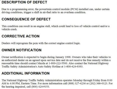

I found a recall for PCM reprogramming and do not know if it is applicable for your model. Maybe you can try calling your local Mazda dealer for some info.
https://www.2carpros.com/forum/automotive_pictures/192750_Recall98Mazda626PCM01_1.jpg
https://www.2carpros.com/forum/automotive_pictures/192750_Recall98Mazda626PCM02_1.jpg
The symptoms described is similar to what you are experiencing.

By looking at the recall, I don't believe it it applicable to my car, since it has been manufactured in july 1997 (though it is model year 1998) and European version. There were a tag on the PCM that is has been reprogrammed in December 1999. The mazda dealer (importer company) said that the PCM (Ford EEC-V) can not be reprogrammed, but they had the information also on their computer (didn't tell why reprogramming was done). They couldn't explain that.
