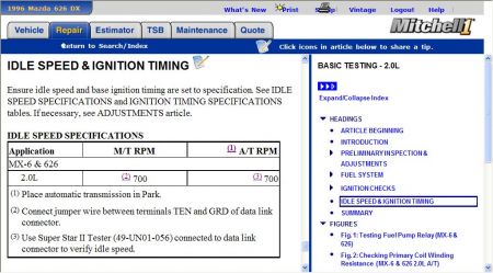

Car is idling low, base idle was reset at dealer about a year ago due to same problem, 5 min and 95 bucks, I read somewhere but can't remember where that it can be reset through the DLC by grounding a pin, if so which pin and where is the dlc on this car. Any help appreciated
Monday, March 24th, 2008 AT 11:42 PM
7 Replies
  • 75,992 POSTS

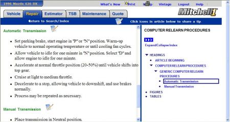

The DLC is on the drivers side near the power distribution box-jumper TEN and GND then adjust it see below-also do the computer relearn

The procedure you sent in your response for relearn drive is cut off for the manual transmission after the first line, can you include it please, also is the pin 10 grounding procedure done key on engine off.
Tuesday, March 25th, 2008 AT 11:18 PM
  • 75,992 POSTS
Yes its done with KOEO
https://www.2carpros.com/forum/automotive_pictures/12900_manual_tranny_1.jpg
