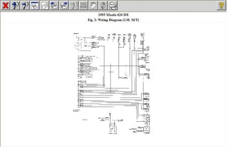

They have checked both the crankshaft and the cam sensors. They also used a direct lead from the battery to the fuel pump to try to start the car. This way the fuel pump operates but, No Go. Is it possible that some connecting plug on the wiring which is carrying voltage to both fuel pump and distributor could have been shocked loose by the bump? (Hence my request for diagrams hereunder).

Again test the main relay and fuse no.10-be advised you only have (1) fuel pump. Powering the fuel pump direct-if the fuel pump is good should come on.
Below is your electrical diagram
https://www.2carpros.com/forum/automotive_pictures/12900_diagram_2.jpg
