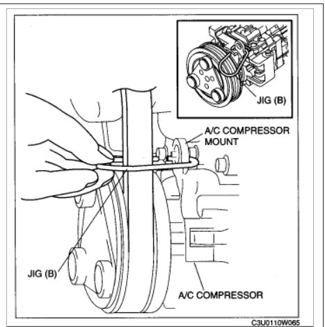

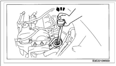

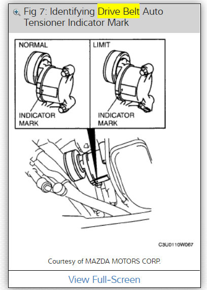

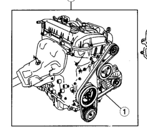

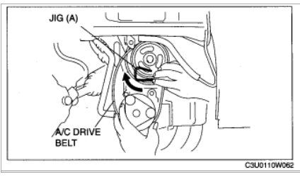

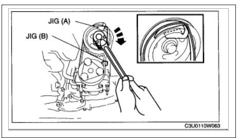

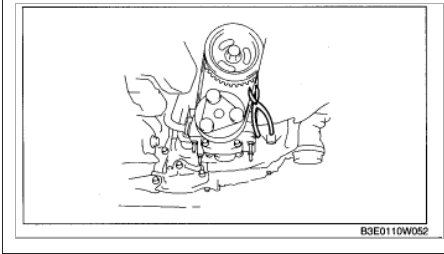

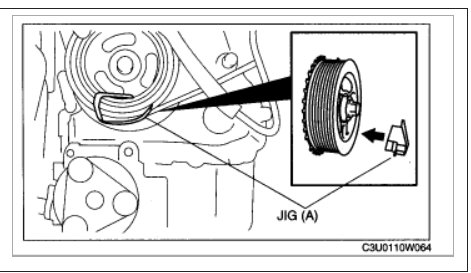

I am rebuilding a Mazda 3 with the 2.3 turbo and the drive belt was missing. There is no diagram (hood was missing) and I am about to go crazy trying to figure out how to route the belt. Thanks for any help possible!

Hello, here is what I found for you.
Cheers
