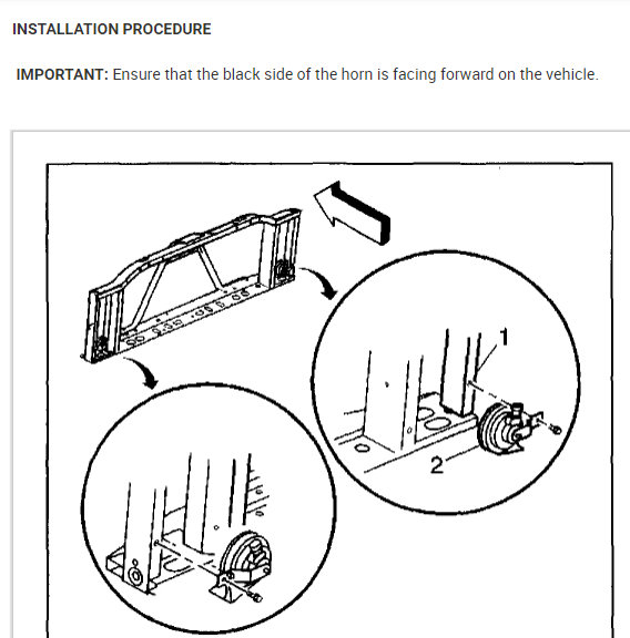

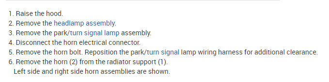

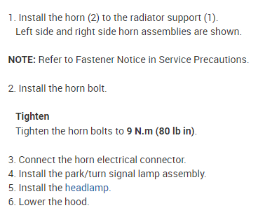

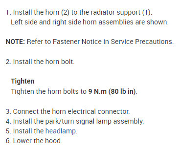

DANNY L
  • 5,648 POSTS
Hello, I'm Danny
Here is the information you requested. Here is a tutorial for you to view for wiring testing as well.
I've attached picture steps below showing the horn locations and replacement instructions. Hope this helps and thanks for using 2CarPros.

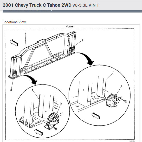

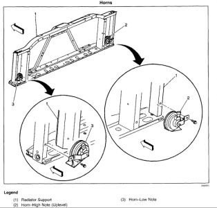

I have been told there are two horns on the tahoe. I have found one in front of the wheel well-passenger side. Where is the other? Also, if only one do I use a high tone or low tone?
Thursday, January 28th, 2021 AT 9:50 AM (Merged)

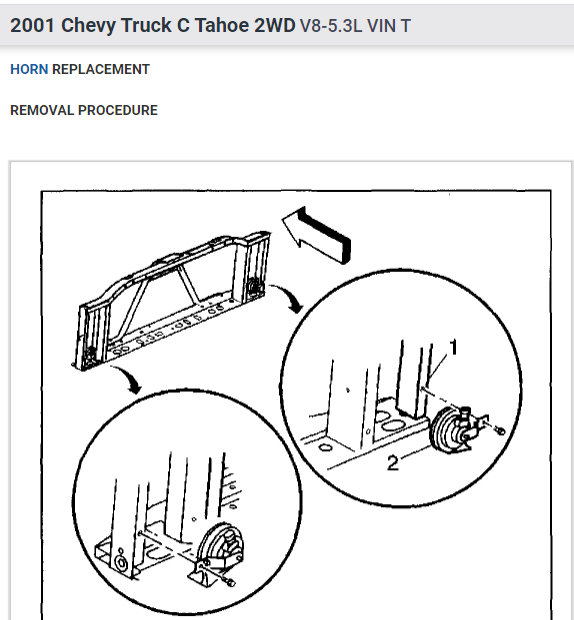

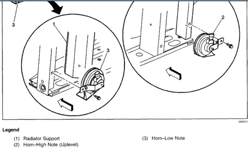

KEN L
  • MASTER CERTIFIED MECHANIC
  • 55,383 POSTS
There are two horn at the front of the frame rails on the opposite side of vehicle, similar location.
Here is a diagram to help you see.
https://www.2carpros.com/forum/automotive_pictures/261618_1_102.jpg

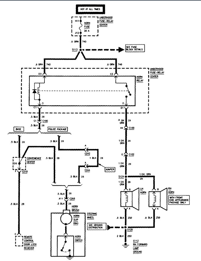

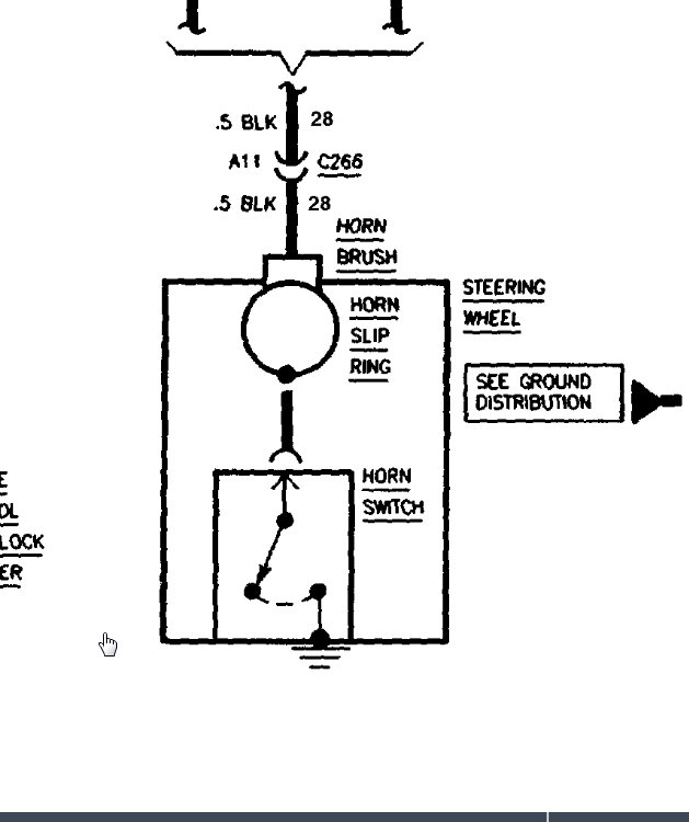

JDL
  • 16,098 POSTS
Welcome, your probably right about the problem being in the steering column, but, double check by honking the horn from the horn relay, if you haven't already.
https://www.2carpros.com/forum/automotive_pictures/170934_tahoe_horn_1.jpg
You can put a jumper between c3 and d1, the horn should honk like crazy. If it doesn't, the problem is elsewhere, not the steering column.
As far as the steering wheel, I'd disable the airbag first.

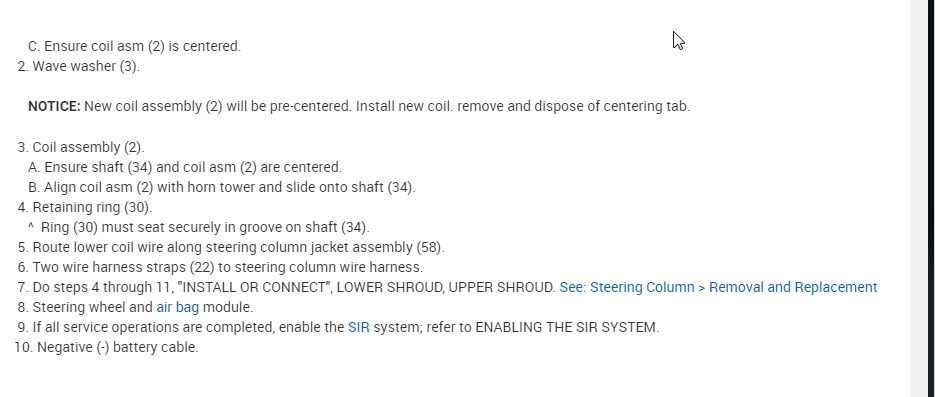

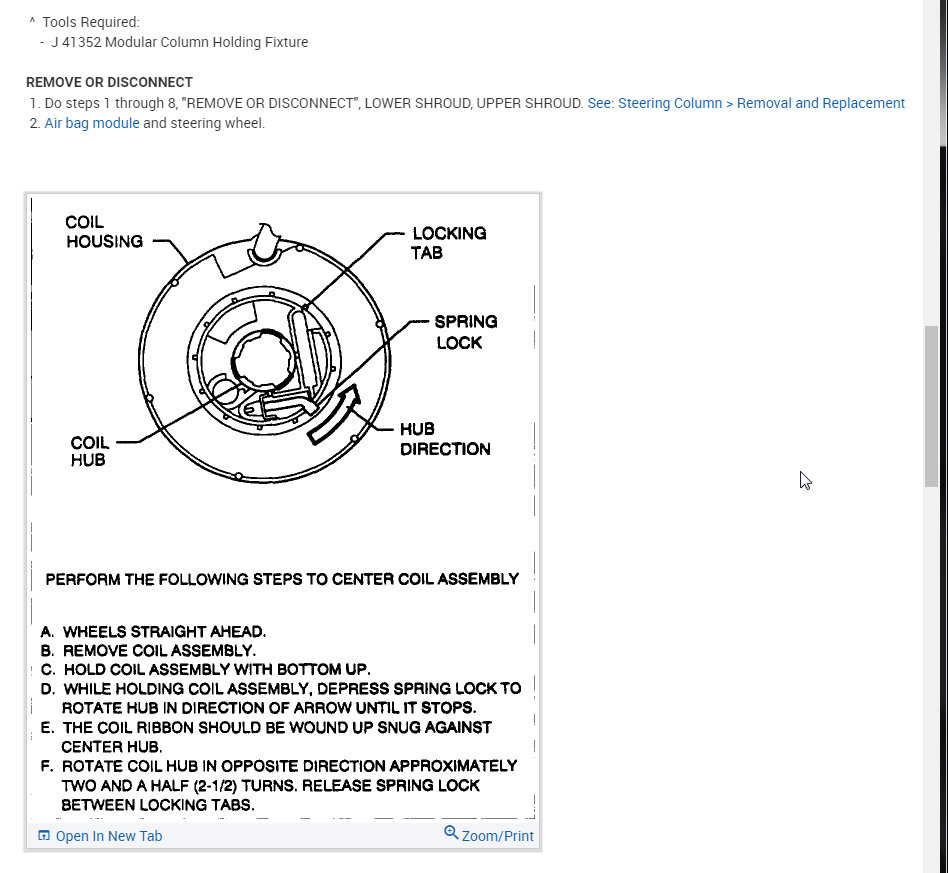

I hot wired at relay in fuse box and the horn will blow. I’ve removed steering wheel and airbag and the clock spring, not sure what the clock spring has to do with the horn blowing but other sites tell me it may need to be replaced.

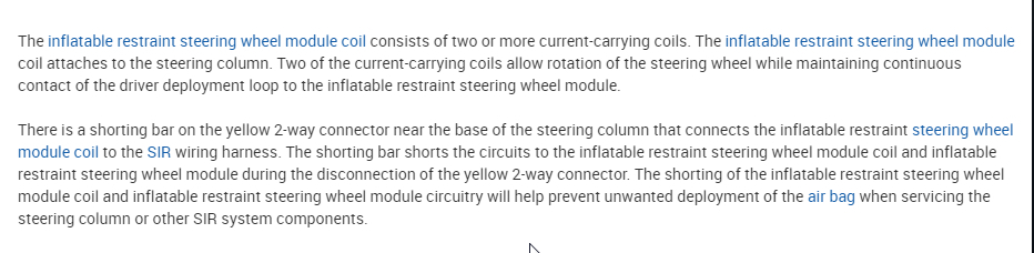

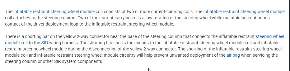

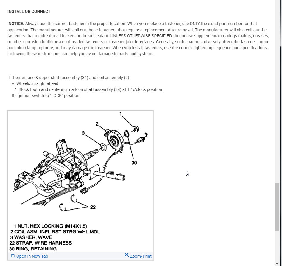

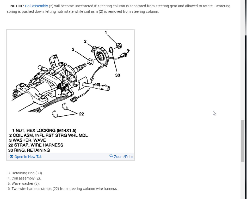

The clock spring is what allows the signal from you pressing the horn switch to go through the steering wheel to send the signal down to the horn itself. If you didn't have a clock spring then you would need wires to go through the column but when you turn the steering wheel those wires would get twisted up and cause an issue. So the clock-spring allows you to turn the wheel but the keep the electrical contact. Take a look at the wiring diagram and it gives a little more detail. They call it a Horn Slip Ring but this is part of the clock-spring.
Let me know if you have questions but I suspect this is your issue. I included the process of how to replace this if you have a tilt wheel. If you do not I can send you that process, just let me know. Thanks
